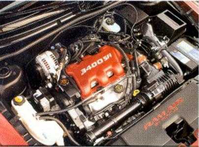

BBBadGT, ask terry, or if you know where it is... Look at a pic of a 3.4 supercharged deal that GM did with the grand am. They dont have a TB on the air inlet side, that goes to an airbox, and they have an adapter on the outlet that goes to about 2.25 or 2.5 inch pipe that goes to the TB. So my idea is possible.

Report this Post08-26-2000 07:58 AM Click Here to See the Profile for HYPTNOTiSEClick Here to visit HYPTNOTiSE's HomePageSend a Private Message to HYPTNOTiSEDirect Link to This Post
HYPTNOTiSE
504 posts
Member since May 2000
ALSO it looks like they're is a bypass valve connecting both sides of the supercharger, so that the boost can be bypassed into the air inlet and i guess it's recycled untill the valve see's a change in vacuume and closes the door to get boost.

I think it's a draw-through. I see a TB between the airbox and blower.

Bypasses are good on blowers, centrifugal type have bypasses that go between the outlet of the blower to the inlet (this is all after the mass air meter if equiped, because the air had already been metered). How it really comes into play is when you go full boost at say 6000 rpms under WOT, then suddenly take your foot off the accelerator but clutch still in (major deceleration), the blower is still is turning mega speed, but the TB plate is closed. This is very damaging to the blower itself, becuase all of the air being pushed by the blower hits the TB plate, and comes right back to the impler and tries to stop it, superheating the air in the meantime. I've seen implers just explode because of too much boost and and undersized bypass (lucky for that guy, all the parts were lodged in the intake). The bypass valve is only closed under zero vacuum.
On positive displacement blowers, the bypasses work the same, but its all after the TB. They really heat up the air more so than centrifugal type, and really benifit from a bypass.
Where's this photo at?

I keep getting an "Unknown Error 411" when I try to PIP it. Happens after I click "Post It".

From the Grand Am 3400 SC. Never see the light of day.

Magnusson/eaton is comming out with a supercharger kit for the 3.4 liter grand ams! Should be out this fall.
The setup is slightly different than the one shown. but same general idea.
