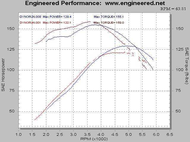

cool.. what nitrous metering jets are you using? the 30hp 132lbft jets i used were .042 and .046..

oh yeah there are many combonations to give you 50hp per cyl. it depends on comp ratio and A/F mixture the different metering jets can give you more than 50lbft but only show 15hp (p/cyl) https://www.fiero.nl/uploads/2m6dyno.jpg on of the run i did ... only 42hp but 77lbft... the most i ever layed down was 310lbft but only 202hp... WAAAAAAY more fuel than nitrous... Hey Hypnotise.. what jets are you running?

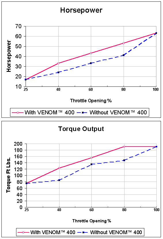

I was just told about the Venom PC programable NO2 system, Has any one used this system? it is from what I hear it is a brand new PC adjustible (10-175 hp) Dry kit. It is so new I have now idea if it is worth the time & money.

don't WASTE YOUR TIME!!! and your money!!! hehehehe the Venom "magic Black boxes" are just that.. useless black boxes.. Venom came to the shop TRYING to install their computer controlled nitrous system on the NOPI Focus ( www.nopi.com , www.engineered.net ) the engineeres at Venom worked on trying to get it to open the solenoids for 2 days.. and even then bad things happend.. all the venom electroncis aren't what they appear in the magazine.. save your money... if your looking for an upgrade for the nitrous setup go with www.nitrousworks.com www.nitrousexpress.com or the always working and easy to install www.nosnitrous.com stay away from magic black boxes! The shop even had the Venom sponcered Civic. with their other magic black boxes that runs $400 and is an electronic throttle cam which stops the car from running above 6200rpm (redlines at 7500) gets crappy gas mileage and is SLOWER than before.. the ZEX nitrous kit is a good idea but once again not worth the money.. www.zex.com not sure if you've heard of the KISS factor... Keep It Simple Stupid.. they are trying to reienvent the wheel.. and it's not working. and it's funny Venom doesn't use their own electronics in their race car... humm.. wonder why... i'm sure venom makes nice stuff but i'm not impressed by them.. and haven't seem ANY HP or TQ increase with their install
the Venom Civic that has been to the shop.. qite a few times

what do you see wrong with this "dyno" result? just to let you know how they are holding their hand out taking LOTS of money and not helping the performance enthusist (sp) the Vemon 400 available for import and domestic vehicles.. (our cars too) www.venom-performance.com i'm sure many of you don't care what a civc makes on the dyno.. but i've NEVER seen anything make 60hp and 195lbft of torque! (ok a Chevette diesel maybe) PLUS if you look at the area labled "throttle opening" who races at part throttle? at part throttle your crusing around town usually saving gas to get to the track, and is there a gain at full throttle over the stock application.. NO! I'm sorry for sounding brash but you'd think that the makers of these products would have a hard time sleeping selling these units for $400+ and KNOWING they don't help your performance. they do help in the deterioration of the cat. sense the engine is being over fueled and dumpin this raw fuel in to the cat. wasting gas. their nitrous computer works the same... on a percentage at that given % of throttle BUT the computer only has power to the solenoids at WOT... the same as everyone elses kits... I'd be hard pressed to deal with a company that will sell these products and be "proud" of them. sorry for the rant guys.. just don't want any of you to throw your money away.

yeah trav i noticed the same thing. 62hp and 190ft lbs! AHHAHAHHA what the heck is that? Oh it's on a honda, maybe them have the numbers backwards Yeah that's more like it. 1.8 vtec 170hp baby! "yeah how much torque you got?" "ugh, What's torque?"

Is it just me or do the charts show that the Venom 400 makes NO power OR torque at full throttle?

Travis, Ya' think those weak results coulda been the result of a fried clutch?

Aren't HP and torque always equal at 5252 RPM?
HYPTNOTiSE
Posts: 504
From: frederick, md 21702
Total ratings: 52
Report this Post08-16-2000 07:24 AM Click Here to See the Profile for HYPTNOTiSEClick Here to visit HYPTNOTiSE's HomePageSend a Private Message to HYPTNOTiSEDirect Link to This Post
yes phil they are. HP is a function of torque and speed. Someone correct me if i'm wrong but...
Torque x speed/5250 = HP
SO every dyno print out has to cross at 5250. that's where torque and hp are always, always, always equal.
Everything's correct except for the formula could be wrong, I'm not exactly positive, but it's along those lines.

WOW! yep your right Hypt... an example...
and YEAH either a bad clutch or he missed a shift! but as long as he has a fart can tip you'll still get the "Fly by" NO HP or TQ plus it stops the car from hitting it's redline, it cuts the fuel at 6500 and casues more problems than you could ever imagine. thier nitrous kit is the SAME thing.. lots of smoke and magic.. no results
[This message has been edited by Xtreme Fiero's (edited 08-15-2000).]
a VW TDI golf or bug?
why dont they show the RPM? Just the throttle angle, the test could be at 3000 rpm or 12,000 rpm I thik it's wierd that tey domy say or brag how much power the system makes.

yeah..VW TDI.. I said Chevette Diesel.. they are trying to mislead the people that MIGHT buy their product! by not showing rpm. i surely hope everyone here stays away from them.

as you can see it's weaker in the bottom end so the tires don't just ignite and chatter all the way down the track.. the high end is so much more cause the fuel enrichment is metered properly! not just by the little jets but by the "Chattering" of the solenoids. yeah it cuts their life expectancy but you have to sacrifice somthing for more HP an TQ... just as long as it's not the motor!
