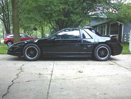

Report this Post07-14-2000 04:55 PM Click Here to See the Profile for StandardClick Here to visit Standard's HomePageSend a Private Message to StandardDirect Link to This Post
Those vents are a bad idea, because they're trying to force air in where it's supposed to be coming out.. and they look pretty bad imho..
Mike -- Golden Valley, MN
Black 86.5 GT 5 Spd, 147,000 miles and counting!
