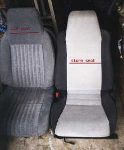

Hopefully I'll be getting some seats from a later model Z24 Cav soon. I'll post some pics when/if I get it done. (BTW, these are the seats that Eddie H. had if anyone remembers him. I've got a pic of one of the seats if I can find it.)
Ahh...Here it is. Supposed to be the seat on the left.
