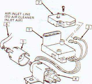

mwbackus
Posts: 608
Registered: Jun 99
Report this Post04-07-2000 12:23 PM Click Here to See the Profile for mwbackusSend a Private Message to mwbackusDirect Link to This Post
Referring to the illustration of the EGR solenoid below, the cylinder (ie.. filter) is labeled (5). If the filter (or air inlet line) is clogged, the vacuum applied to the EGR valve cannot be released properly (slow release can cause hesitation and idle problems).
Constant speed surging, that only appears after normal operating temperatures are achieved, is very likely caused by a vacuum leak in the solenoid itself or leaking EGR system vacuum line.
https://www.fiero.nl/uploads/EGRSolenoid.jpg
Mike B.
