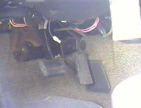

(Posted on behalf of Alberto Sanchez)

Oh, I forgot - Al mentioned it was under the dash.

It goes all the way to the other end.

Looks like the end of the Cruise Control lead. Should have four wires in it. The plug it fits into doesnt look like it would fit it.

Howabout a few more pics...maybe a shot or two from a distance? Im having trouble imagining where that wire might be under the dash.

first of all thanks cliff. ok this wire comes from inside the steering column, but i just don't see where it leads to. if you want another pic i will send it to cliff, unles ther is a way for me to post the pic by myself.so cliff can i do that?

I would have to agree with COOTER looks like cruise control wire connector. Couple weeks ago while upside down under the dash trying to figure out my elect problem (which I still haven't fixed) i saw something that looked similar and it was the cruise connector.

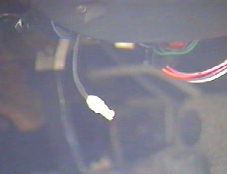

Here's another image:
(Posted on behalf of AL)

Ype thats the cruise lead

After having repaired/replaced the cruise control wiring on my 86 GT, I also agree - it's the cruise control connector. There are four wires going to this connector - two on one side and two on the other. This is an inexpensive connector technique - it's made of the same material that printed circuits are, with metalized traces. It mates to a plastic connector that will be found up beside the steering column (assuming that this vehicle has cruise control, and hasn't had a steering wheel/column transplant)

will i be able to see thi connector if i take the bottom out?,also how about a pic of this connector.

will i be able to see thi connector if i take the bottom out?,also how about a pic of this connector. or even a drawing of this connector would help.

It is the cruise control plug and the other plug should be under the dash. You just need to look for it.

ok guys thanks, i found the sucker. i trie it out but t doesn't work, i hear the relay kickin when i move the switch. so what could it be? the canister or the hoses or what?
