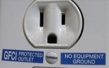

My home was wired in 1959. No grounded electrical outlets. How would I update safety ?

Do not jumper neutral to ground in the receptacle box or on the receptacle.
IF, you know for sure, which outlet in any given circuit is the most upstream outlet (the one from which all others in the SAME circuit is fed) then you only need to install a gfci in that box. Or, you can install a gfci BREAKER in the distribution panel feeding that circuit, but my experience with those things has been less than satisfactory.[This message has been edited by maryjane (edited 12-15-2023).]

I would use the old wire to pull thru some Romex or the flexible conduit, both two conductor to ground. Not particularly fun but it is doable. Doesn’t work with the old two wire with the ceramic holders as everything is screwed to the 2x4s..
