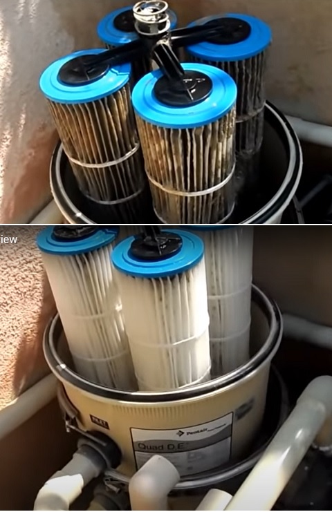

And, since there were 2 bags of pool filter sand in the storage building when I moved in, and the quad DE filter and it's multivalve look brand new, I much suspect the old original filter and valve both froze and ruptured in the 2021 big freeze and the previous owner had to replace the old sand filter with the newer style cartridge filter setup.
Not mine (screen shot from youtube) before and after cleaning cartridge type filters:
