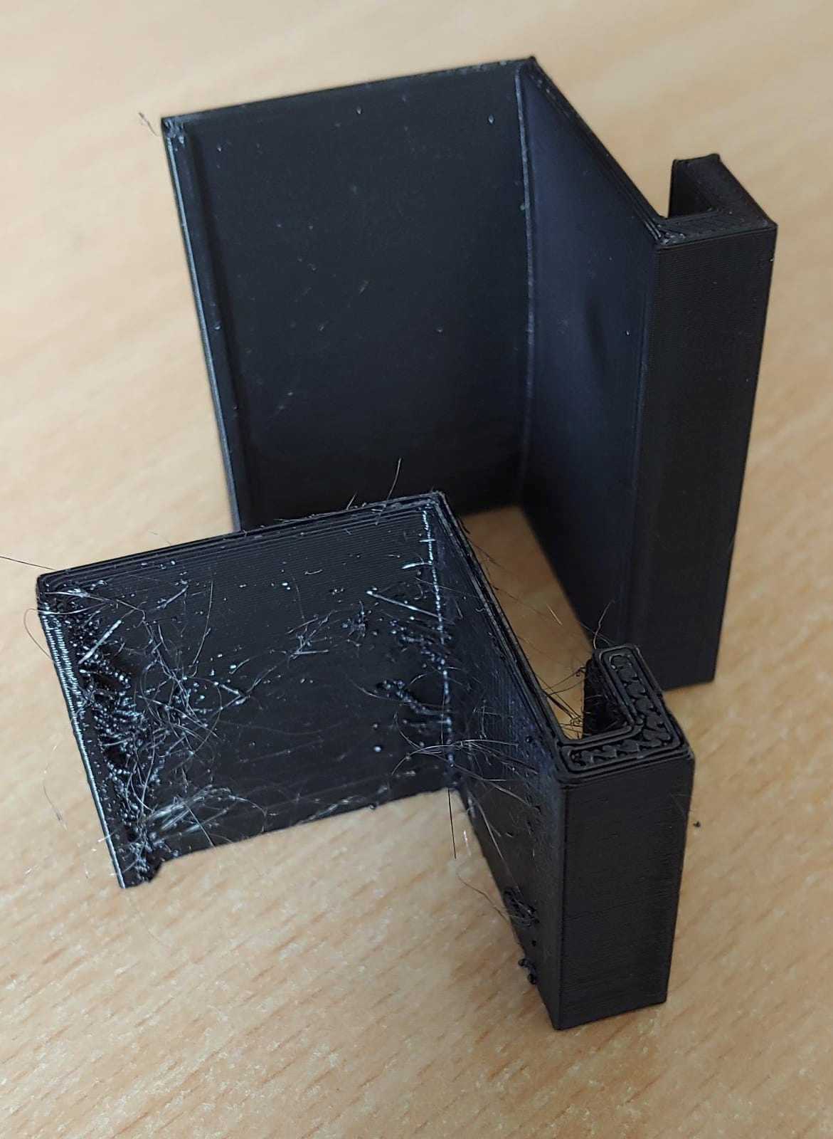

Just did two test prints with a 0.6mm nozzle (and PrusaSlicer 2.5.0 with Arachne). Print quality is terrible.
Here is the same print with a .6mm nozzle (which I interrupted because of the terrible quality) and a .4mm Nozzle. The 0.6mm is in front.
SEP 07, 01:47 PM
PETG ?
I always get stringing with that stuff no matter what I do. Heat gun and scrape with a utility blade fixes it quick  [This message has been edited by MidEngineManiac (edited 09-07-2022).]

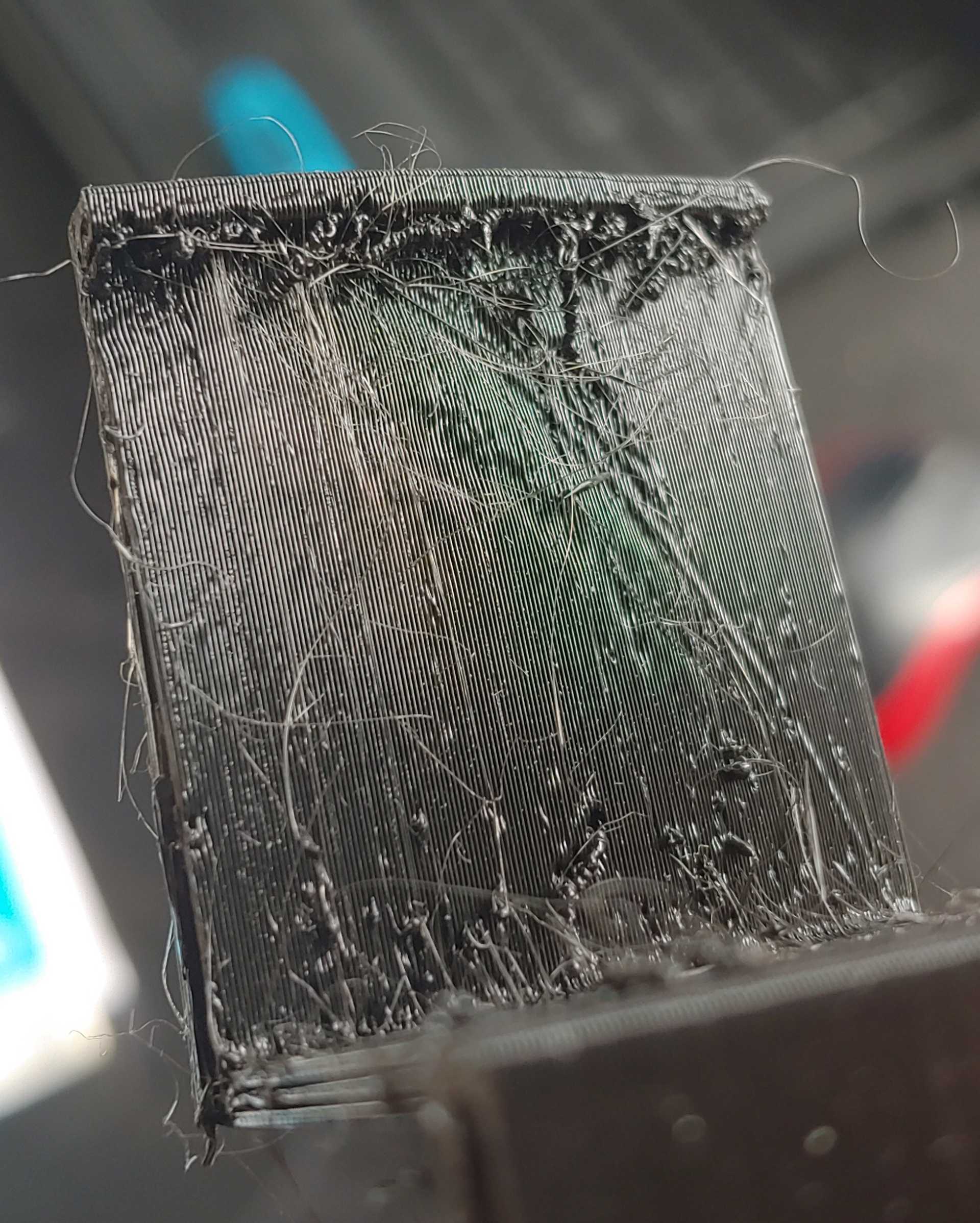

Yes, PETG. But it's not only stringing, it's also... whatever this is:
SEP 08, 09:13 AM
looks like a touch too cold. Maybe babystep the z .1 or so. Stuff is tricky, even ambient room temperature can screw with it. I notice a huge difference if I print it with the shop-room door open or closed and same settings otherwise. [This message has been edited by MidEngineManiac (edited 09-08-2022).]

My first picture above shows the same item printed with 0.6mm and 0.4mm, right after each other with the same PETG (and same room temperature, and nozzle temperature). The 0.4mm nozzle print is near perfect. The 0.6mm nozzle print... not so much.

you might want to dry your petg it looks a little wet.
