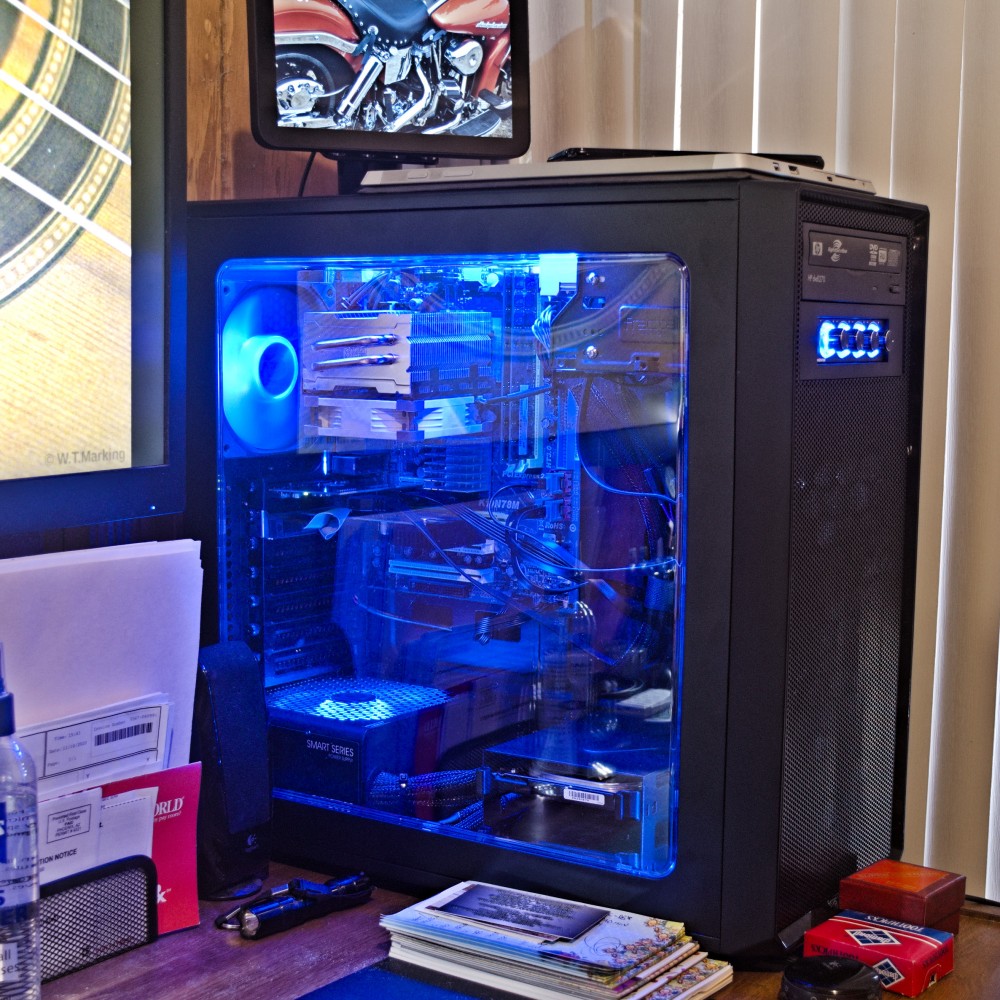

I was bored so I channeled my inner geek.
It was past time to upgrade my OS to Debian Bullseye, and I got carried away. It is still the same old machine with a new case, PSU, SSD, USB3 PCIe card and some LEDs. I don't play games so my old quad core Phenom II and 8 gigs of ram do everything I need.

Looks pretty fly, WillieGuy
JUN 10, 05:50 PM
Very nice, and GREAT job on hiding the flux capacitor !

I have been using Debian for over 20 years. For me it is the most stable, versatile, highly configurable , no BS distro. It also has the biggest list of available packages.
Most other "popular" distros are really Debian with one hand tired behind their back. They are designed for a specific purpose, either to do one task (Kali, AVLinux) or to be less intimidating (Ubuntu, Mint). Willie don't play dat.
| quote | 8GB getting you by?
Yeah, the heaviest things I run are GIMP and Ardour.
| quote | The SSD I'm guessing it is a SATA2 mobo?
Yes, Asrock K10N78M. I have two of them.
| quote | The M.2 are insane, but at that age you likely wouldn't notice.
Me or the MoBo?
| quote | I just added an SSD to a 2012 Dell laptop and with that and the RAM they were extremely happy. They could only run 8GB, but I put Win7 back on and that is typically adequate.
I had been wanting to try SSD and they are really cheap, nowadays. And like I said, I was bored. The biggest difference I noticed was in boot time and install time.

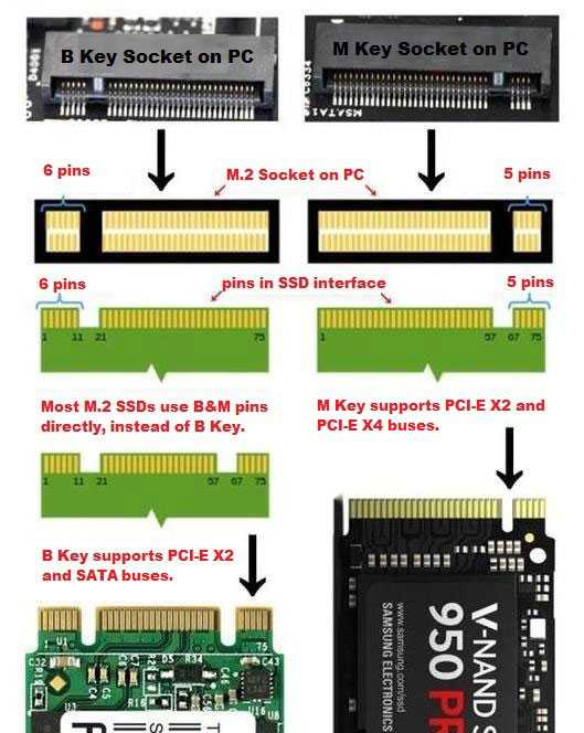

I added an M.2 to an old laptop that was using a spinning disk and almost unusable. I could not believe the difference, so I did the same with my desktop. Big difference between the SSD and the M.2 in performance and boot time. If your computer supports M.2 drives I would suggest using one.
A_Lonely_Potato
JUN 13, 01:54 PM
With yall talking about M.2, it should be said they are not equal. M.2 is just a physical connector. What is important is the communication protocol. You can get M.2 drives that still use the SATA III protocol, and will yield no benefit over a standard 2.5" SATA III SSD. You want to get an NVMe M.2 SSD. NVMe uses i believe 4 PCIe lanes, and is mind bogglingly faster than SATA. Both NVMe and SATA can be run on M.2 ports. Some M.2 ports only support SATA, but if it supports NVMe it likely supports both. Easiest way to tell if a drive is NVMe or SATA is by the connector, SATA has 2 gaps in the pins while NVMe only has one.
