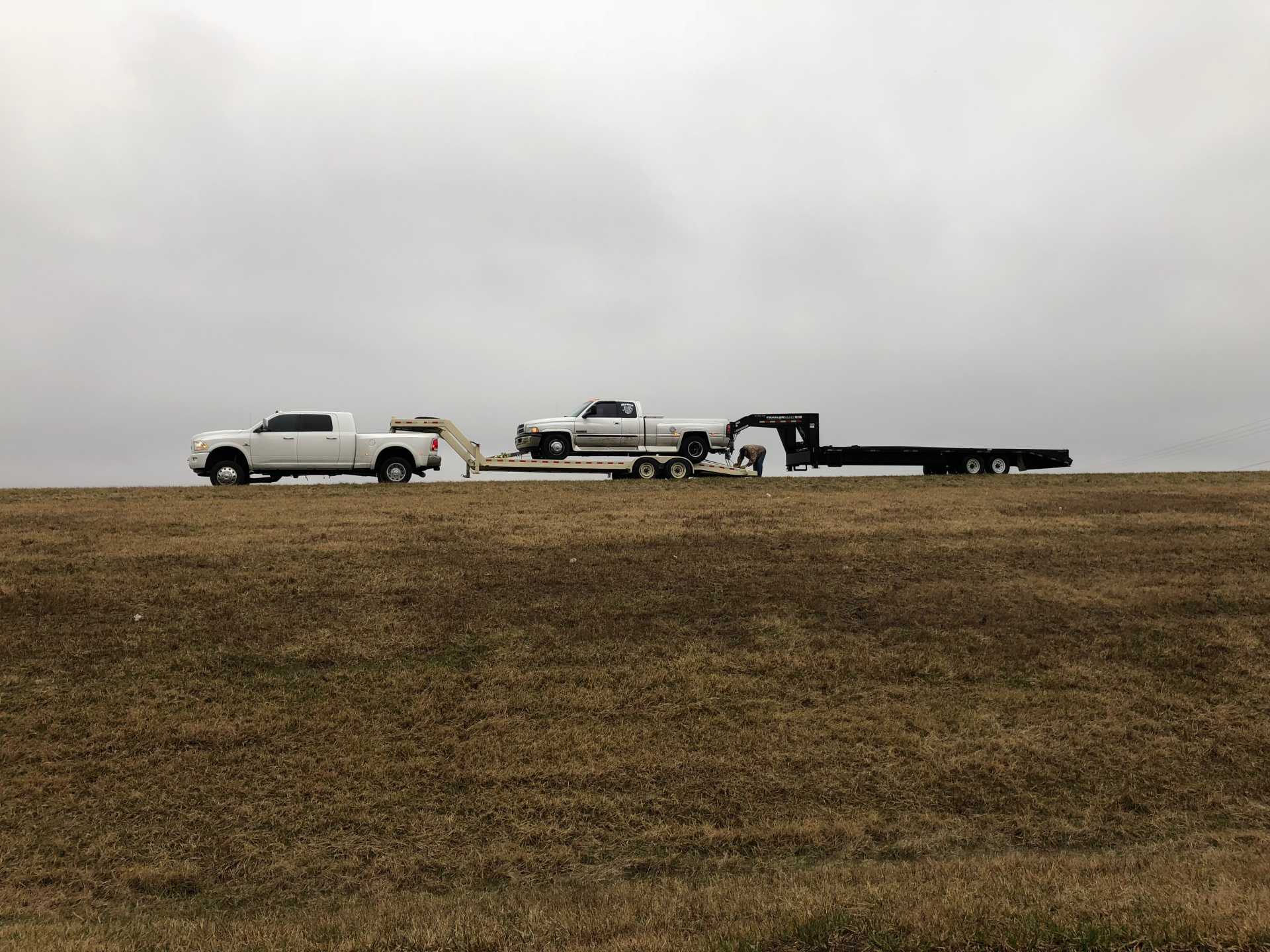

I've heard of it but never experienced it. My assumption is that if you run clean fuel, turbos have significantly less issues with gumming up. I learned a hard lesson several years ago about buying the cheaper fuels. The attached pic should explain why I no longer use Mom and Pop fuel stops unless I absolutely have to.

Willie, notice anything different about that pic?

The only obvious odd thing that I see is the way the trailer is hitched, but I figured that was because at that angle, it could hit the bodywork of the pickup. It's still morning out here in the great southwest.

You got it right.
Due to the bad fuel, we had to load up the Dodge shown on the trailer but, knowing the ass end of the second trailer would be dragging if we coupled to the in bed hitch, I used the factory installed class five hitch with a 2 5/16th ball and pulled the rig home that way. 650 miles from home, 93 feet long, tandem trailers. We sure got a lot of looks. Figured we would get pulled over for doing it but, got passed by 7 different LEOs and passed by several different weigh stations with State DOT folks watching us and nothing was said.
I left the truck on the trailer idling (as best as it could) so we could leave the running lights and 4 way emergency flashers going the entire trip home. We tried to stay away from major traffic areas by re-routing around them which meant some two lane roads and small towns. Making some of those in town turns with a rig that long with the multiple hitches was interesting at some points. I've pulled tandem trailers before but, that was a very long trip home.

I thought about the lights, but figured he had some kind of "jumper" pigtail.

Didn't have one, was no where near a truck stop at two in the morning. Once I got it set up and working, I decided to run with it. Didn't expect it to last but, once the sun came up, we figured a higher power was on our side and kept rolling.
BTW, that Ram pulling the whole rig didn't get very good fuel mileage on the way home but, it still pulled like a freight train. The Dodge on the trailer did great fuel mileage wise.
