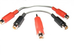

After seeing your pic of the attenuators, I realized I might have one in my adapter drawer. Yep, I think this it, right?

Patrick JAN 24, 09:37 PM
No... I suspect what you have there is just an adapter (from one plug type to another). You need an attenuator... to reduce the voltage. The RS device I described and pictured is an adapter and an attenuator combined.
Kitskaboodle JAN 24, 10:09 PM
You mean an attenuator has a built in resistor or some kind of filter? Yes, you’re right, mine is just an adapter. Well, at least I’m moving in the right direction.
