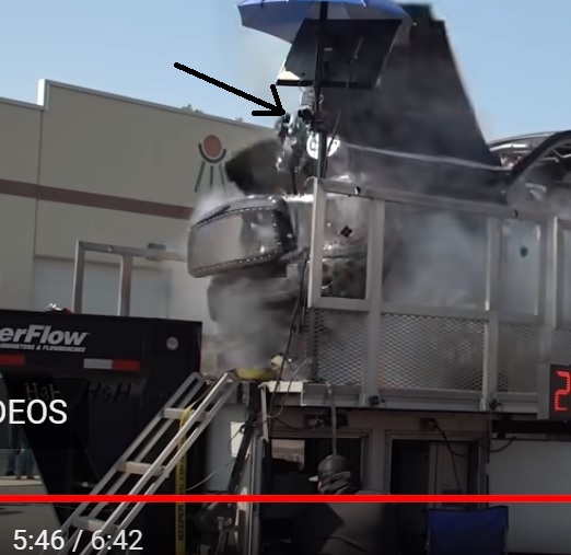

The "passenger" certainly had a rough exit. When he bailed out, he fell and mashed his face into the guard railing which surrounded the platform. Ouch!
Best way to watch parts of this video is full-screen on a monitor at 25% speed... not only for the explosion, but to see how different people react in the middle of chaos.

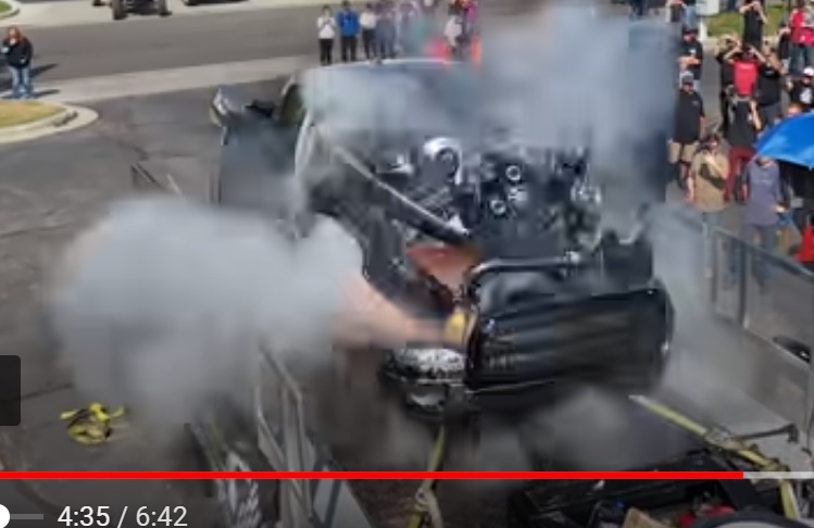

Difficult to say. Watching it closely, the engine comes completely out of the engine bay, still running at 4:35. It settles back down into the truck about 1 second later, unattached but still running and is wallerin (that's a real word where I live) around in the engine compartment so much the whole front end of the truck is shaking. The engine, after settling back into the truck, is still running a a much lower rpm at 4:40 as they are using the fire extinguishers.
May be an air/oil explosion that threw the engine out and not a catastrophic engine disassembly, tho it is possible a disaster on the bottom end could have resulted in the oil/air explosion.
Notice there are no flames yet, except just a bit of orange under the truck.

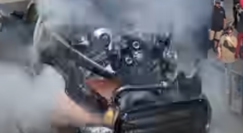

You can see the engine up above the engine bay in this picture:
 The absence of large pieces of engine shrapnel (pistons and cylinder heads) flying about leads me to believe it was a bottom end failure. I'm not even convinced anything came thru the side of the block.
