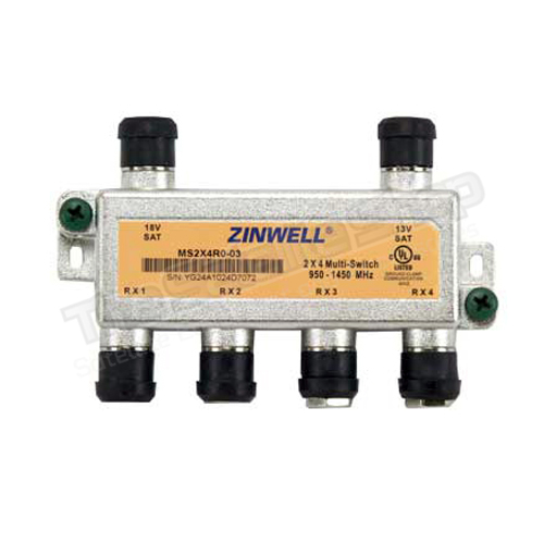

We currently have an old DirecTV system that uses two LNBs at the dish.
It uses a 4-way splitter/switch that looks just like this...
Of course, since there is no external power supply, I have to believe that the LNBs are being powered by the receiver boxes. No problem with that.
What I have, now, are three receiver boxes and televisions. I need to add two more "taps", (and maybe two more receivers/ TVs for an addition that we are building.
I have looked around and haven't found any 2x5, 2x6 or 2x8 splitters or switches.
Does anyone have any idea what I need to come up with?
Thanks!

IMSA GT OCT 18, 07:43 PM
I'm assuming this is what you need?
https://www.su mmitsource.co...6.aspx#moreItemsPane
This page has the hookup diagrams at the bottom in multiple configurations
https://www.solidsignal.com/pview.asp?p=sam-6802

Raydar OCT 18, 08:03 PM
Thanks for that.
After poking around a bit, I blundered across that same exact device.
The diagrams will be useful.
Very much appreciated.
Edit - This is what I bought. Looks very straightforward, and similar to the one you posted.
https://www.amazon.com/gp/product/B00KWMPNGM/

theogre OCT 26, 05:39 PM
⚠️ Caution:
Do Not leave "leftover" outlets on an amp w/ nothing connected to them.
Most Amps Must have termination on most to all terminals.
Many new ones come w/ some terminators but may not have enough depending on premise wiring.
Others "self terminate" unused ports but only on the unit.
RTFM for amp used about termination.
If you have extra term's left, bag them and note what they are...
Why?
Example: If you remove a "TV" box then need to terminate the cable or pull cable off the amp and terminate the open ports on the amp.
If you don't follow this rule then expect problems w/ the amp and any/every thing connected to the amp.
Terminators (has 72Ω resistor hidden in them if their simple terminators) stop signal you want getting out but RFI (Noise) being injected to everything.

Raydar OCT 26, 07:06 PM
Originally posted by theogre:
⚠️ Caution:
Thanks. I know all about terminations. Unterminated outputs are always a bad idea.
The replacement amp came with enough terminations to cover all the unused outputs, and I think all the unused inputs as well.
I think there are some on the old splitter/amp, as well.
