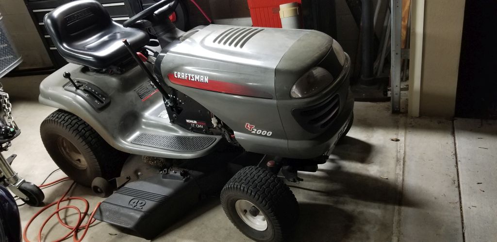

Scored a riding mower for 200 bucks at an estate sale ! Not sure what year it is, has 17 hp engine that is fairly quite.
Runs and cuts great, came with new battery. Best of all, the cup holder works !
Made cutting the grass fun instead of being a chore.[This message has been edited by CoolBlue87GT (edited 04-18-2021).]

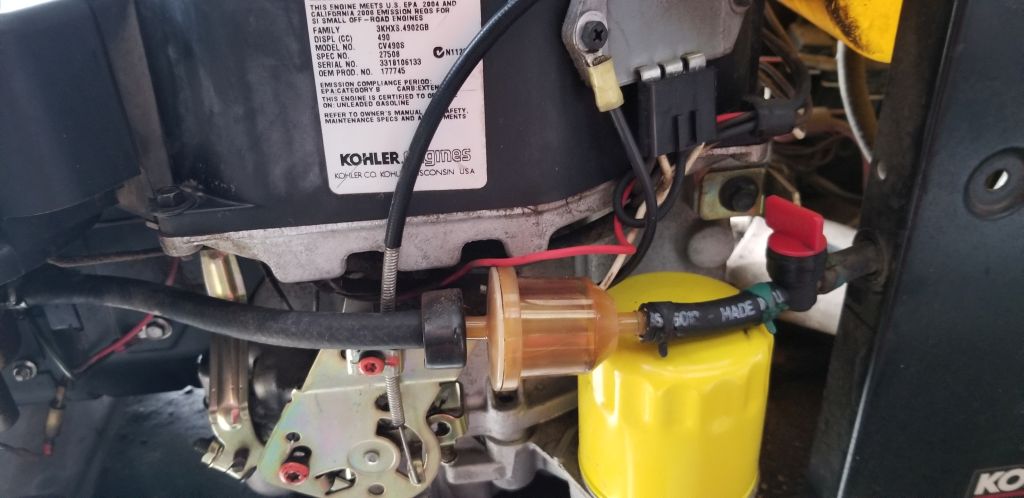

I have a Craftsman 2000 just like it. About 8 years old. It's been a good one. They have two common problems. You should put a cutoff valve in the fuel line. The carb tends to let the gas flow into the crankcase while it's parked. The OHV engine rocker arm nuts will loosen over time. When it begins to act like the battery is low but a couple of bumps will get it going, have the valves adjusted.
This is the third mower of the 2xxx series I've had. They had different series numbers and about 1/2 HP difference each but they were the same base engines. The first broke a rod when it dropped a valve. The second got to the point the valves wouldn't stay adjusted for more than a couple of mowing sessions.

Hi fierofool,
Former owner must have installed the in line fuel cutoff valve. He did not tell me about the problem you mentioned I did experience that and figured out using the cutoff valve by myself. When it happen to me, the engine acted like it was hydro locked, fully charged battery would not kick it over. I pulled the sparkplug, and a good deal of fuel poured out of the cylinder. I put the spark plug back, and the starter cranked like normal and the engine fired right up.

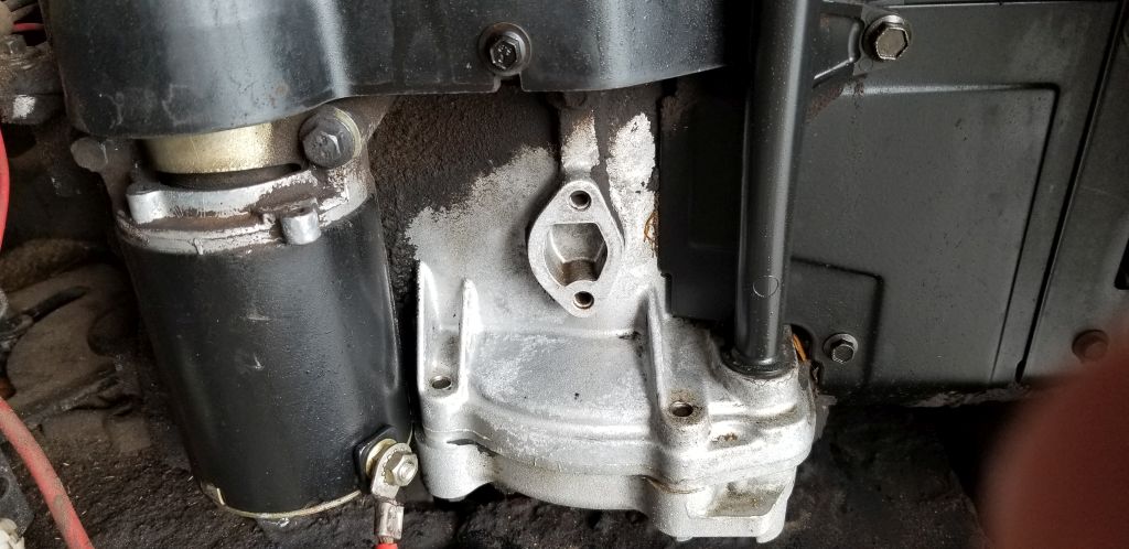

Could you post a photo of your engines right side ? I'm looking at mine, and it looks like something is missing. I'll post the area I'm questing
Here's the cutoff valve
Any tips on draining the crankcase & filter ? Looks pretty straight forward.[This message has been edited by CoolBlue87GT (edited 06-05-2019).]
