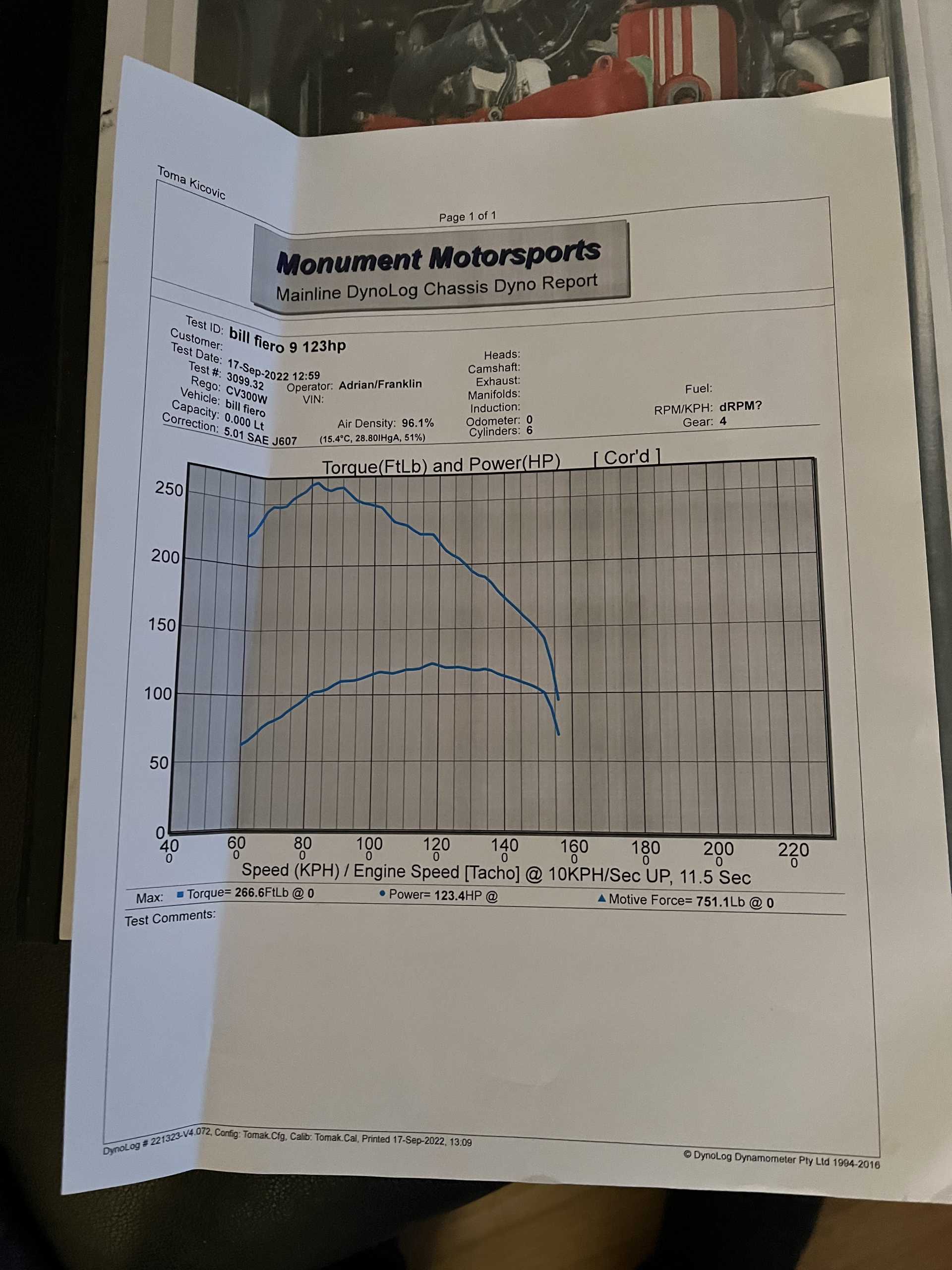

Just wondering if anyone else has converted their original 2.8 to drive by wire? .I did this to my 85 GT. and it seems to be sucessful so far.it is now 146 hp and 266 ft lbs and is very driveable.
We're not talking about this 266 torque number?
sleek fiero
DEC 19, 07:34 PM

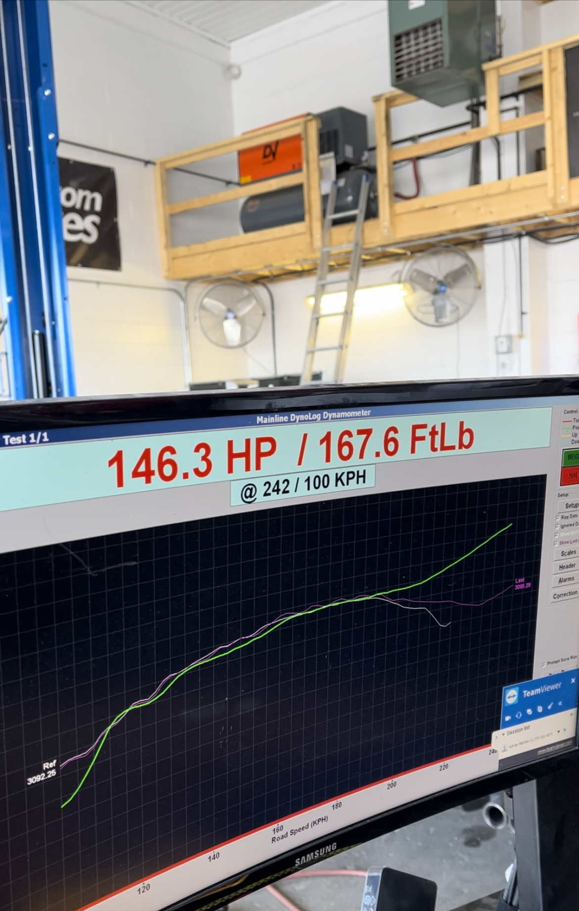

Ls3 mach . what do you mean ? I know i am on the wrong thread but the rules wouldn't let me change to the tech thread. If you are questioning the dyno results I can probably post the video of the pulls.

Love to see it and the build. That's 100 more than stock out of 2.8. Unless I've just misread or understood.[This message has been edited by ls3mach (edited 12-20-2022).]

82 T/A. yes I posted the main modifications before but here we go again. original block bored 1mm and new 3.1 crank ,flywheel and harmonic balancer.This gives 3.208 liter displacement. 10.5 to 1 Diamond coated racing pistons and Scat rods. Mellings high volume oil pump and Crower 3050 high performance cam ,lifters and timing chain kit. Rotating asembly assembled and balanced by K and S Machine in Kelowna BC. Stainless valves ,bronze guides and comp cams roller tip rockers. hi perf springs and retainers. Ford Racing 52 lb injectors . Headers and Ocelot stainless exhaust. Ram camaro clutch. Emtron sl6 ecu and accessories. Bosch and GM sensors. the picture is the best torque run and the video is the best hp run. This is at the wheels. Adian Norton from Emtron did the tuning and said we can get more power out of it but I asked him to keep it streetable as I want it for daily driver.

I assume this is "low" because it's at the wheels, as opposed to what it might look like on an engine dyno without any loss of course. Would anyone here know what a stock dyno at the wheels look like? I assume we're seeing ~25 more hp, and 50 more ft-lbs?
Sleek, couple of things I'm interested in. I have a Fiero too (I guess that's obvious since I'm on here), but it's been in storage for a decade. Before I put it away, I had built it into a 3.1 with crank and rods. I think I need to rebuild it with a better balance... but I notice you say it comes out to about 3.2 liters, I assume this is because your piston selection is likely a .030 overbore, correct?
It's hard for me to see the RPMs on the dyno... how is the driveability? Up to what point (RPM) does the engine continue to pull well?
