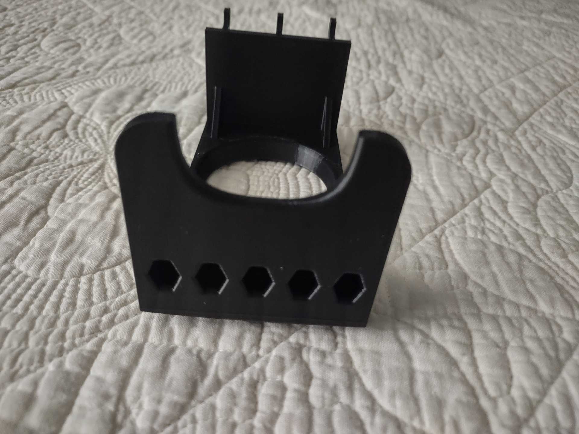

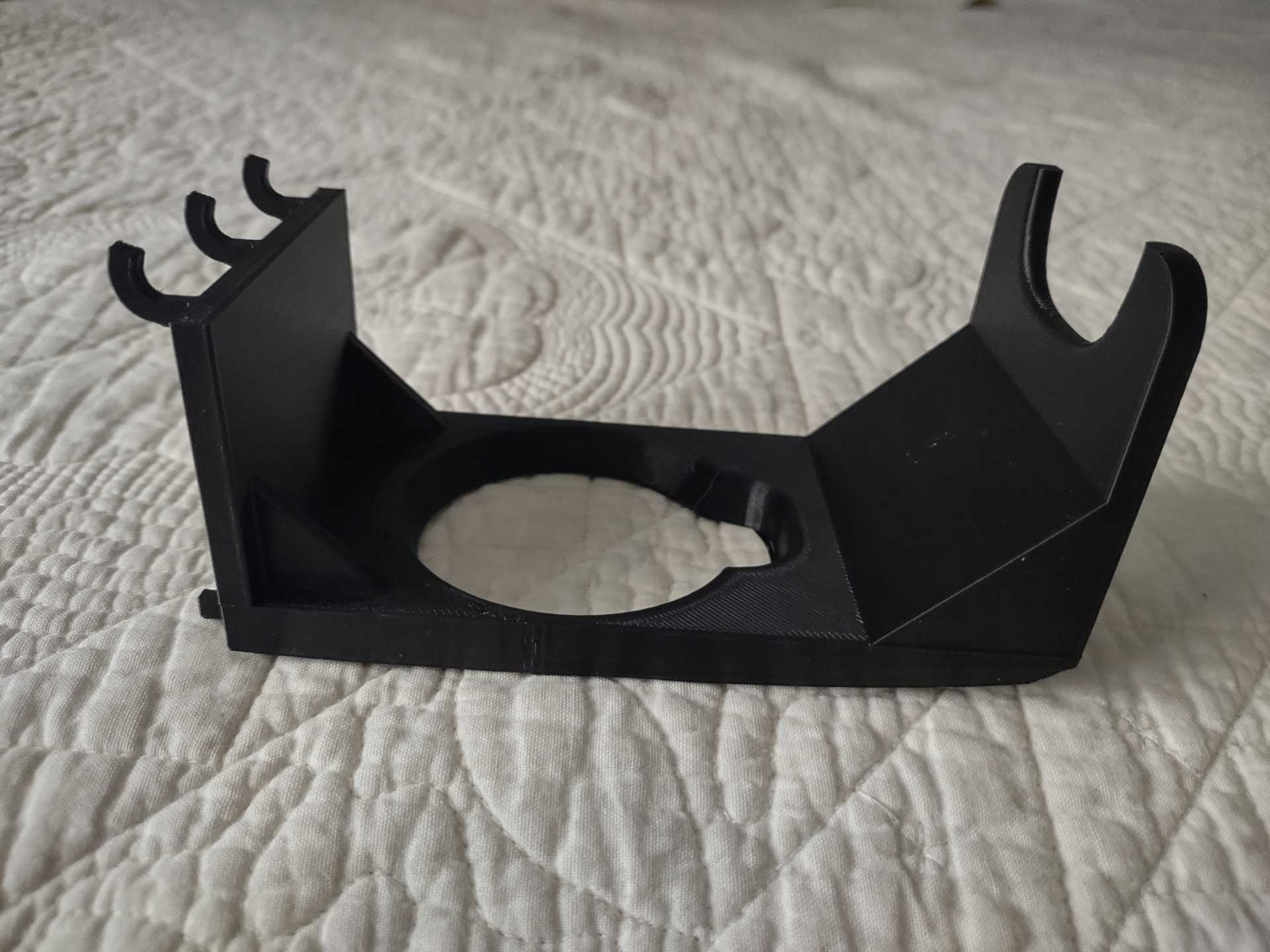

I printed this peg board drill holder. Came out awesome for one. Just trying to replicate it, because I have several drills.
