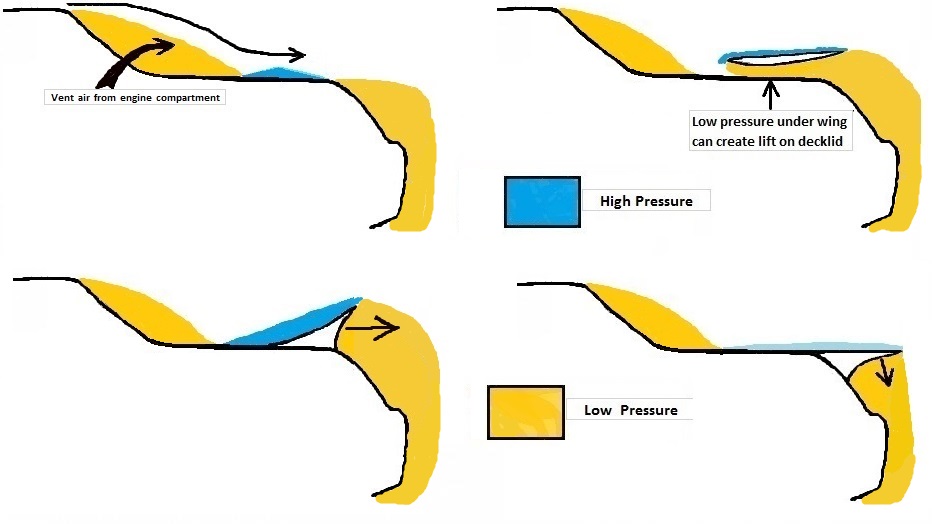

I wanted to state something about Aerodynamics vs Trucks; There has always been the big debate about the tailgate being up or down- either is still (Basically) bad, aero-wise; Two ways to go for improved aero on a pickup truck; A) Install a lid or tonneau cover...This a big improvement.....But by far the best thing to do is to B) Install a camper shell even with the roof of the cab- The flat back-end is (Basically) a Kamm effect situation where the air-flow breaks cleanly from the vehicle....This seems contradictory to people with limited Aerodynamic knowledge.

I also did some diagrams of how different wing/spoiler setups on our Fieros can create down-force vs Drag...

Obviously, it would be better to have (Very) gentle taper to the rear- But how would that work on a Pickup? Or a semi? If you have a steep taper it will create lift and drag. Remember the rear of the incredibly ugly 3rd-gen (92-95) Taurus? It was all rounded and tapered....and it's aero was bad......It is better to chop the tail off clean rather than have the air slowly trying to disengage while creating more drag.
On my 1973 Mustang I made an airdam that rammed the air in from directly in front of the radiator >>Below the Bumper<< while the air to the sides was deflected outward....And then I completely blocked off the GRILL- even used foam strips to seal around the headlights and between the grill and the hood. I had driven it in a cross-head-wind once and the front was floating- Uncontrollable above 60 mph; ALL of the air that hit below the hood-line was (Originally) rammed under the hood, which had 3000 square inches of surface- so 1/10 PSI would create 300 lbs of lift!
After my mods I had it up to 95 mph passing 3 semis and 2 cars on highway 97 above Mt. Shasta- it was rock-solid.
If you want to put a 100 foot taper on the back of a semi then you can have better aero- but it will be a ***** to back-up.....
