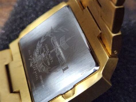

I found an image of the back...
That little slot is where you can use the tool that you found a picture of. These are really cheap. If you can wait... you can get those from AliExpress for a couple of bucks... like, less than $5 shipped. If you don't want to buy that though, pretty much any thin flat-head screwdriver should be able to pop it out. The only thing is though that a metal screwdriver will usually mar or damage the caseback. So if you have really heavy plastic pry-tools (like for taking apart a tablet to repair it), you can use that.
Putting the caseback back on is usually as simple as pressing it on with both thumbs. If it's not going on, you may need to bend it a little (to make the outside of the case back bow outward. Or, you can use a case-press (which you can also get on AliExpress or Amazon.com for about ~$10.
The battery, you'll see which one you need once you've removed the case back. Really hard to see without a magnifying glass as we get older. They're very expensive if you get them from say, the local pharmacy or convenience store. Best to buy them from Amazon... usually you can get a 10-pack of whatever it is for a few dollars. They'll generally charge you like $5 bucks for one at the convenience store.

Ordered a couple of Energizer CR2016 batteries off eBay, coming from back east...
Order placed late Friday, mailed on Monday, arrived today (Thursday) via Canada Post (in a regular letter envelope). Not bad, I guess.
Put the battery in... and the watch sprang to life. The toughest part was snapping the back of the watch in place. Glad I've got strong thumbs!

Yeah, the tight case-back is usually because it's the only way to maintain water resistance with the little gasket there. It's probably a 3-bar/atm is my guess. They sell case-back presses, if you ever wanted to get into fixing watches and stuff, haha. But generally when you push in the middle, it causes the sides to flare out, which makes it even harder to push in, so you did it correctly by pushing on the two sides. Sometimes I take the case back and bend it a little by pushing on the inside in my palm (which moves the edges a bit more in), and then I can snap it in.

...so you did it correctly by pushing on the two sides.
I didn't really know what I was doing... but I started at one end and pushed down on both sides with my thumbs, and then pushed the middle on both sides, and then pushed the final end on both sides. I was very happy to hear the extra loud "SNAP" at the end!
