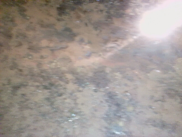

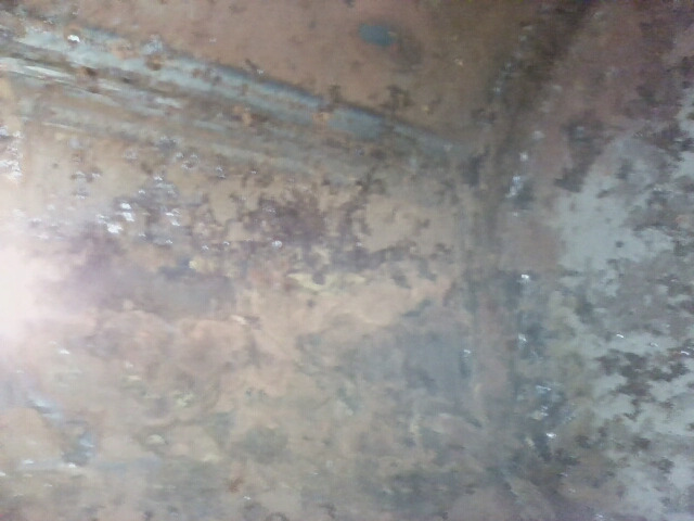

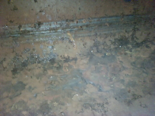

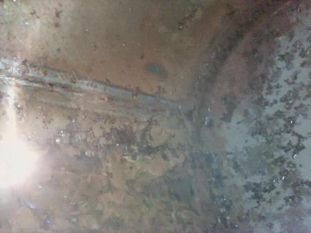

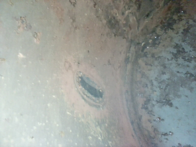

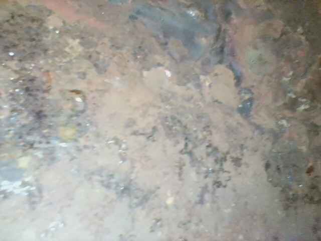

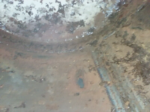

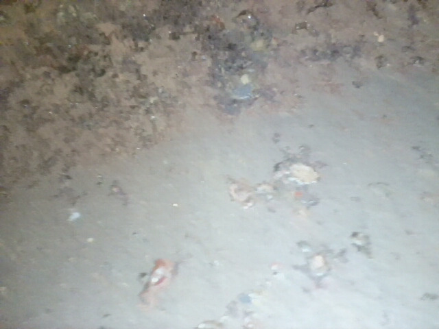

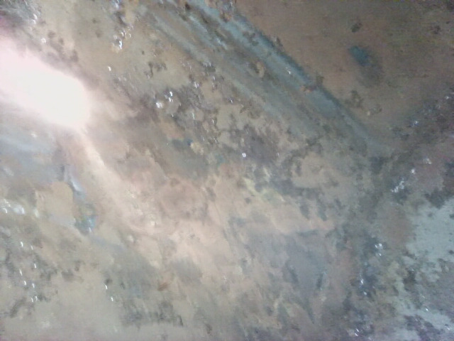

I decided to run a camera down inside the tank, to check for rust.
Does anyone have any opinions?

Is 1 - 3 gal portable tank, yes? Surface rust on inside won't bother it. Most small portable tanks are "over built" so can take some abuse w/o blowing up.
Unless you use them a lot in humid areas, most won't see enough water inside to rust fail like YT videos.
Would invest in an inline filter. Just to keep from spraying the inside of your computer with rust and moisture.
Unless you use them a lot in humid areas, most won't see enough water inside to rust fail like YT videos. |
Yes, I think it is maybe a 3 gal tank. The compressor has been in the desert since new, so mostly very low humidity.
Does anyone have any opinions? |
Wel,l it looks okay for airing up tires. I see rust.
I was educated to use an aerosol air blower to purge the interior of a computer of dust and keep out moisture.
Yeah, Arizona is a dry heat. Where did that rust come from ?
