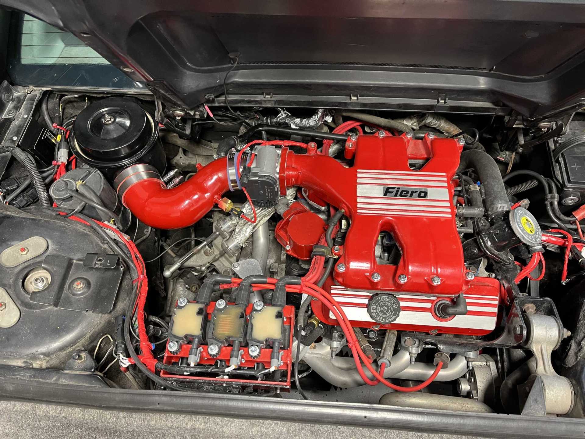

82 ta I used a Bosch 54mm throttle body from a VW. Throttle from Nissan 370zx..Emtron sl6 ecu and aelc2 to control dual lambda o2 sensors. dual Bosch knock sensors. ford racing 52 lb injectors. ls coils andbuilt may own crank trigger wheel and used ls pickups.the 2.8 is bored and stroked to 3.208 cu centimeters.it has diamond forged coater 10.5-1 racing pistons and scat rods and is balanced. stainless valves and good springs and retainers. crower 3050 hydraulic cam and high volume lifters and comp cams roller tip rockers.theres more but you get the picture. by the way i am a licenced mechanic. can't figure out how to download picture.
Very intrigued... it looks totally awesome, you've done a fantastic job here. Would love to know how the driveability / performance feels to you, compared to how it was when stock!

Reposting OP's image so it's easier to see horizontally...

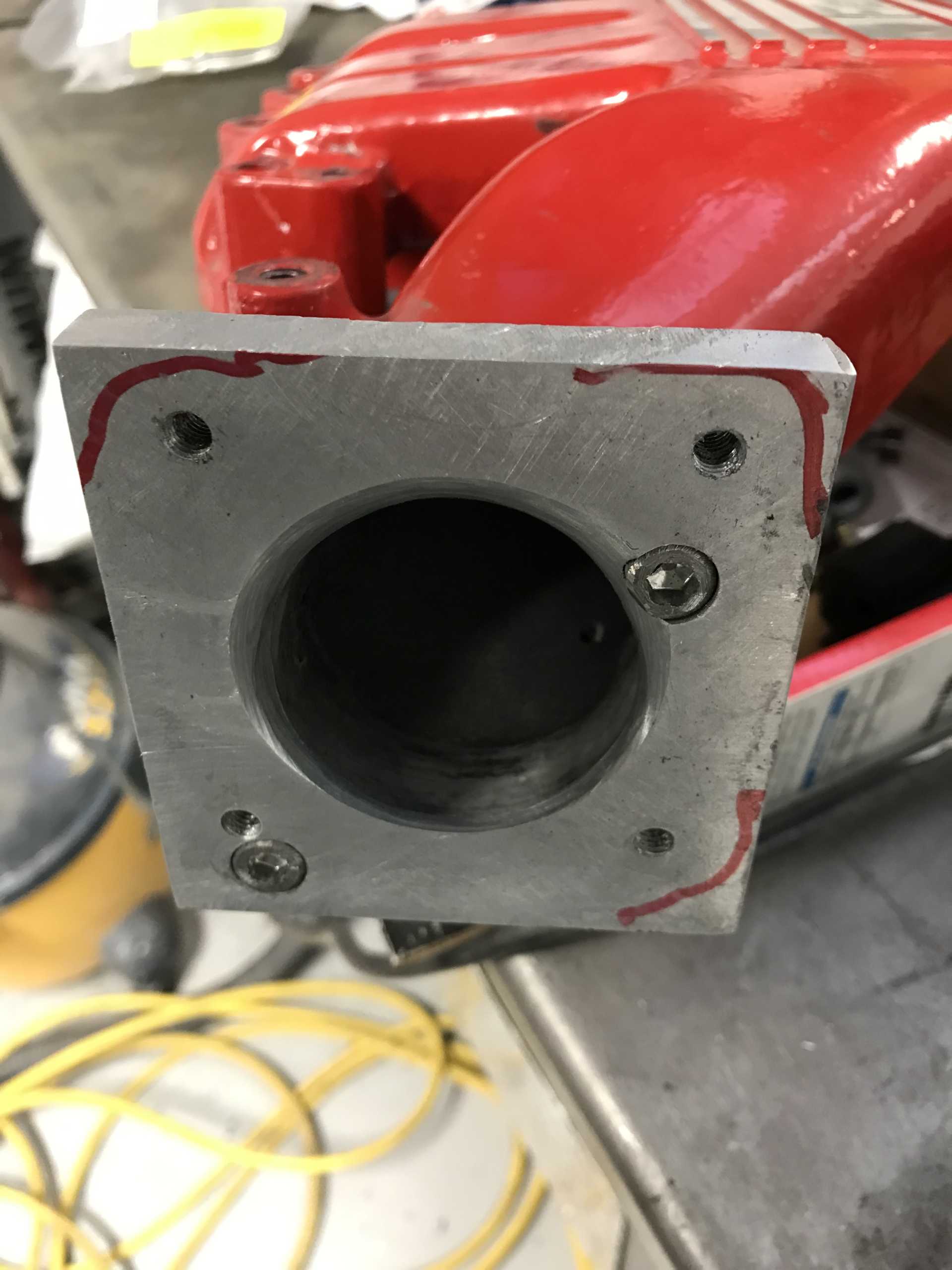

SLEEK FIERO... wanted to mention, you may not be aware of it... but the most significantly "bottleneck" in the Fiero's stock intake system, is actually the red Fiero plenum... directly behind where it connects to the throttle body. I THINK the throttle body size is 57mm... to be honest, it's been a decade since I even looked at it, so I can't remember... but if I recall, the neck actually squeezes the size down to just below 50mm. So if you want to see some significant gains from this set-up... you'll want to bore out the neck (requires opening up the floor of the neck and actually adding material because it'll get too thin) and then port-match the plenum to the intake runners, to the cyl head.

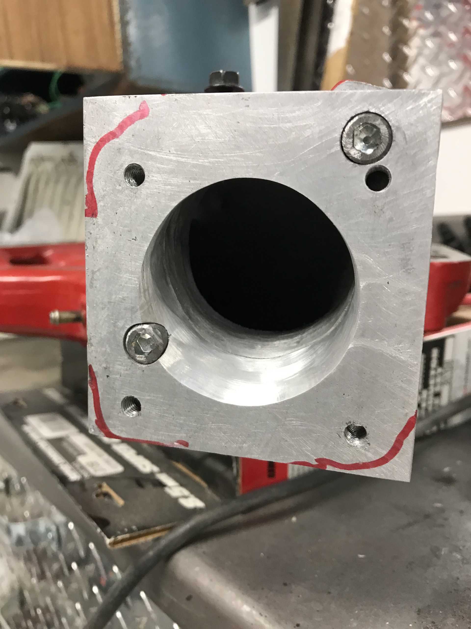

82 TA already done as i had to build an adaptor plate for the 4 bolt Bosch throttle body.it is all opened and polished to match the larger size. the intermediate manifold is port matched top and bottom and the lower manifold to heads is port matched. the exhaust ports to headers also.

The point I was getting at though, was not JUST that you have to port the throttle body mount to match the new (much larger) throttle body... but you actually have to port further down into the neck as well. The stock size of the intake plenum, even if hogged out to the point where you broke through the bottom of the plenum, still wouldn't support the increased demands. I'm not sure how else to explain it... let me see if I can put something together really quick... or find an image from somewhere else...

This is what I'm trying to focus on... the lower portion of the neck is insufficient to support even my modified throttle body, so YOUR throttle body, which is even bigger, is likely suffering even more-so.
THIS is the area that needs to be improved:
In this case, he also chose to delete the EGR... and the welds are pretty messy, but if you haven't done this yourself... you'll want to do it because the neck basically pinches just before opening up to the larger part of the plenum. It's BARELY adequate to support a stock 52mm throttle body at WOT... but likely a significant bottle-neck for you with your much larger throttle body.

  82 TA 82 TA Here is what I did. It is actually 56mm and matches the throttle body perfect

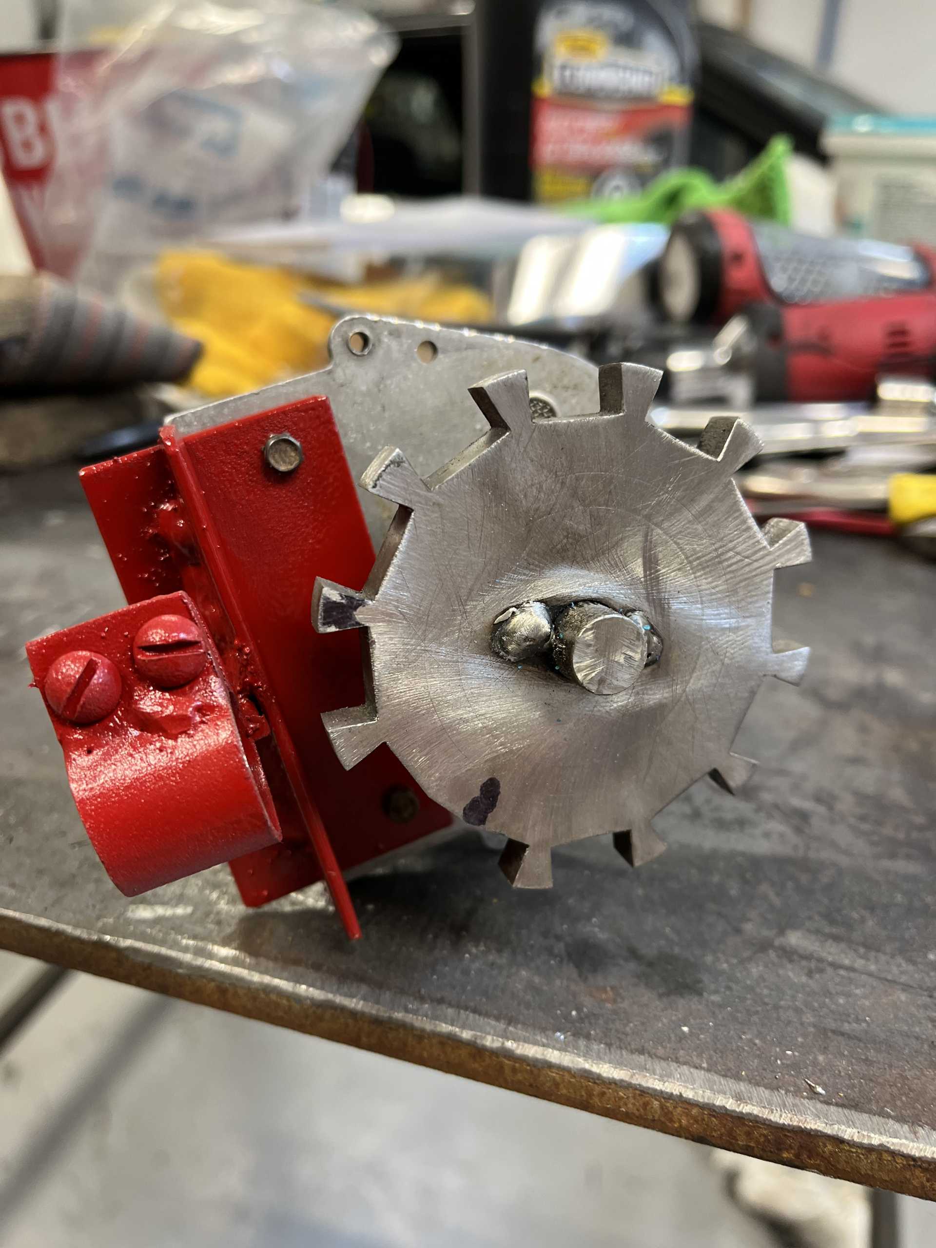

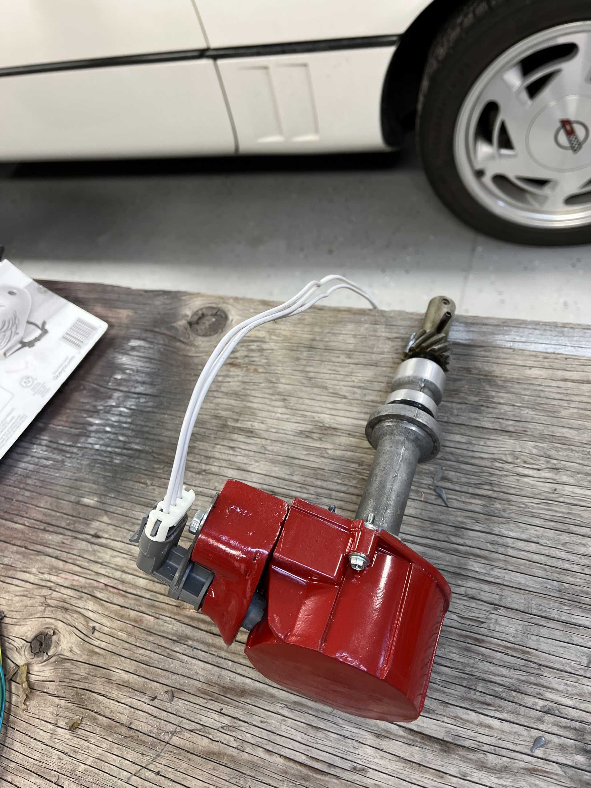

82 TA sorry i included the pictures of the cam sensor I built out of my old distributer. it uses a LS crank pickup
