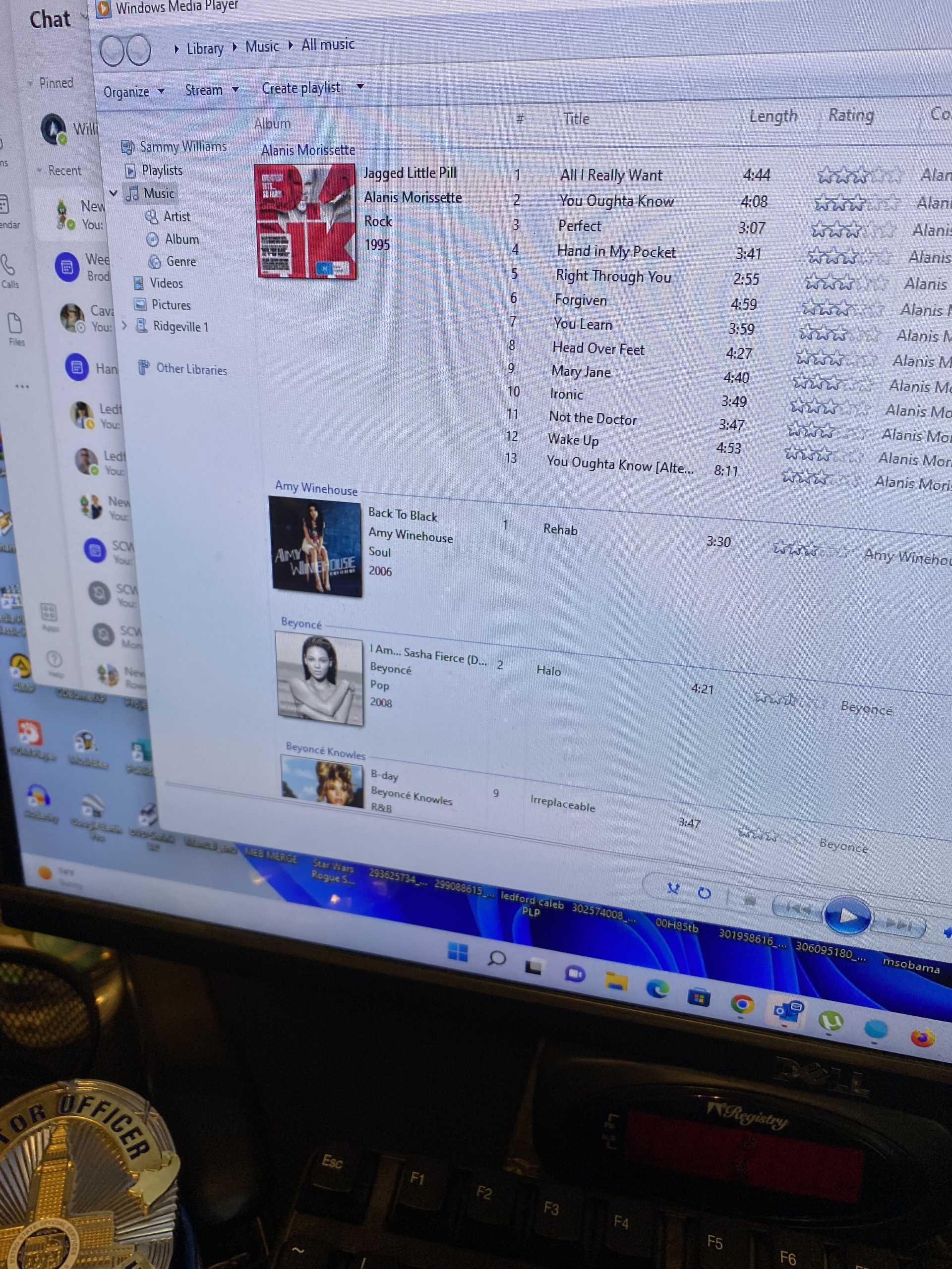

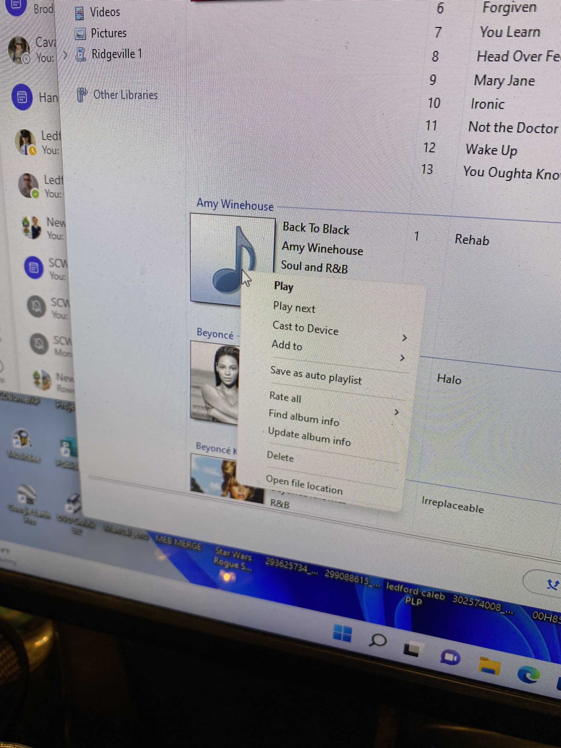

It may be due to Windows 7.
Or a computer setting.
On Windows 11, I just tried it. It dutifully downloaded album art
And Metadata.
I hate to say:
Raydar, maybe it’s time is close.
Pics follow. 🙂🤩
