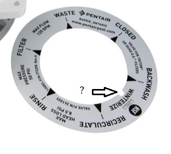

Exactly what does multiport valve's 'winterize' position do? Isn't it just to protect the valve itself from freezing?

And as far as the winterize setting goes, I'm not actually sure, we don't use it but I'm guessing it bypasses the filter so you can drain it, that way if you're pump is running on a freeze guard for an extended period of time and you're not paying attention, the filter isn't going to get full. But our winters are so short, we might only have a week or two of a pump running on a freeze guard all year.
