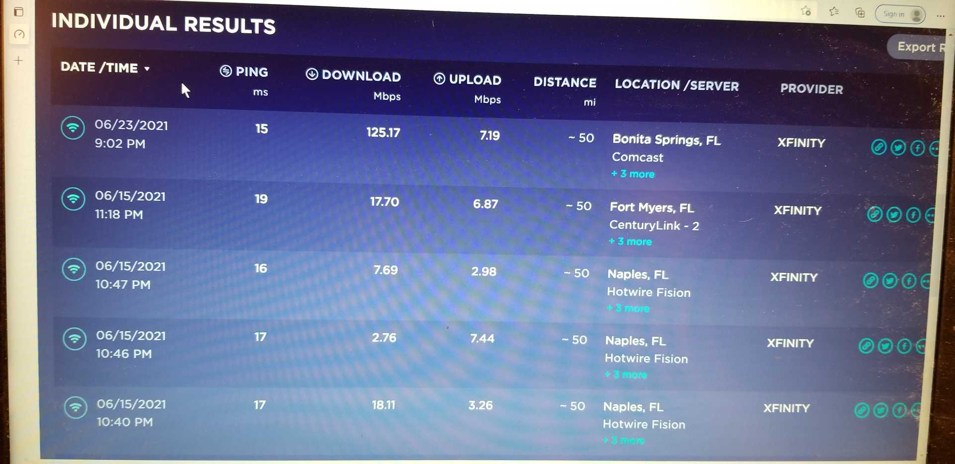

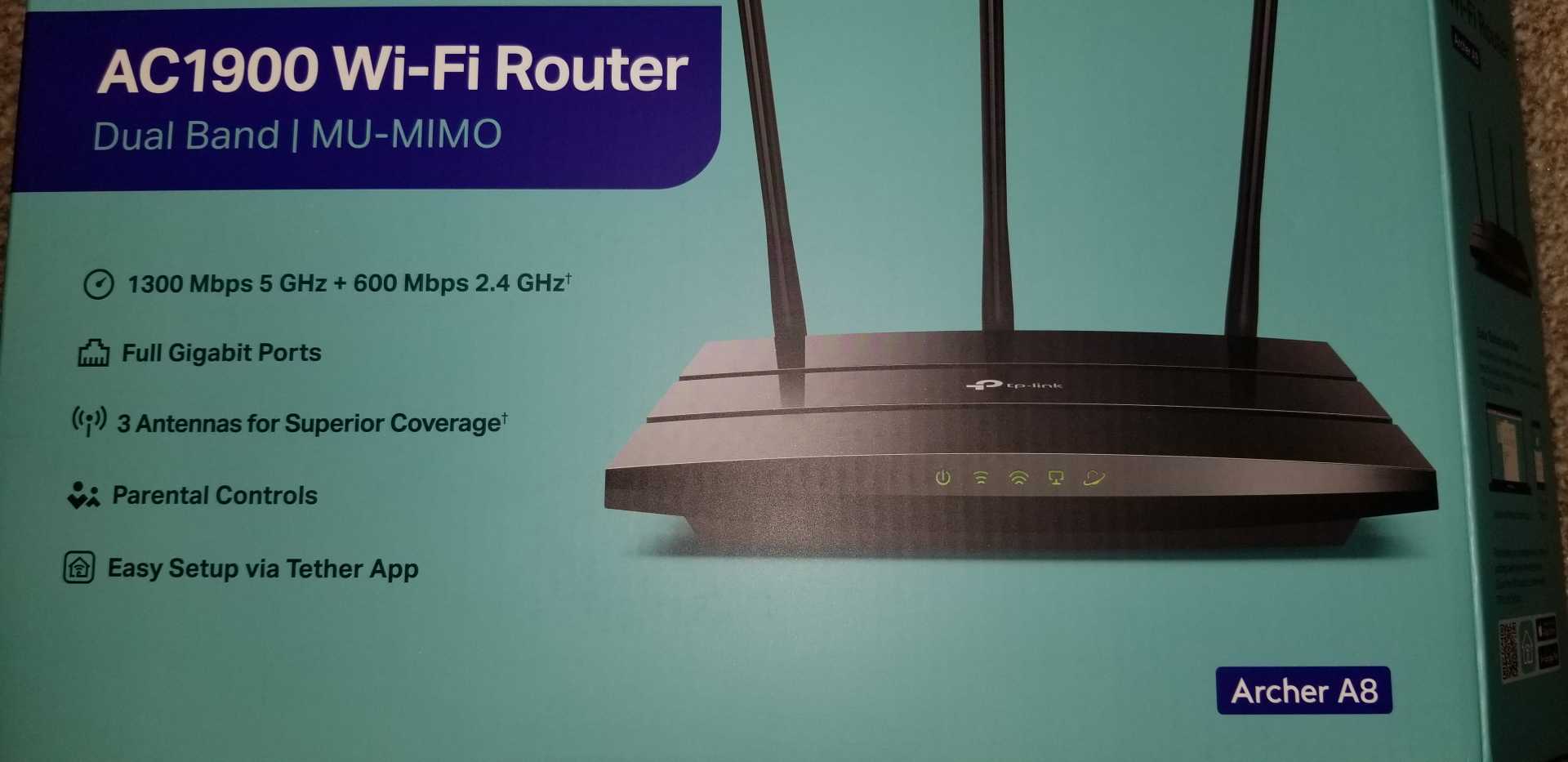

Okay, after searching, I picked up a tp-link AC1900 Archer A8 router on Amazon.
Got it setup in less than 5 min.
Did a speed check, the download speed is alot faster compared to the last 4 test w/ old router.
JUN 23, 09:31 PM
I bought the exact same router at the beginning of the year and I have been happy with it so far.
CoolBlue87GT
JUN 24, 01:04 AM
I bought the exact same router at the beginning of the year and I have been happy with it so far. |
Good to hear ! I was afraid that I picked a router that I would get grief for selecting.
Each device I've hooked to it seems be working good.
