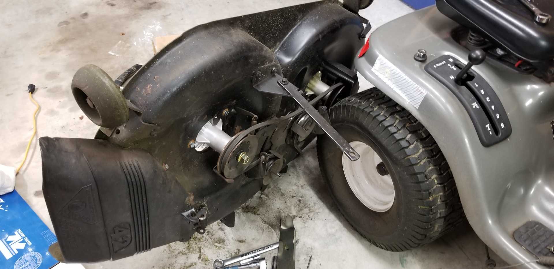

A few months ago, I hit an exposed tree root which broke a mounting tab on one of the spindles.
Bought a pair of replacement Craftsman Husqvana spindles for just $41 dollars on Amazon. Decided to replace both and put new blades on. Painted the deck before reassembling. The mower cuts better and quieter than ever.
| quote | fierofool] Those mowers have a small detent area about halfway up between idle and choke. |
Yes, that is what the former owner meant as "full throttle"[This message has been edited by CoolBlue87GT (edited 04-18-2021).]
