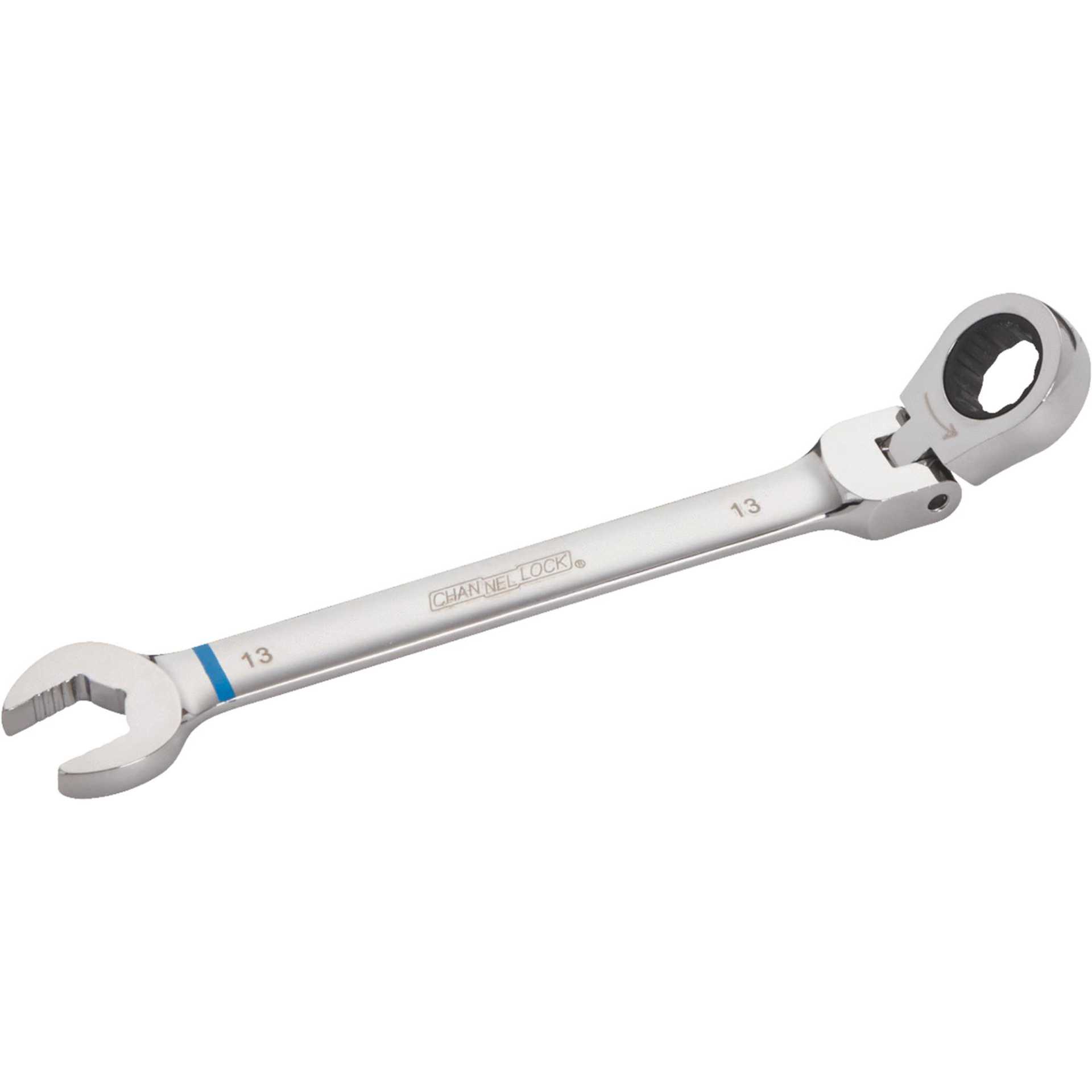

I moved it from my last Fiero to my current one. The one thing that drives me crazy is how tough it seems to be to work on/off some of the nuts. It's like you can only do an 8th of a turn, and hope that your ratchet has fine enough teeth to click. I used a combination of wobble extensions and universal joint sockets or deep sockets. Mine is starting to have some surface rust, and had I been thinking about it, I would have hit it with some etching primer or something before I put it in.
Anyhow, I buried the lead - does anyone have a combination of tools (even if it's different ones for different bolts) that make taking it out/putting it in easier? Or should I just mask over everything around the booster and spray it while it's mounted?

With one of these: 13mm Flex Head Ratchet Wrench.
