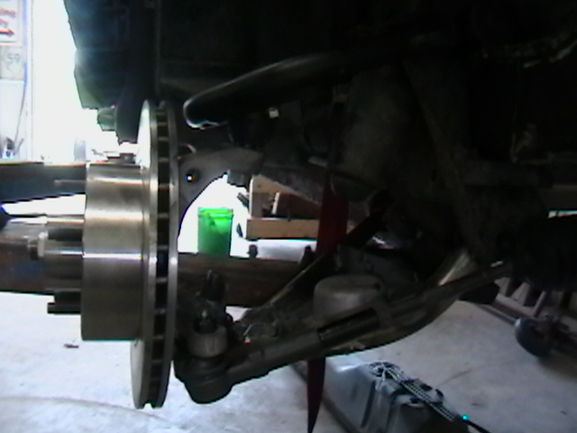

MAR 26, 08:30 AM
I don't know if you can see it, the lower front control arms are HT Motorsprts, except they've been mounted with screw-in ball joints from a Chysler. The front spindles are early Ford Pinto - turns out they're the same height as Fiero. The good news here is that there are lots of after-market parts for Mustang/Pinto spindles, so the front brakes are 11" aftermarket for Mustang II (the hot rodders friend). The upper a-arms are aftermaket Mustang also. The air bags are from Universal air, with about 9" of articulation. Of course, the suspension only gives me about 7" of front movement, but I'm trying to keep the stock Fiero geometry (I'm not a rocket scientist).

MAR 26, 08:33 AM
 This is a photo of the driver's side front suspension.[This message has been edited by artworks (edited 07-14-2017).]

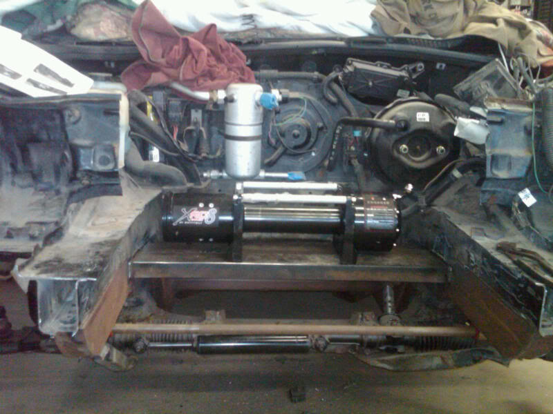

MAR 26, 08:39 AM
The winch was installed on Saturday - 8,000 LB Smittybilt with synthetic rope. Including the two pieces of 3"x1" C-channel, I've added about 130 lbs to the front, right over the axle.

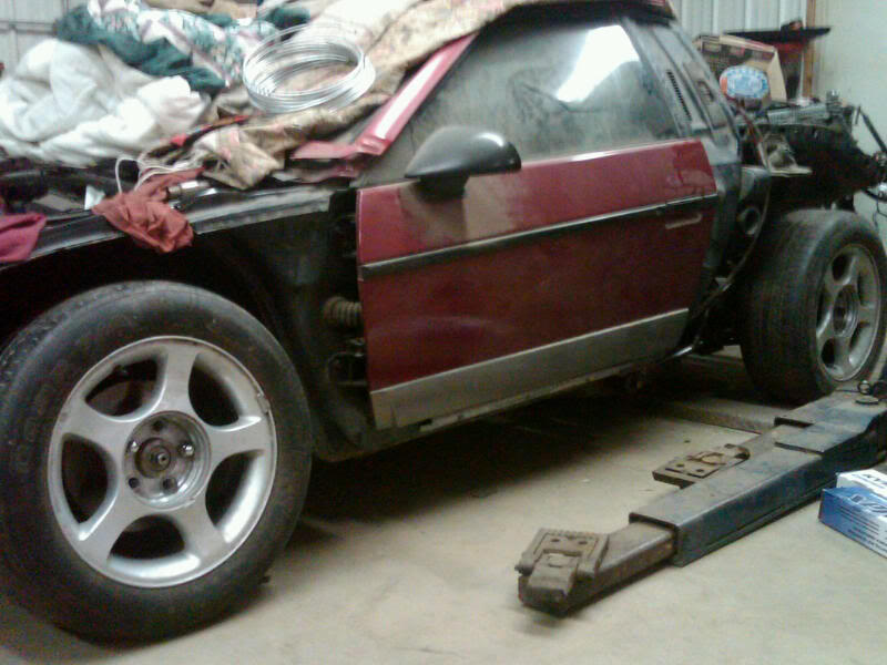

MAR 26, 08:40 AM
Its sitting on its own wheels for the first time in almost 2 years!

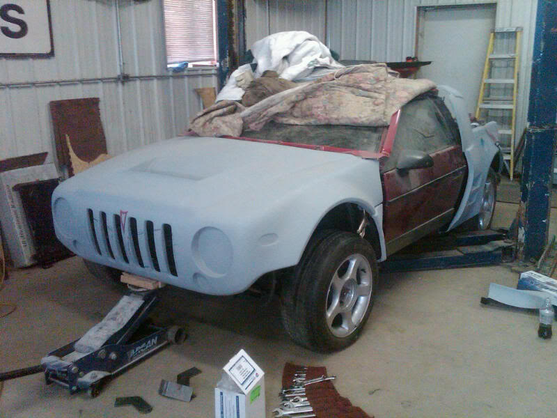

MAR 26, 08:42 AM
I've had the body panels for over a year now, this is the first time they've actually sat on the car
