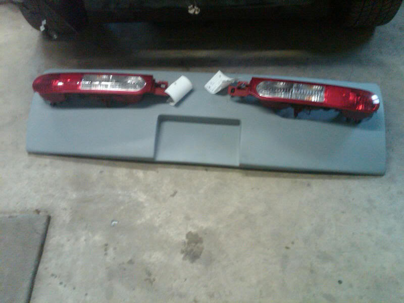

Note the tail lights - from a 2009 Nissan Cube. I still need to hack the crap out of the 'glas to make them fit, but I think the look suits the body.

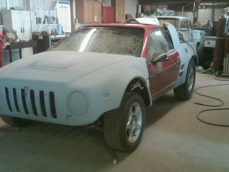

Fitting the body panels in place today. ![](http://images.fieroforum.com/2017/IMG00187-20110122-1413.jpg) [This message has been edited by artworks (edited 07-14-2017).]

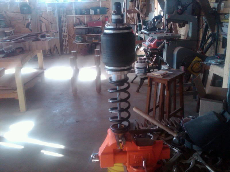

I haven't done any work on the car lately, but I have been putting together a new coilover shock system for the rear.

The photos above show the rear suspension in place - note the subtle difference between these and the earlier photos - we had to re-fab the shock mounts so they would clear the spring perches. The top mount uses the original strut bolt holes, but there's a 1/4" plate instead of the old spring perch. The airbags clear just fine, and will give me 5" of forced articulation. The steel springs are 300 lb/inch coilovers for a stiff ride when the bags are full or empty. In between, the air will give a nice cushion. Man this stuff takes a long time!

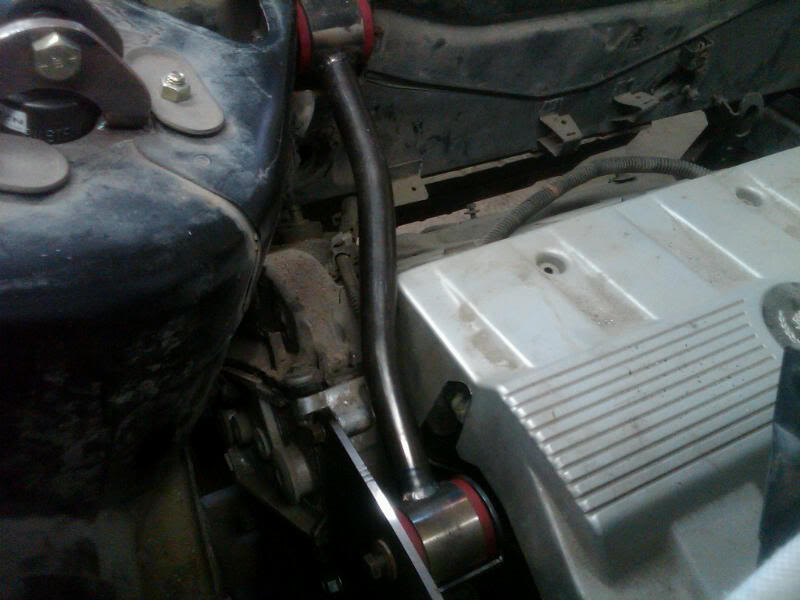

![](http://images.fieroforum.com/2017/IMG00065-20120121-1429.jpg) This is the fabricated upper motor mount - its the original Fiero mount cut apart with a new bar in between and a fabricated plate on the back of the motor.[This message has been edited by artworks (edited 07-14-2017).]

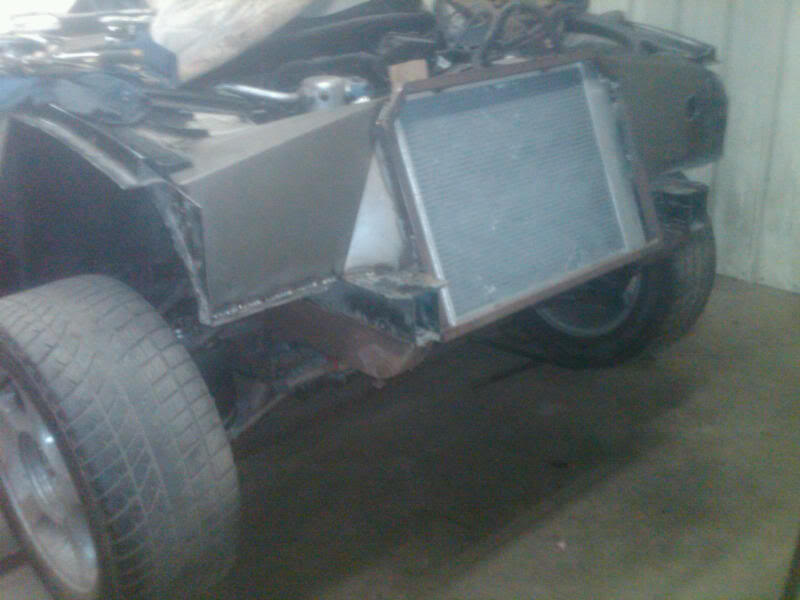

a couple of views of the radiator support and front bulkhead fabricated onto the original Fiero sheet metal. It doesn't look much like the original does it?

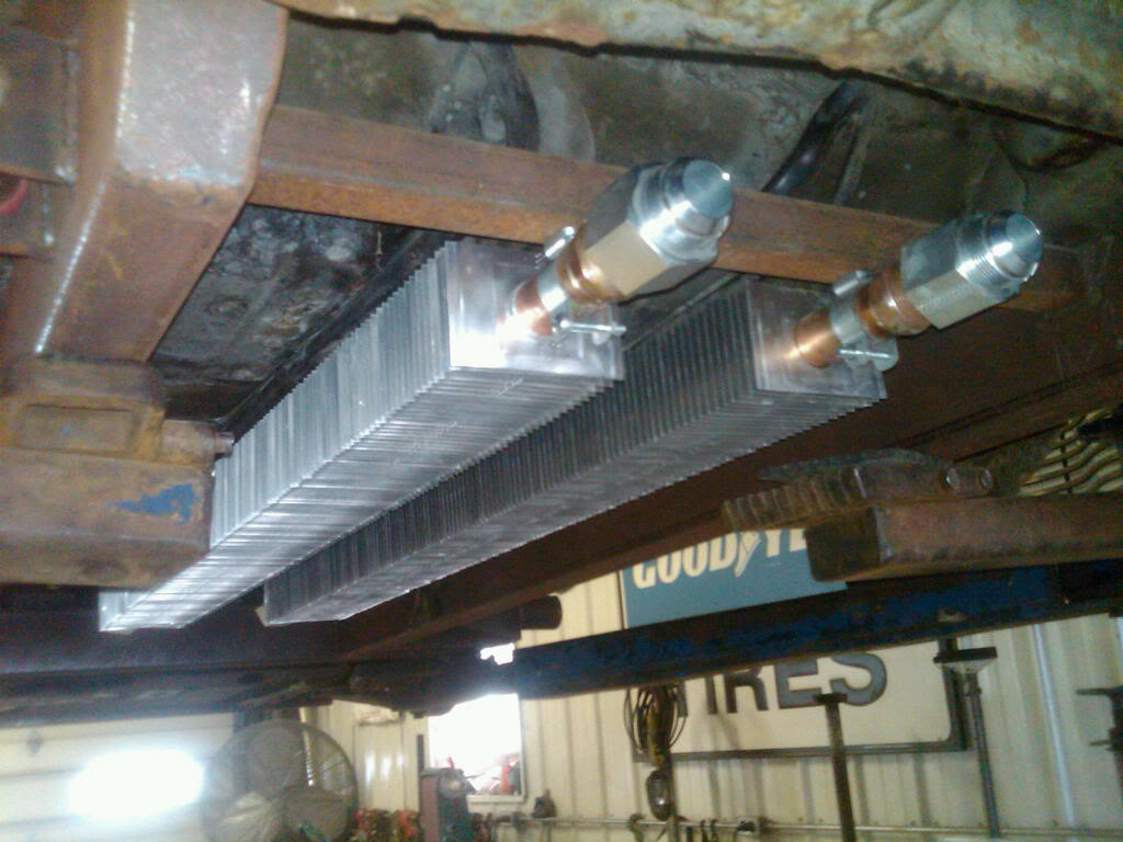

![](http://images.fieroforum.com/2017/IMG00111-20120317-1553.jpg) I was able to get some work done on the car this weekend. These are the coolant lines that run under the car between the engine and radiator. They're fin tubes from a home boiler heating system with AN-20 fittings on each end. The radiator already has AN-20 bungs welded to it, and the northstar now has bungs welded on the coolant log and thermostat. Now I just need to order the braided lines to connect everything. This should provide enough cooling. I'll still need to install an aluminum skid plate to the bottom of the frame rails.[This message has been edited by artworks (edited 07-14-2017).]
