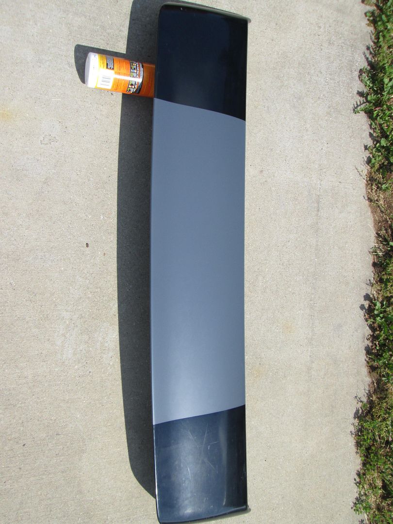

| quote | Originally posted by aaronkoch: Don't know if you saw my build thread, it's not even in the same league as yours, but I just plasti-dipped my car and it's fun stuff! Cheap, easy, and different, just like me.
Just do the whole car in dip, as it's removable when you're sick of it, and it's easier to mask the openings than tape out the stripe..

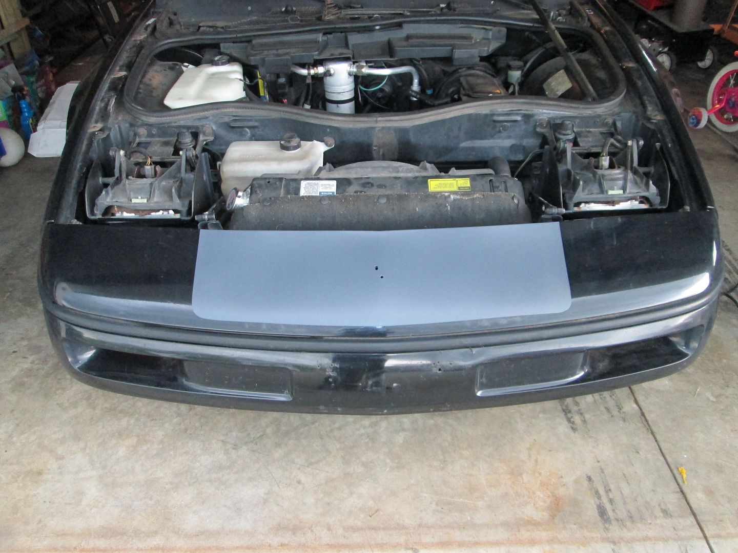

Yeah, I saw your thread and dipping the whole car and yours looks pretty good. I assume you used the sprayer, but I am using rattle cans, and so far I am not very impressed. The cans have a fan tip, but it doesn't transfer anything close to a uniform pattern in the fan pattern (not even heaviest in the center). Result are a bunch of heavy and light areas even when I overlap 50% from pass to pass.
The grey is better than the yellow (color-wise), but the coverage isn't very consistent. I might just peel it back off, scuff the yellow and just repaint the striped portion with my paint gun.

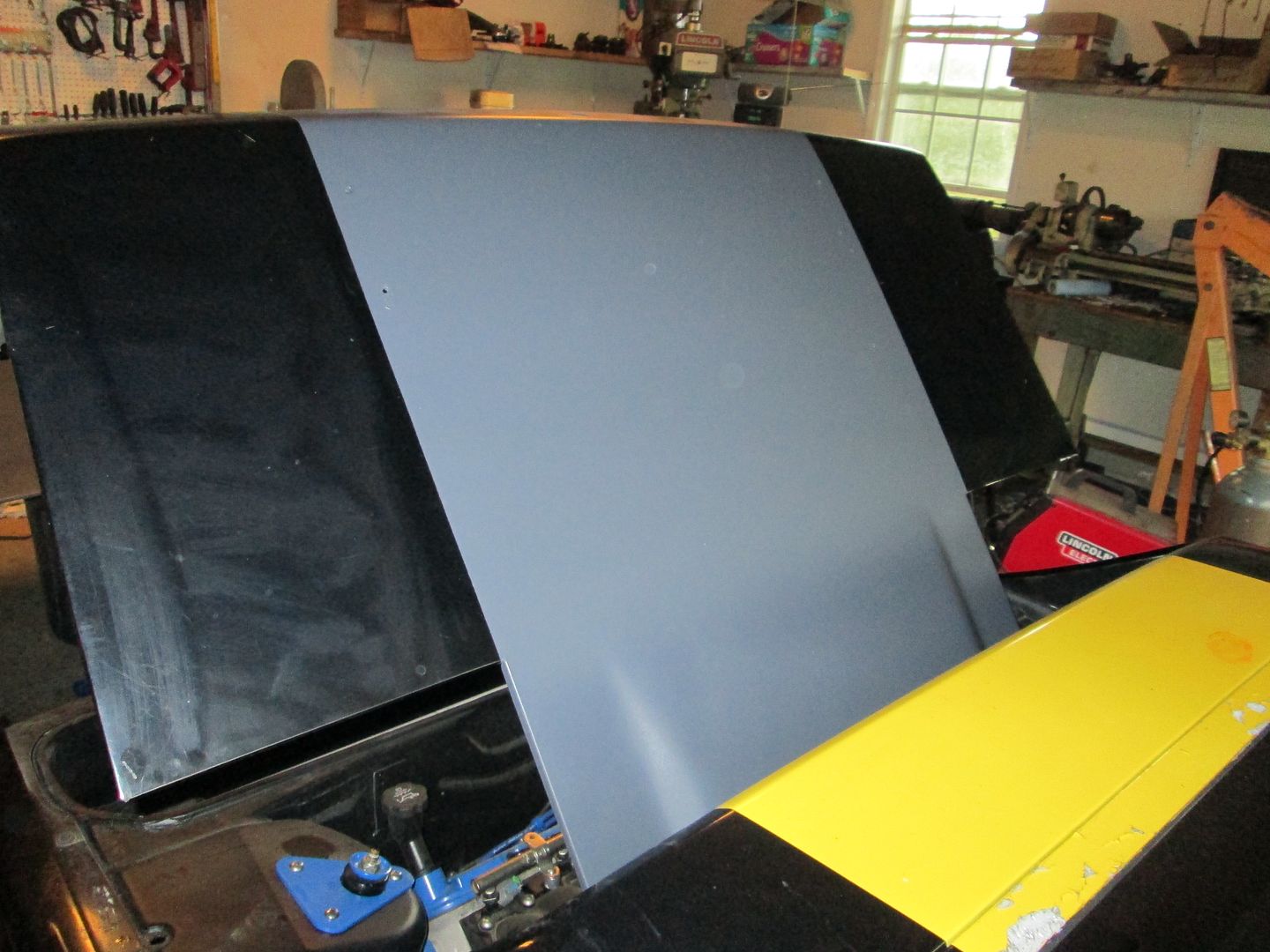

I have been busy swapping the roof panel (no more sunroof). When I started the roof panel swap, the carpet was wet from sitting outside during the rain, so I pulled all the carpet back out. I have the new top panel sanded down and ready to primer/paint before it is installed on the car.

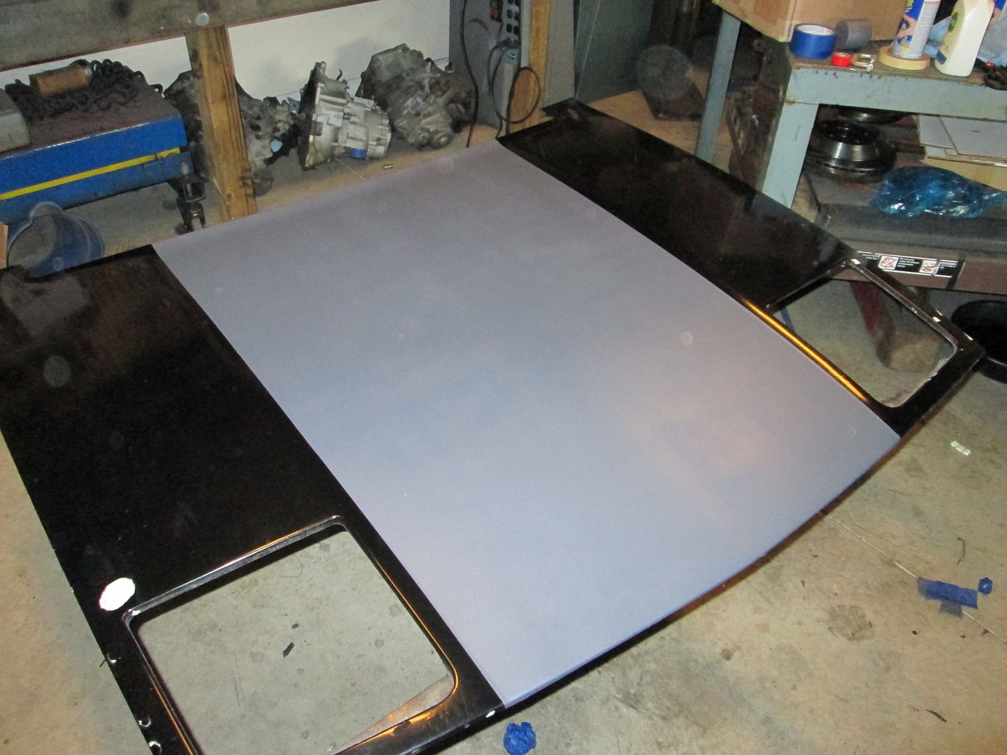

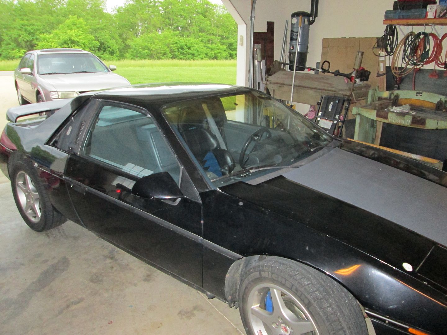

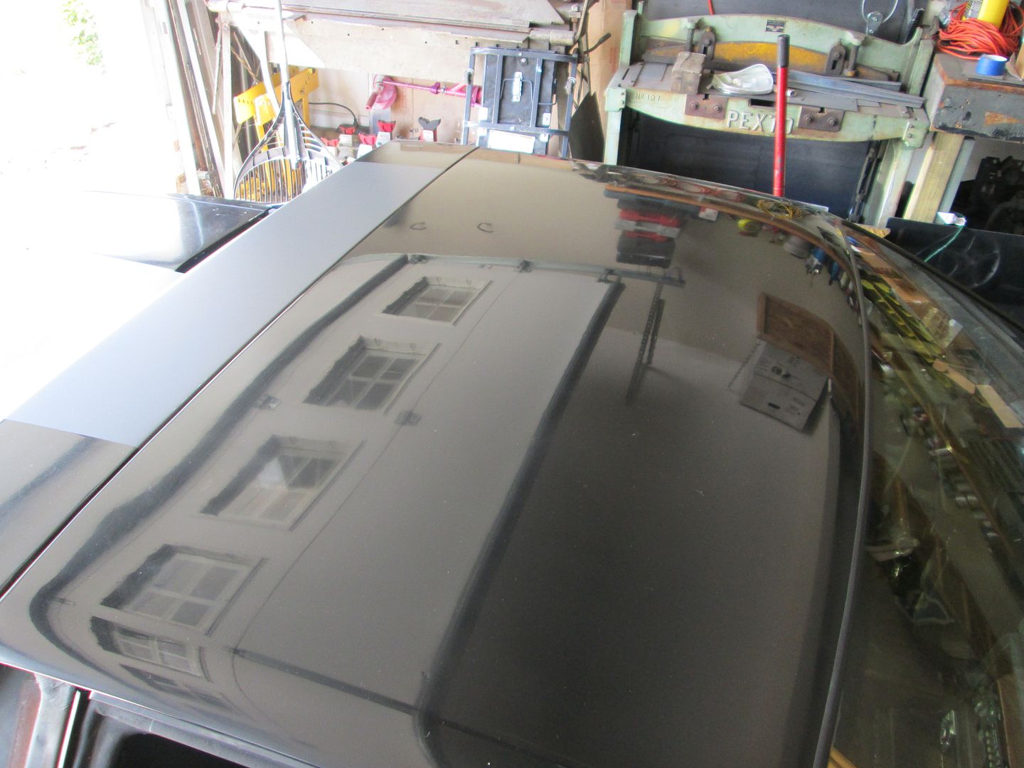

The roof panel swap is now complete. It came off a white car, so I wanted to get it painted black to atleast match the current paint on the car (I would like to get the whole car painted voodoo blue eventually, but black works for now). I really hate painting... this panel is far from perfect but it will work till I get the car painted professionally.
I also finished up plasti-dip coating the yellow stripe on the spoiler, so now there is no longer any yellow showing on the car:

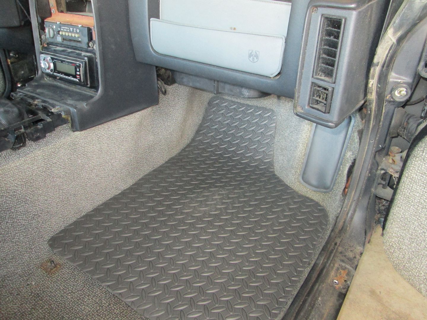

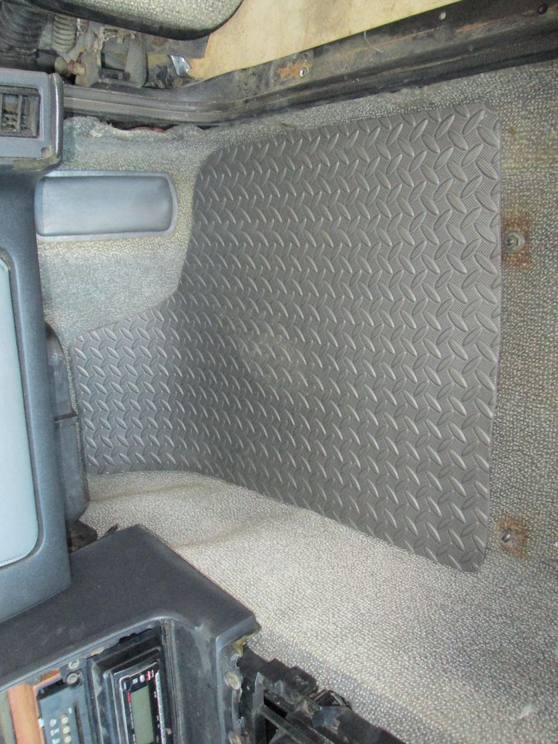

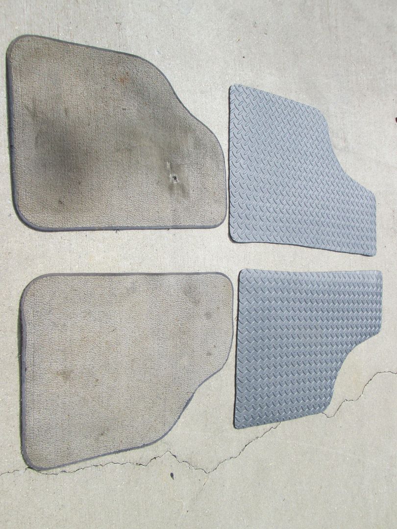

My floor mats from boostdreamer showed up and look good!
I am hoping to have the car ready to drive again on Sunday and get the LS7 MAF dialed in.

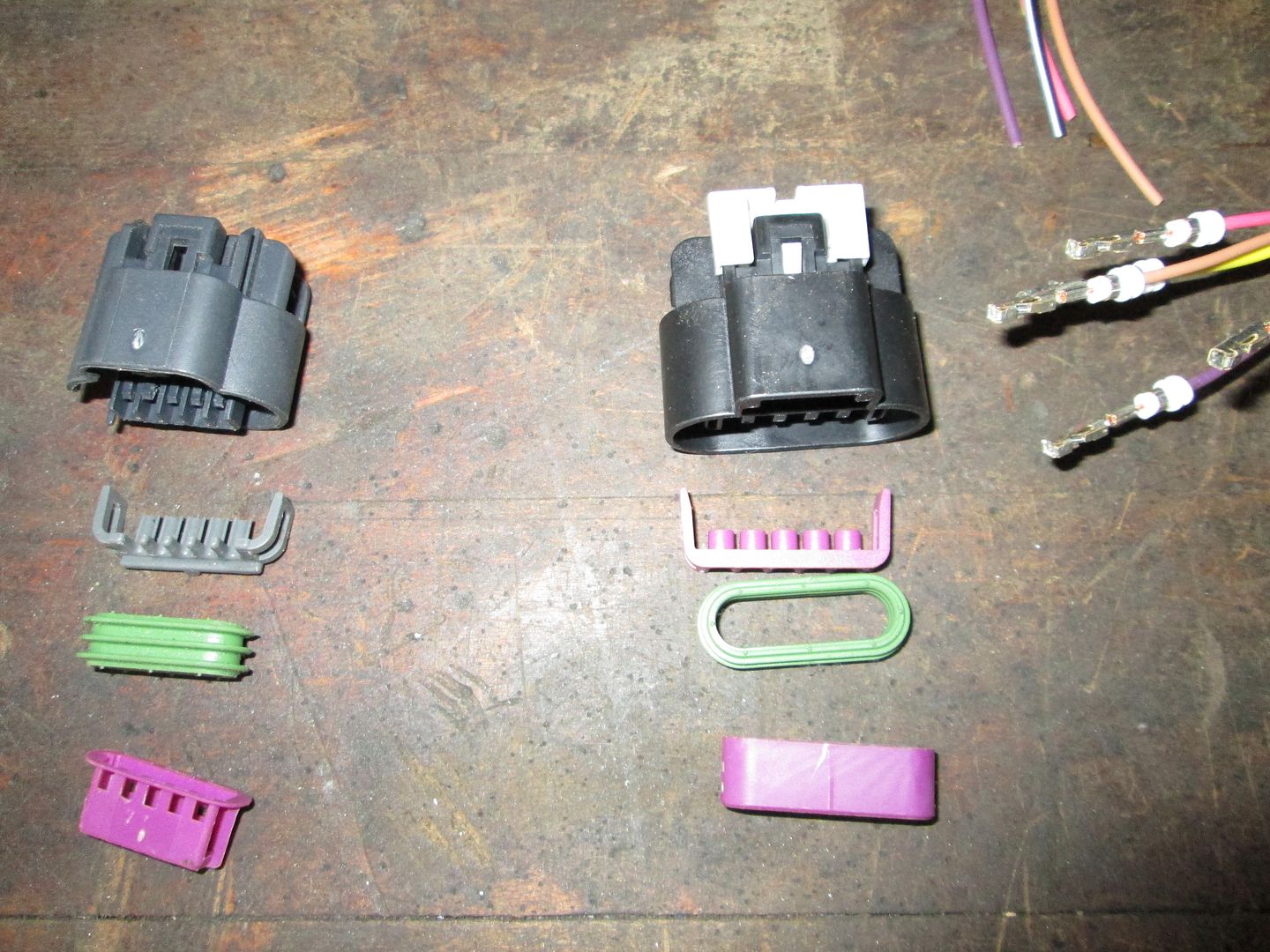

While letting the tube dry, it was time to swap out the connector end since they were different. The good news is it literally is just swapping out the connector end. Here are the two connector ends (LS2 on the left, LS7 on the right). Each one was opened up, the terminals released and pulled out of the housing:
thanks for posting the pics of the connectors apart, I had to do something similar working on my swap today and it was helpful!

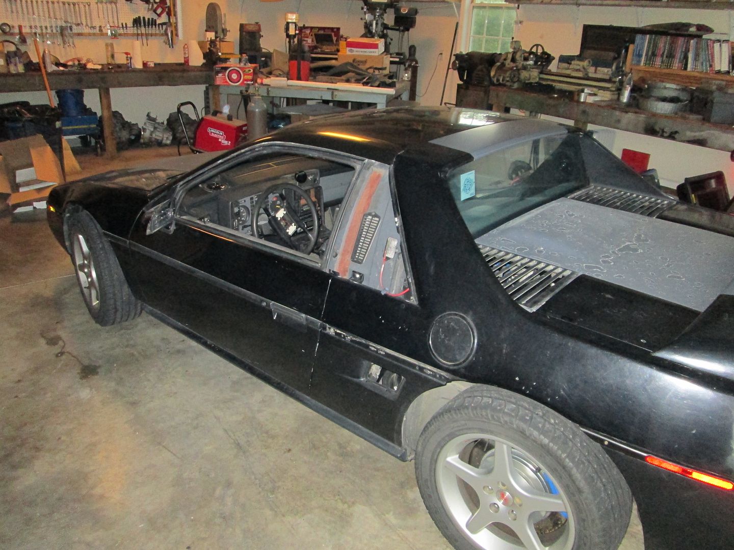

Dragged home a quasi-twin to my daily driver. Its an 86 GT/auto with painted ground effects and my DD is an 88 GT clone with 2.5/125C. The wife imposed a 2 Fiero limit 7 years ago when we moved to KY, but occasionally I go over it for a while and live to tell about it. It will be used for R&D purposes as an 84-87 example.
The LS4/F40 car decided is was being ganged up on by the red cars, so it retreated to the garage for some wiring mods for data collection of the CAN signals between the ECM and TCM.
