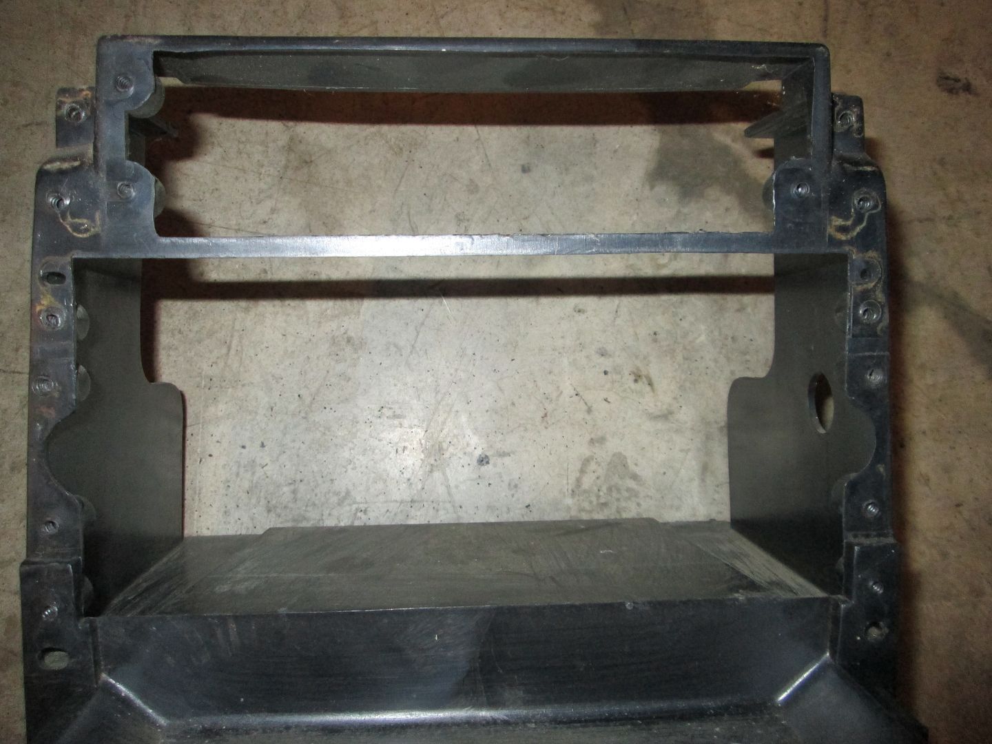

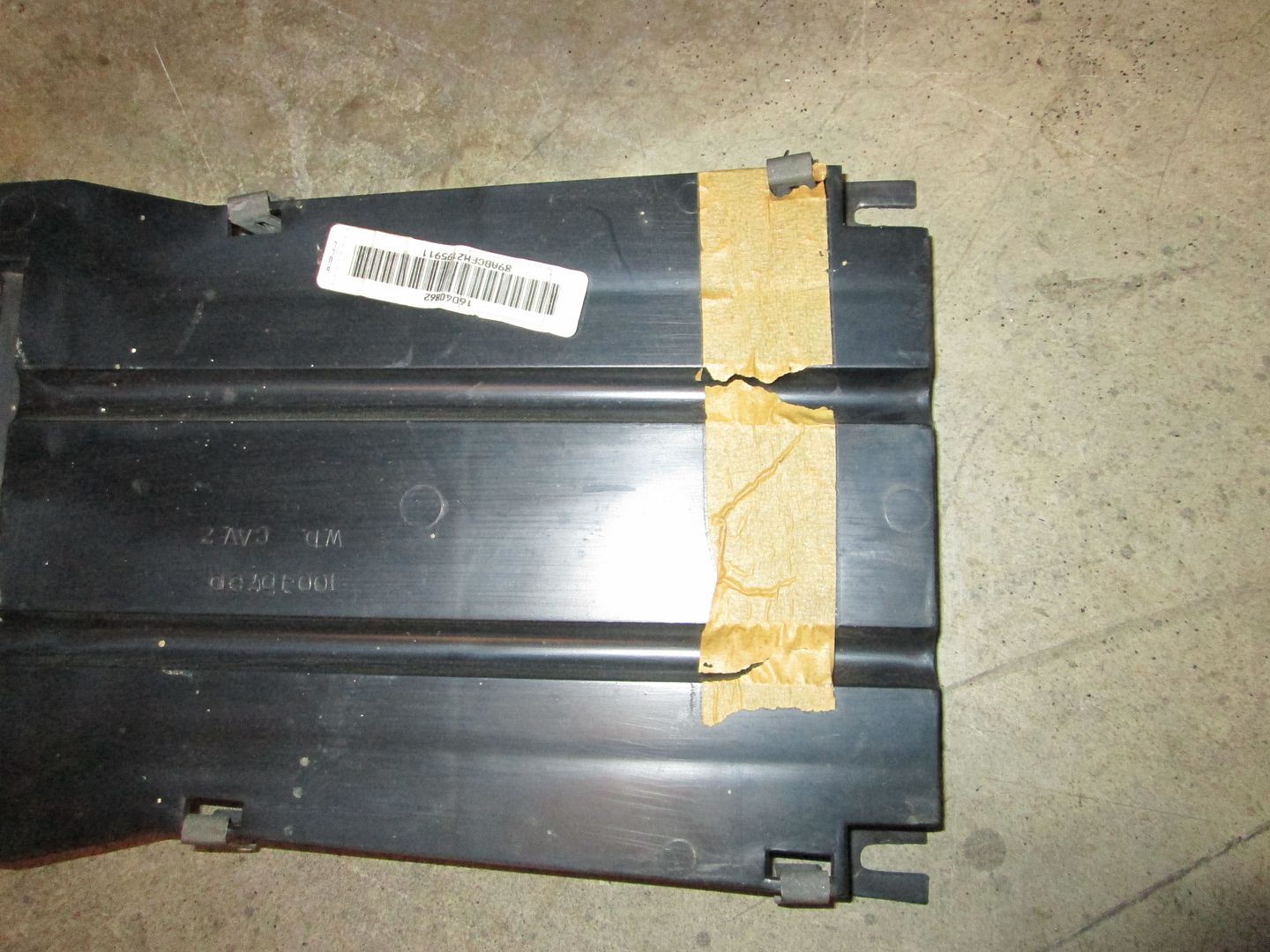

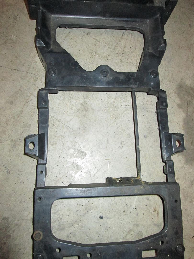

Its been cold an raining for the last 2 days, so the car has been back inside and I have started to put the interior back together.
When's the last time to saw one of these without any cracked or stripped holes...
Perfect time to make a mold or 3D scan...
It might be nice to reprint these with a 3D printer someday...

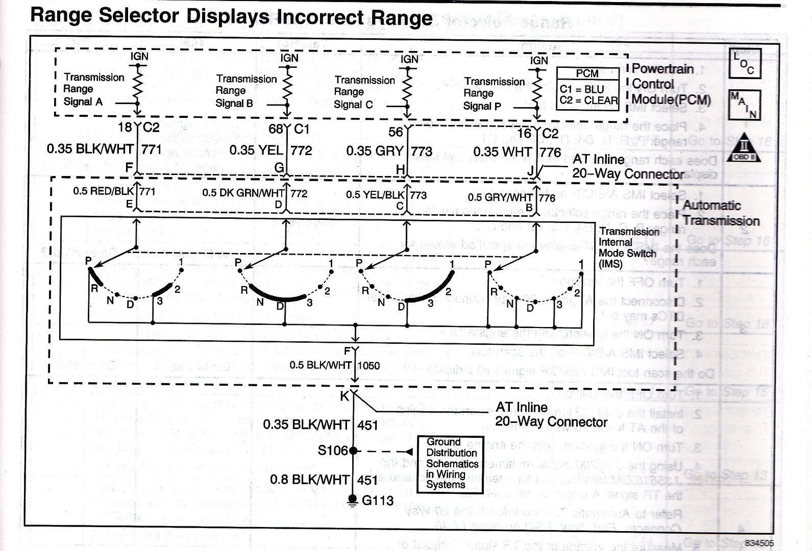

I also found an error in the Range Wiring...
Signal P is always open for every gear and how it is currently wired, so no change needed.
If you look closely at Signal P - it does indeed change states and is grounded in P,N, 3 and 1... so I need to add a N.O. clutch switch for this signal as well. My current Clutch/Starter switch (which is N.O.) has 2 plug connectors, but the 2nd one doesn't have any terminals in it. So I purchased another one (NS88) that isn't a direct fit (terminal connections the same, but doesn't have the mounting bracket), but I should be able to take the two apart and build the one I need.
