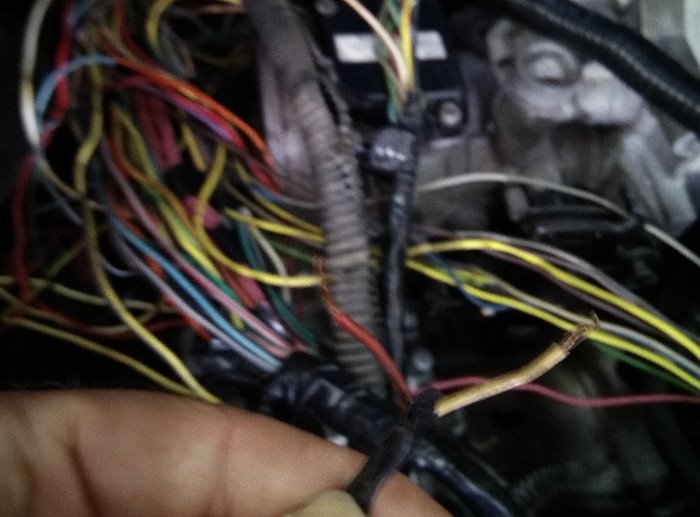

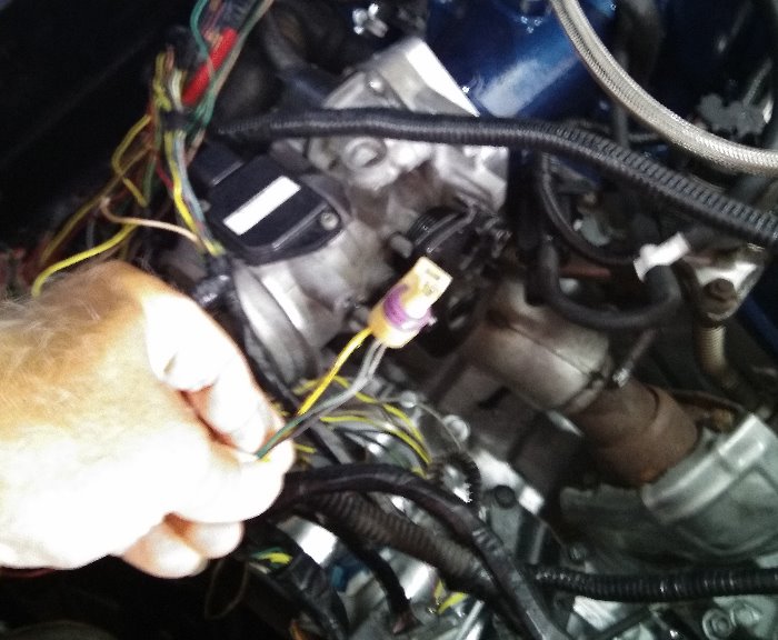

The mechanic started to take the tape off of the wiring harness, and many of the wires that were attached by barrel crimp connectors, just came out of the connectors. They were not fastened / crimped well, and just the tension of taking the tape off the harness is pulling the wires out of the connectors. Next, he was able to find the yellow wire that is SUPPOSED to go to the temperature sensor, it was somehow routed to the A/C pressure switch.
The 2 wires that are supposed to be connected to the temperature switch are supposed to be yellow and..... damn, cant remember the other color. Anyhow, the yellow is the correct one on the computer end, just that it routed to the A/C pressure switch mid harness.
He is still trying to find where a couple of the other wires from the computer ended up. When he is done, he tells me he will solder and shrink tube the wires correctly.
After taking off the tape and wire loom, he found the yellow wire coming from the computer, meant to go to the temp sensor, it was going to the A/C pressure sensor instead:
Here are couple wires that came out of their barrel connectors when taking the tape off of the harness:
