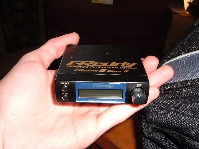

FastIndyFiero
OCT 07, 04:42 PM
 Greddy Profec B Spec II.

Is that a boost controller? Sweet... FastIndyFiero - I have a few spec sheets for the superduty as well as parts lists and even blueprints. If you interested in these let me know and I'll scan them. Here are the spec sheets for my SD as asked. 3.3 Liter/ 193CID 12.8:1 compression Supposed to be a tad over 300 HP not sure about torque figures.
