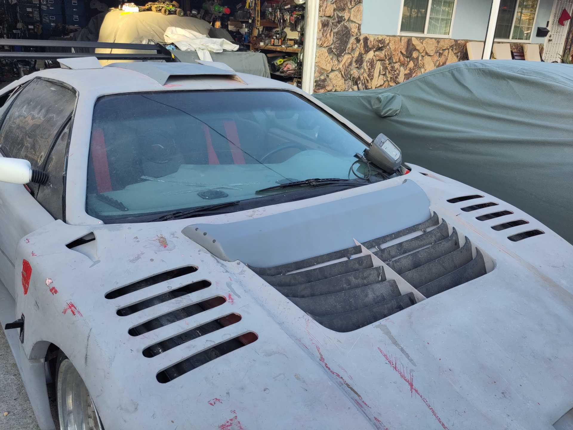

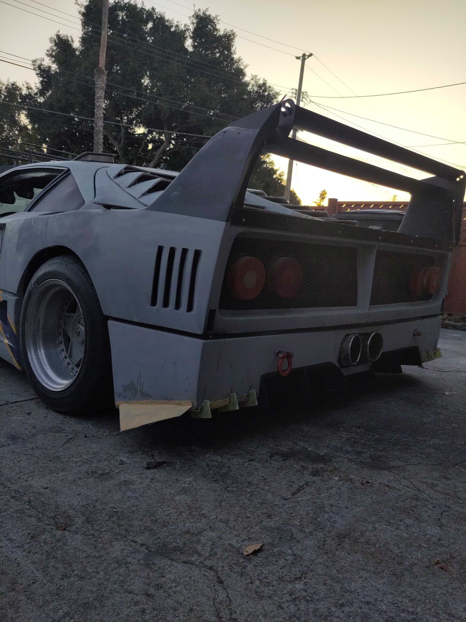

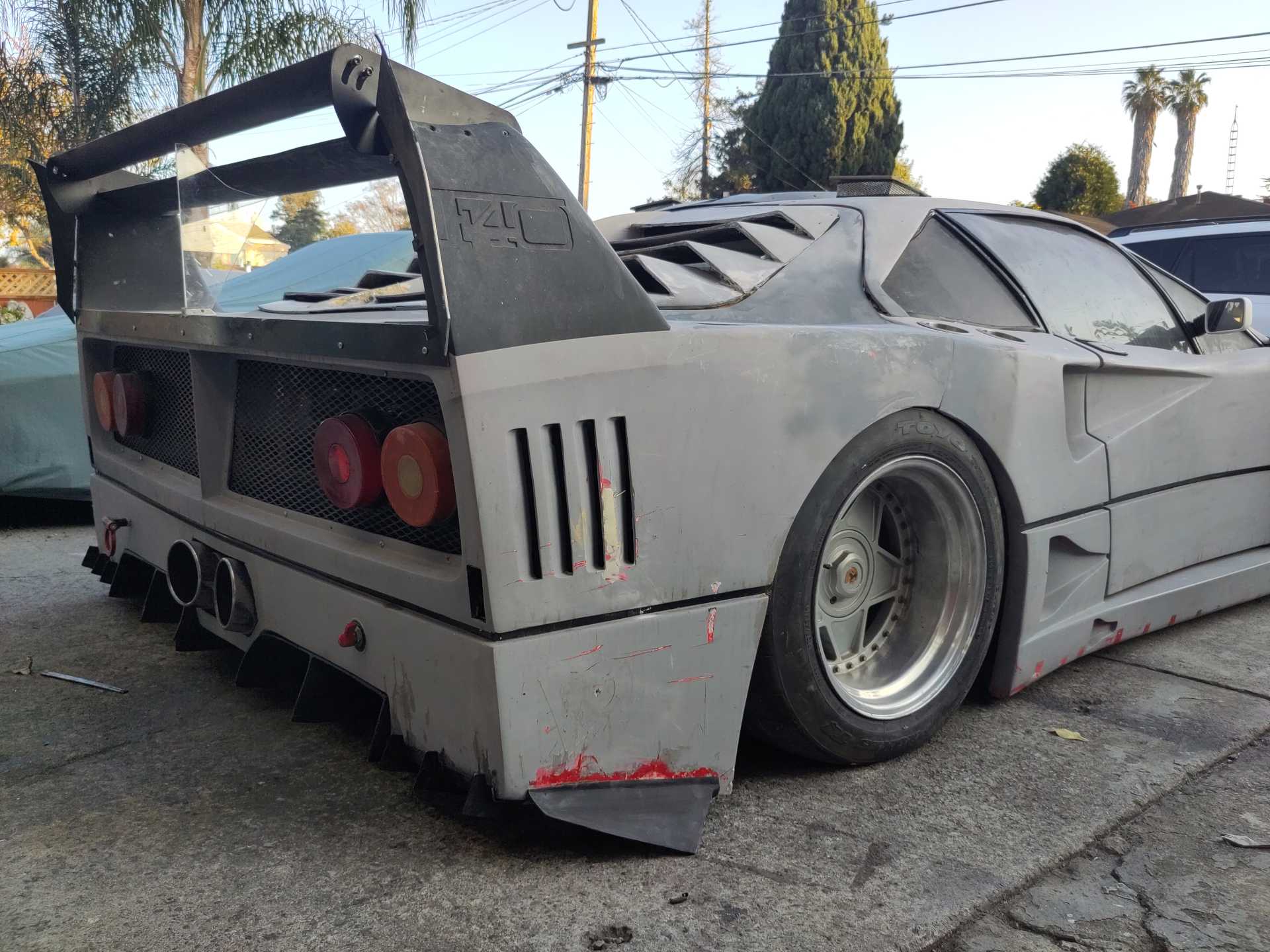

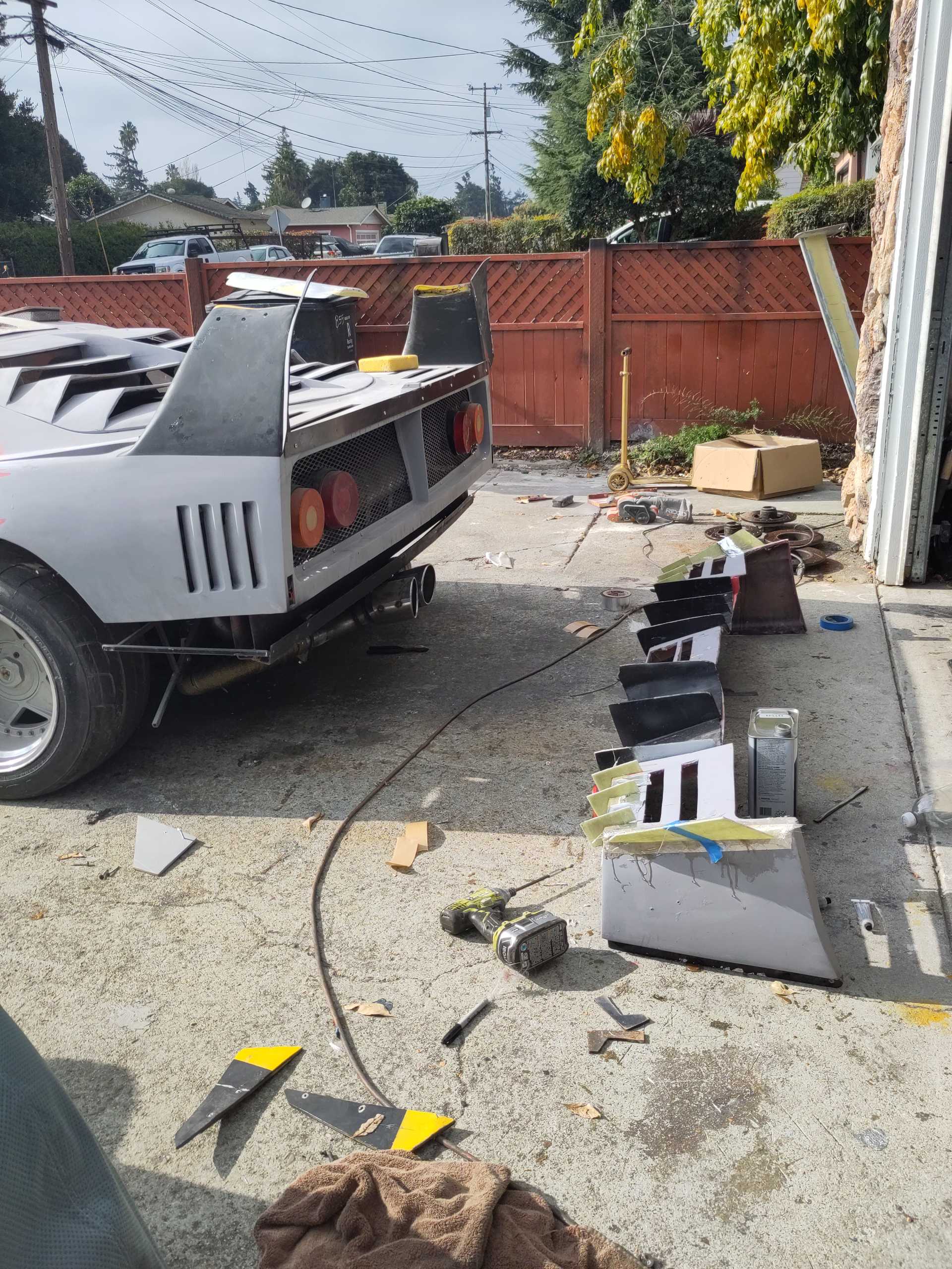

Ive been busy on this, and have many more idears in me noggin. Finished up the glasswork on the roof scoop and hood scoop scoop. Ground down the welds and got the rear wing ready for primer. Wrapped the exhaust in that fiberglass tape I bought years ago, lol priorities. Pulled the rear bumper and made the lower wings and diffuser tips outta glass, lower wing tips touch the ground when slammed. Got side skirts on the way, rear louvers are glassed on the underside now too. Bottom section broke off, so that got beefed up on both sides. Still got finishin to do on that.

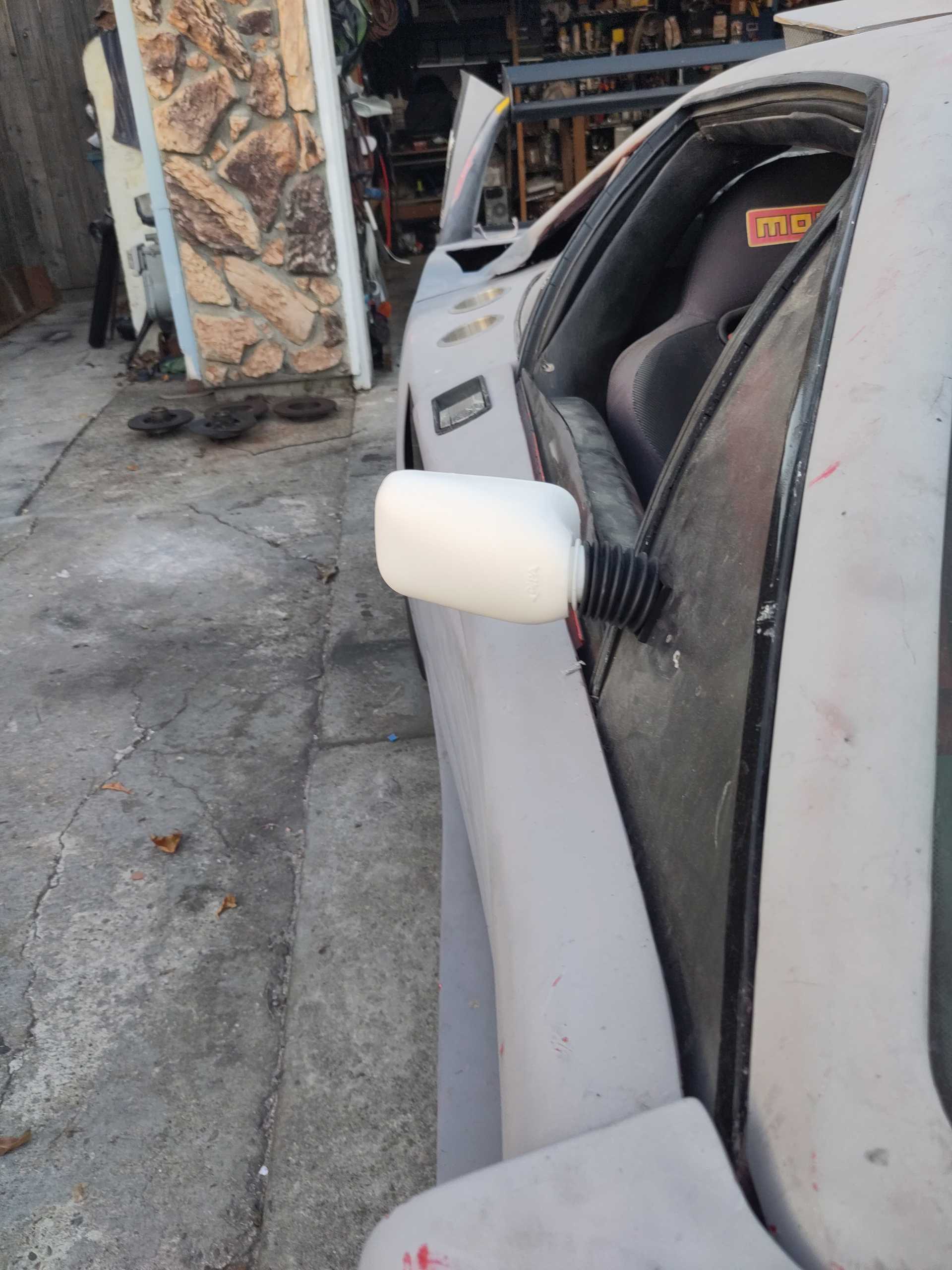

Also got my side mirror situation figured out, found some universal pwc mirrors. Looks good and provides much more vision than the vitalonis. Moved them as far back as possible on the window, only a teeny bit is covered from the passenger side. Ordered them about 5 times, I kept getting right hand mirrors sent regardless of part number. Finally got a drivers side one the udder day, ones white and ones black.
Finished up the quarter panel to hatch areas, and the gap is nice and toight! So now the roof to hatch gap is unbearable at about 5/sixteenfs- so Ima glass it back together and cut the line, again lol. Hopefully for the last time. Finished up the rear camera mounting and wired it to a switch. Put insurance on it and found a shop to do the brake and light inspection. Gonna take it for a shakedown cruise sometime next week before taking it to the inspection.
