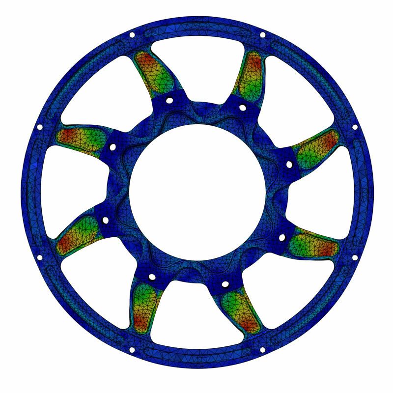

CATIA actually. Most of the analysis I've done in CATIA as well, which uses a fairly fully-featured ABAQUS solver. Some analysis I've done with ANSYS and PATRAN/NASTRAN. Most of the pretty pictures I post here are from CATIA. Here's a screenshot from the flywheel stuff I was working on last year. Last year? Scratch that, 2011. WOW. Okay:
That's a combined loading scenario, showing 12,000 RPM (3K over-rev) as well as an angular acceleration equivalent to a very harsh clutch engagement or missed shift. I think it was something like 800,000°/s². Anyway, I have a lot of fun doing this, and unfortunately there's a lot of analysis and pictures that unfortunately I have been too lazy to post. I'd be happy to send you some models and scenarios that I'd like to see and compare results.

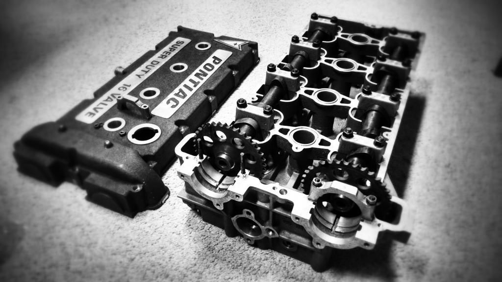

Thanks to these guys:
The *DOHC* Super Duty build is back online in a big, big way:
