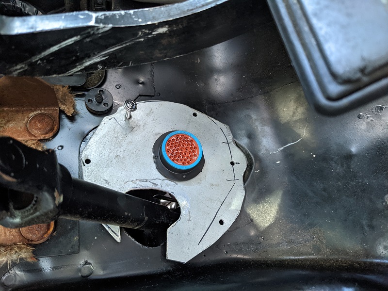

Mike also made the first fitting of the cover plate that will cover the steering column opening where we had to modify it a little to accommodate the connection to the C5 steering rack. This is also where we're going to have the wiring from all the FAST components coming in. Not sure what Mike has in mind for routing the wiring to the rear bulkhead where we will have another connector there as well. I suspect it's going to move from the steering column area and and snaking through the armrest area with all that other wiring.
I'm going to look into some rubber sheet or something to make a 'cone' from the metal plate to the steering shaft, to help keep water from getting in.
