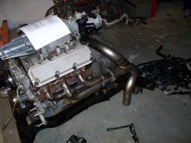

Brief update:
Dean has finished the headers and they have been sent off for powdercoating.
It is my understanding that he has made a jig and will be reproducing and selling these.

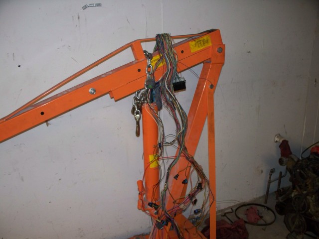

The wiring is what is being tackled currently.

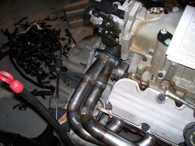

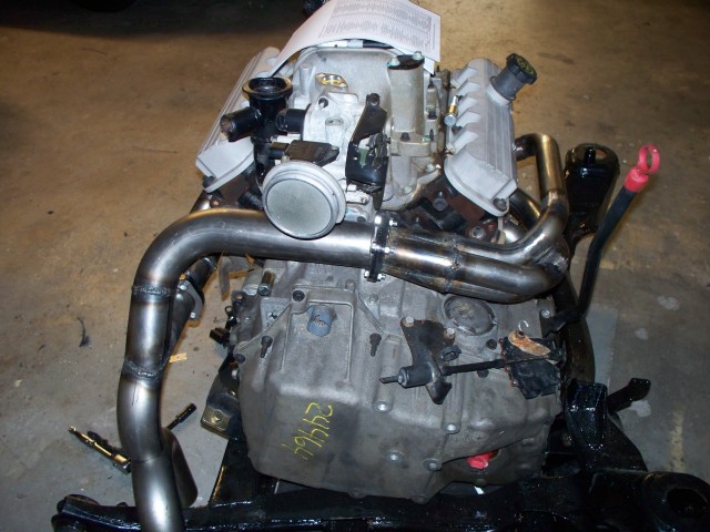

Blacktree SEP 26, 12:19 PM
Those headers look interesting. Do I see twin outlets on the bottom?
doublec4 SEP 26, 09:02 PM
Nice headers! I really wish someone would make aftermarket sets for the fiero that eliminate the crossover.
whodeanie SEP 29, 10:28 PM
LOL! I was waiting till someone cought that. no that is not a twin outlet I was just using a U bend to hold it in place to get a pic.
as far as doing a set without the crosover I can do them but this way works better.

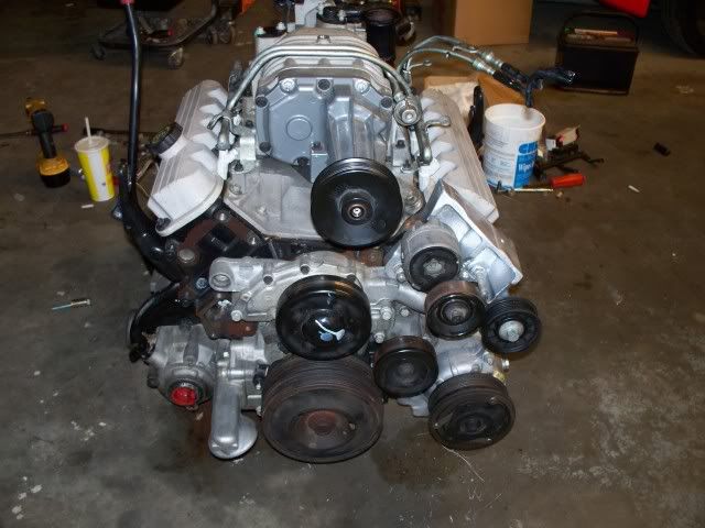

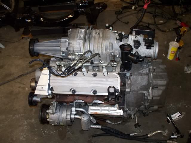

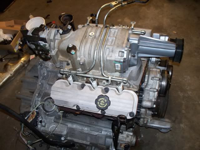

Update on the car today we did a bit more work on the motor. we got the bolts to install the trans all the way as well as a lot of other parts that did not come with the setup.
Motor mounts, fuel rails, tenisoners, coil mounts, AC compressor, trans tail shaft mount, alt. and much more. I ordered a low mount alt. set up that I will be getting soon.
also the headers should be back from the coater some time next week. I had them coated using a new color that will look great and will not look like others out their, I will post pic's once I get them back.
we also installed the new injectors and a stock fuel rail but we did rebend the fuel rail so the fuel lines are going the way they should. we will be droping the fuel tank soon to install the new fuel pump soon and once I get the headers back we will be installing the motor for the last time. the wires will be routed in a way that will hide most of them.
more to come..
