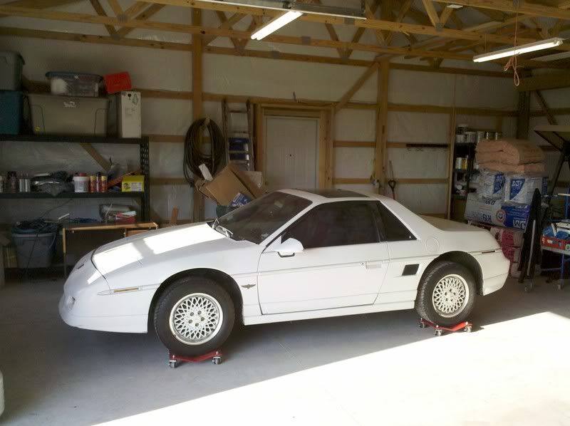

In other news, I finally got my car moved to my shop
