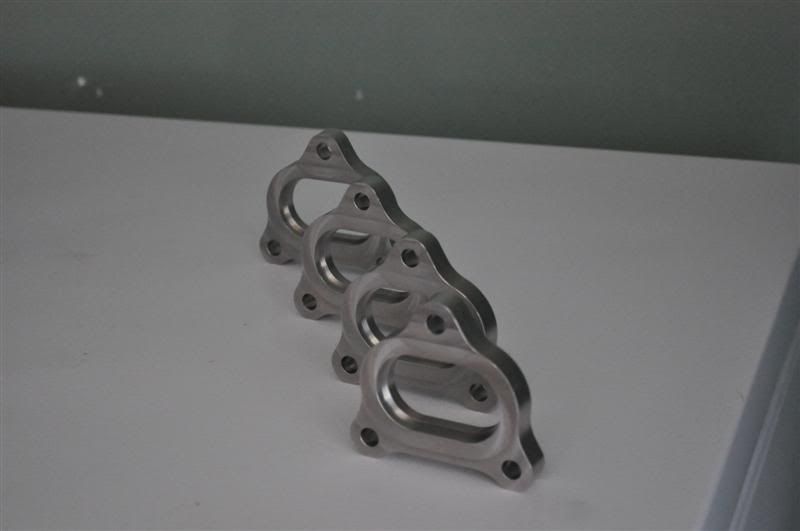

Last exhaust flanges done:

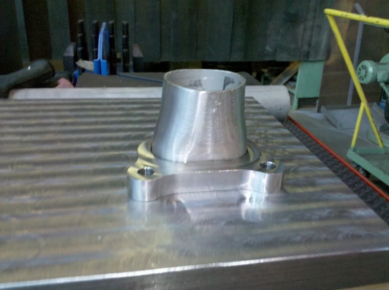

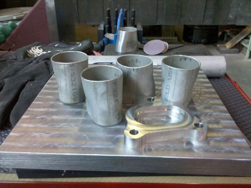

After finally tracking down someone who had 321SS tube in 16g and waiting to get it from SPD Exhaust, I formed the stainless transitions using my new mandrel, and they work great. Matches up with the flange and looks good to boot.
