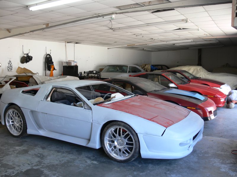

Today we pulled the old motor out
the cradle cleaned up with the power washer and ready to be preped for paint.
and the car the way it sets as of today.
more to come  D.
