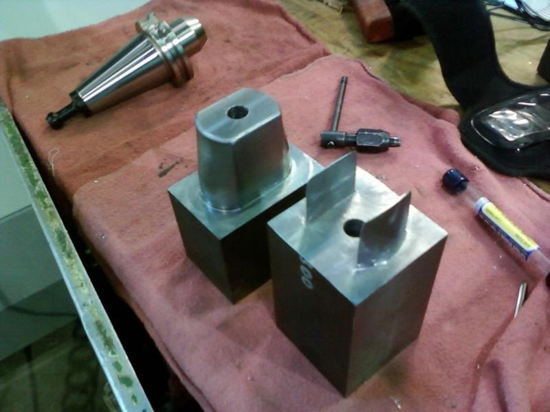

Almost finished with part #1 of the mandrel for forming the transitions.

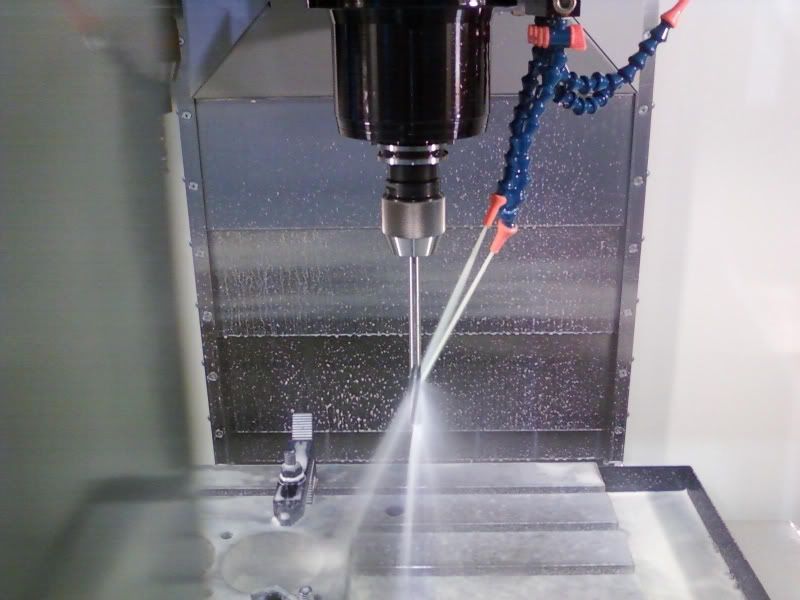

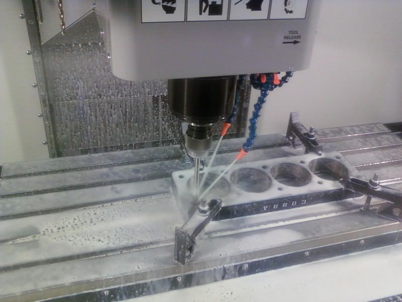

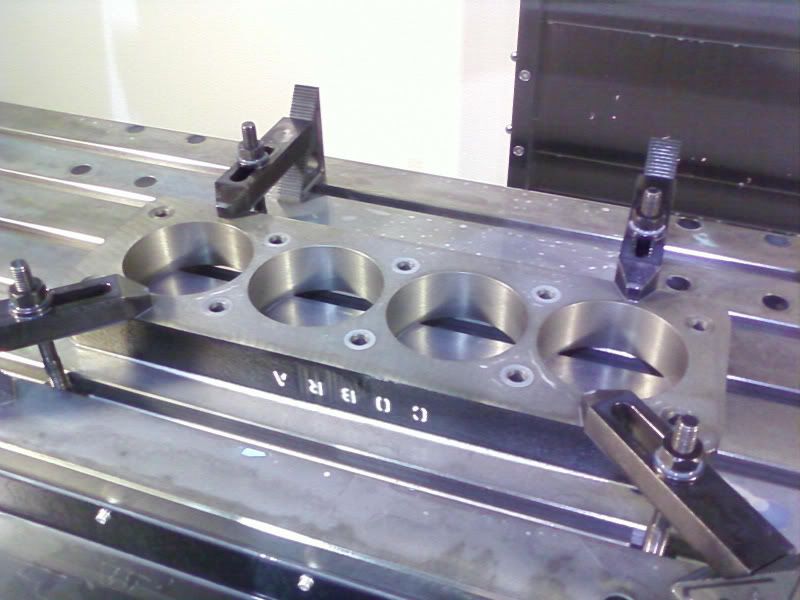

I don't have anything on the engine put together anymore...It needs a hot-block .002" plateau hone still. Which reminds me, I can modify my deck plate tomorrow.

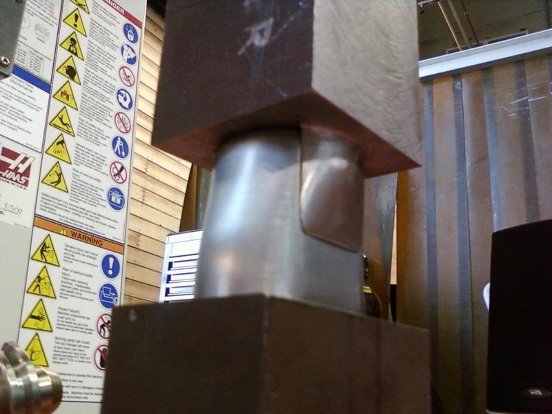

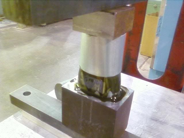

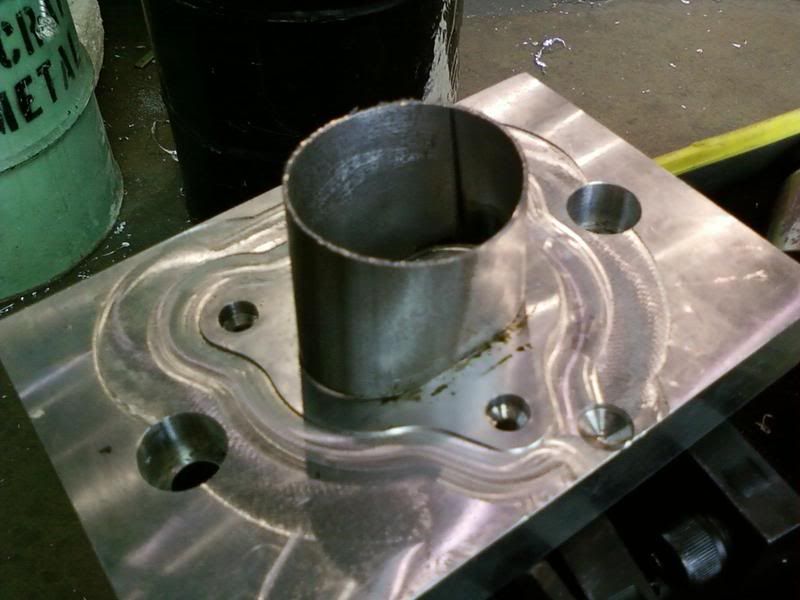

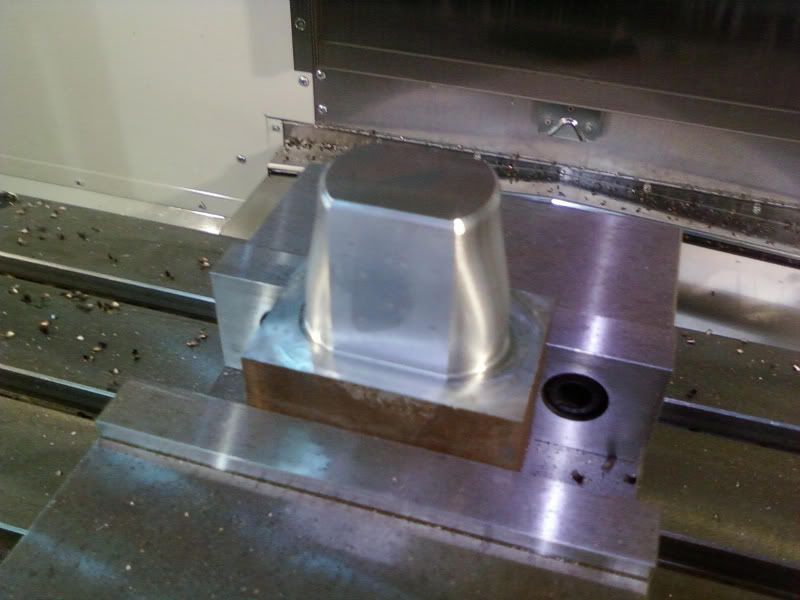

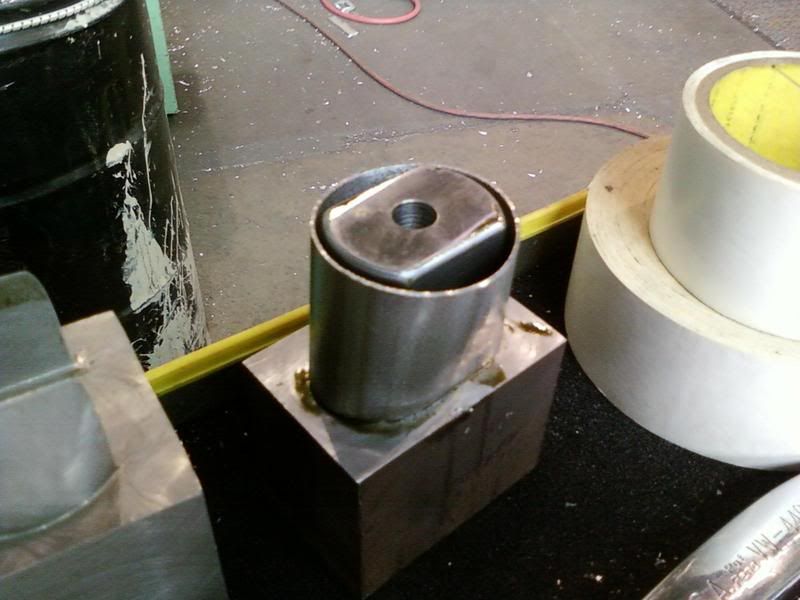

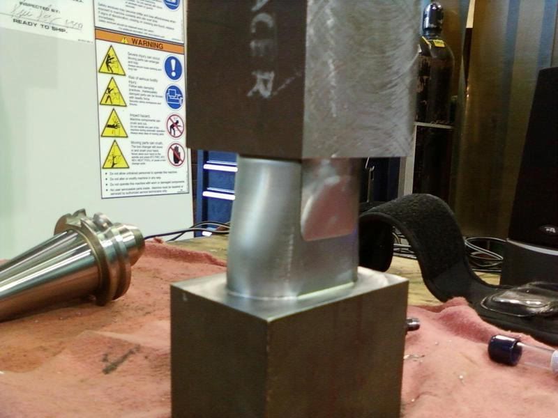

But, the day is not without progress. I used my mandrel to make my first transition. The tube size isn't proper though, apparently the O'reilly's tubing sizes are +/- 1/8". This tube is waaay too big. In the picture where's it's sitting around the mandrel, the top of the tube should be very snug up around it. Instead it's got about an 1/8th on either side. It has a thinner wall thickness than the real stuff too, so that didn't help. It did, however, prove my concept, which means I'll be ordering some stainless this week.
