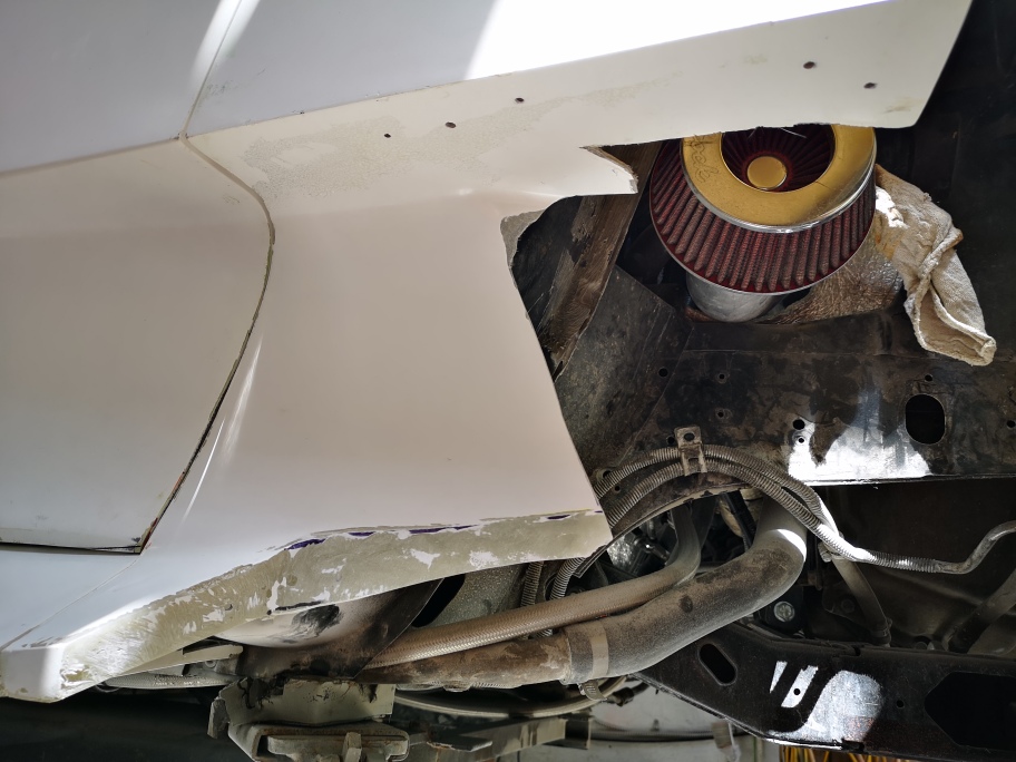

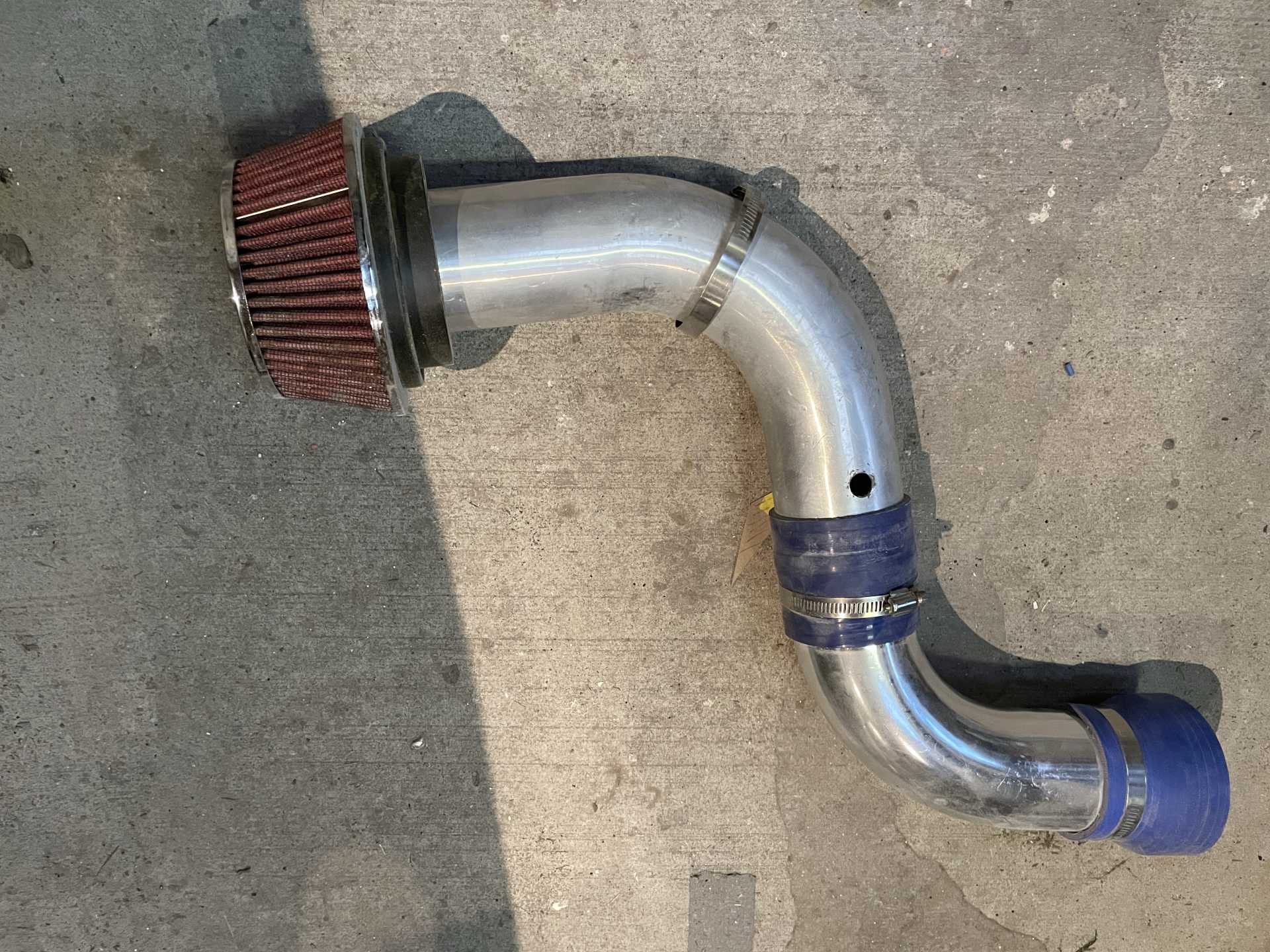

Dobie, what type of plumbing did you use to get the air filter located there. I am interested in doing the same location on mine.
dobie1 SEP 11, 11:48 AM
Hi Ace
I used two 90 degree 3” diameter pieces of aluminum intake pipe with a silicone sleeve too attach to the carb.

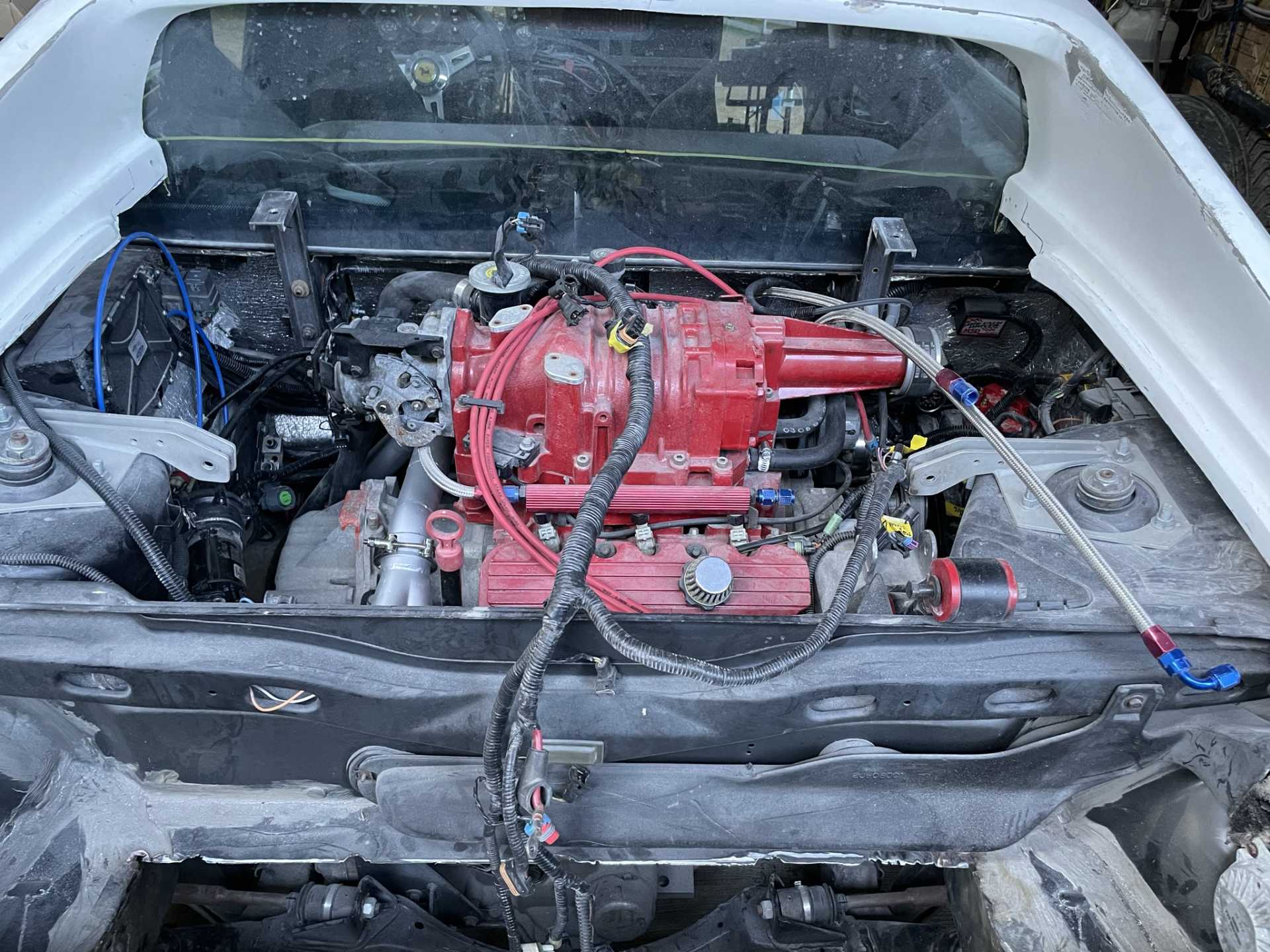

Here is a update for everyone.
I was able to come up with a design that worked to relocate the PNP safety switch away from header.
I cleaned up the engine compartment running all the wiring away from the heat of the header and reinstalled the fiero heat sheild, I’ve also reinstalled the engine and am hooking up all the plumbing.
I’m hoping to get back to work soon on finishing the read hood plug, I can then make a mold a finish the final part to complete the car.

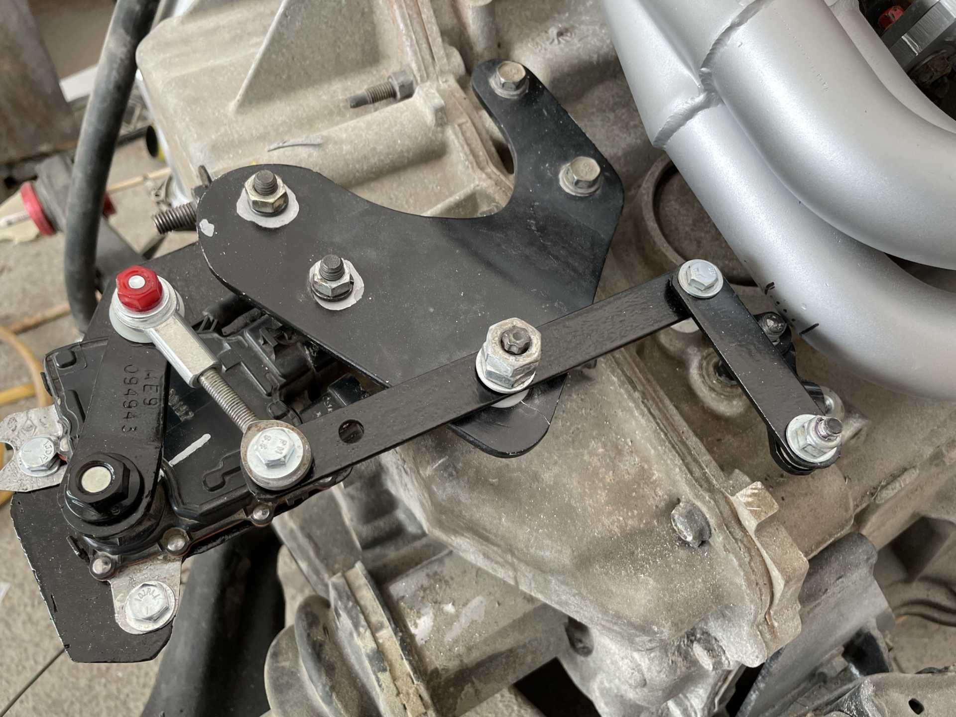

And one thing that has taken way more time than I imagined was the relocation of the PNP safety switch. I had found the problem when I was installing the headers , the switch was to close. I took some measurements and made a relocation plate, but because it was out of the car I screwed up and when I attempted to reinstall the engine nothing fit. So with the engine back in I took some actual measurements and found I had to mount the switch on the side.
Hopefully the pics will answer any confusion you probably have from my babbling.
This is before
And this was the reworked relocation

That is pretty damn slick what you made for the pnp switch, very very cool! Looking forward to seeing the car together, keep up the awesome work as always! why sell the molds? Will you make a body from the molds before you sell them?
