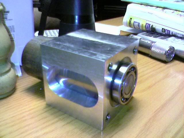

While work starts on prototype throttle #2 housing, branches to different parts on proto-throttle #1:
Seeing this reminded me of an article I seen in an old hotrod mag where this company was doing an experimental head for a Ford 5 Litre engine where the valves were removed and something similar to this was installed in a brand new casting. They had a stock black and rotating assy spinning at 10K RPMs! Never heard anything about it past that. I hope someone seen the same article I did to verify this.
FastIndyFiero SEP 18, 04:43 PM
I think I know what you're talking about. Is this it?
http://www.coatesengine.com/csrv.html
Here's a link to a slightly more complex, but REALLY cool system:
http://www.v-eight.com/mult.../pdf/AutoTechBRV.pdf
The problems I have always seen is 1) maintaining seal integrity, and 2) Flow inefficiencies through partially opened valves. Fix those, put 50 years on the design, and you've got a pretty good system.

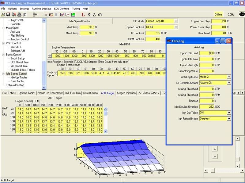

So I've found another ECU that looks like it will work best for my needs. Best mix of ability and price. It's the Link G4 Xtreme. I downloaded the tuning/interface program and have been playing with it for several weeks now. It's extremely intuitive, and easy to set up complex details, assign inputs, outputs, edit maps, do everything that needs to be done. By far the best tuning interface I have ever used. Has alot of inputs/outputs, can do VVT, sequential injection, COP, traction control, anti-lag, etc. AND it's about $1400 WITH harness. This is much cheaper than many other equivalent products.
http://www.linkecu.com/prod...lder/g4xtremespecjpg
I'll post up some shots of the software later.
