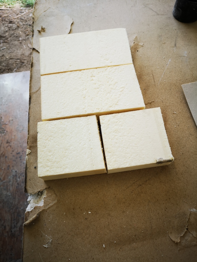

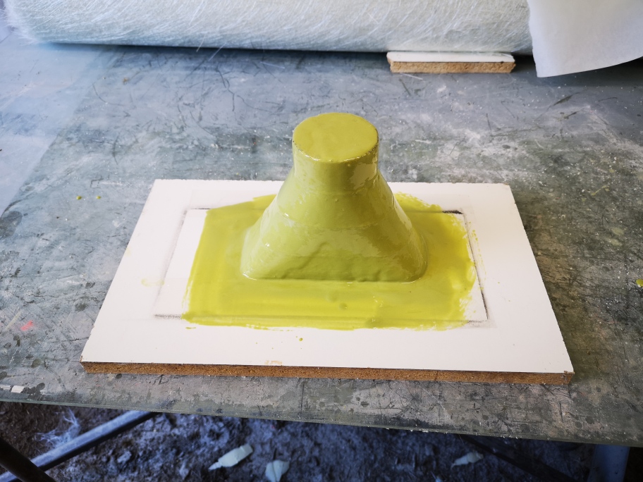

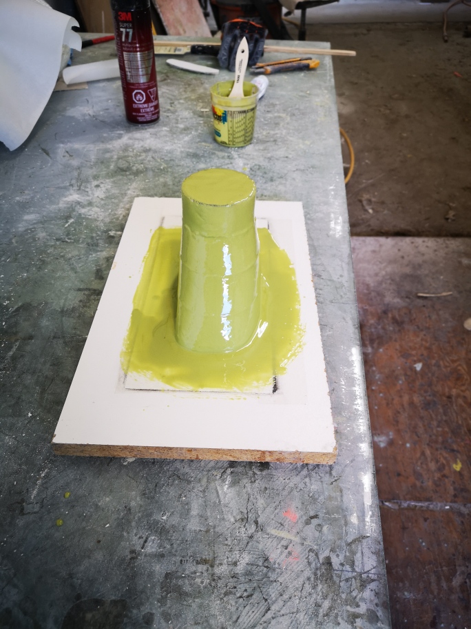

I was able to get a couple things done on the car. I needed to build a inner collector for the upper and lower scoops , the one I built will be able to be used on both left and right sides. I thought some of you might like to see the full process from start to finish on the mold. I tried something new in this mold adding a air valve to help in the demolding from the plug.

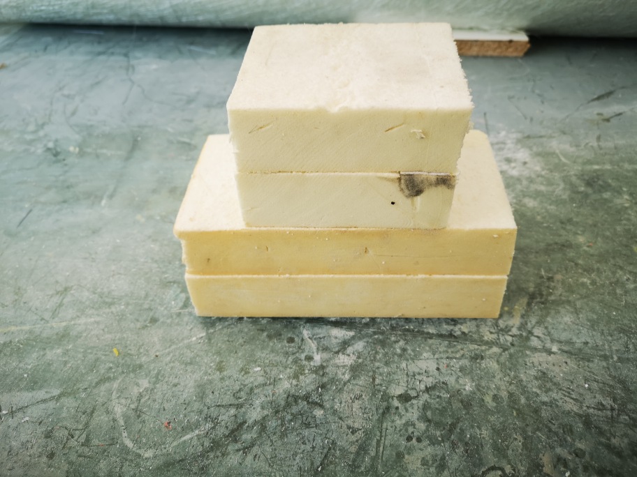

Starting with foam blocks
I attach them together using super77 spray glue

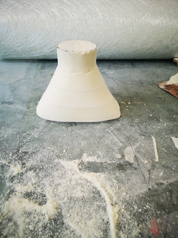

I carved and sanded the foam to the shape I wanted

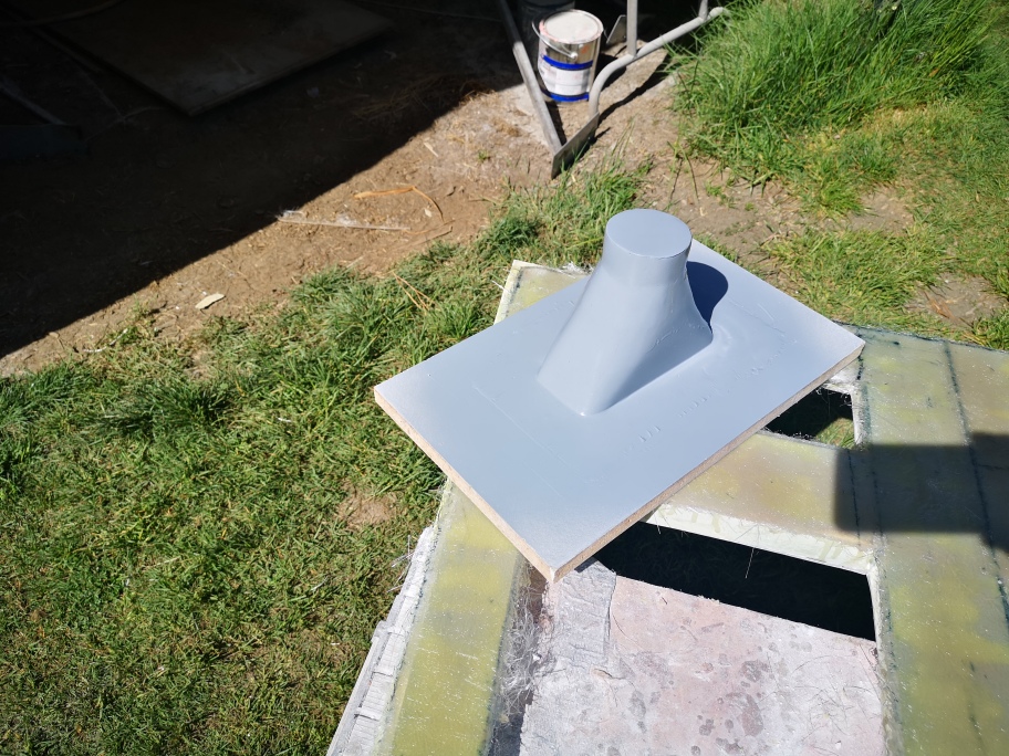

Then attaching to a piece of melamine board , I painted the foam with a coating of Rondo. I let it completely cure for a couple hours and sand to a 220
Grit finish.
Then sprayed with 2k primer

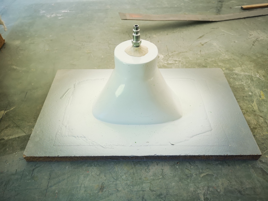

Then sprayed with with white single stage paint and using clay to seal and attach a air connector .
I then did a normal fiberglass layup on the part
A couple days later I attach a air hose to the connector and opened up the valve and the mold just floated up off the plug.

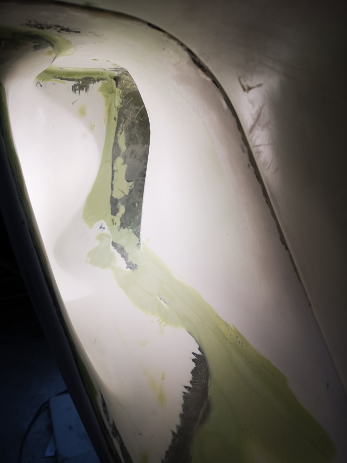

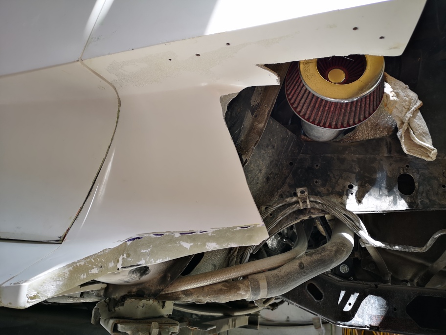

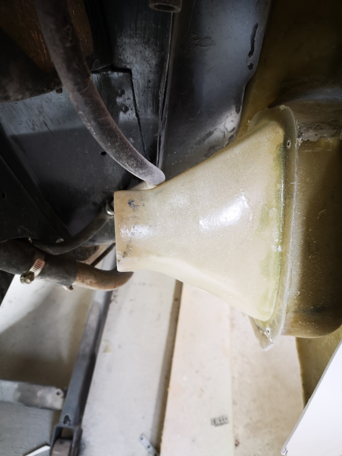

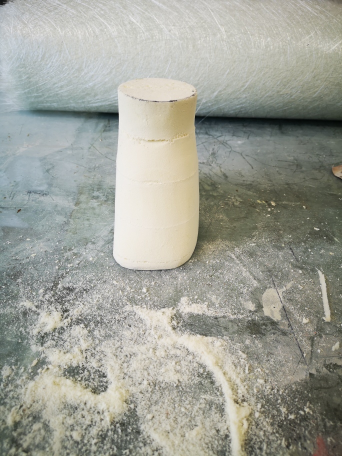

I have been working in between family distractions, and I was able to finally finished the upper and lower inner ducts .In My last post I had built a mold to build the inner ducts , I had hoped that the new duct could be used on the upper and lower ducts but unfortunately they didn’t work as planned they were to large and shape was to different to fit the upper opening so I had to build a smaller versions. I built and finished them using the same process using rigid foam to carve to shape.

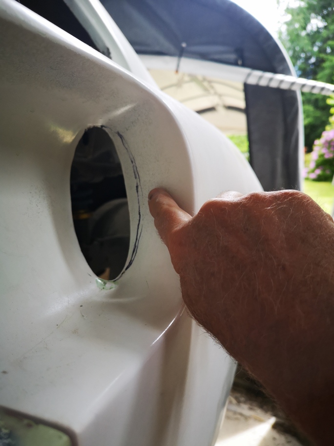

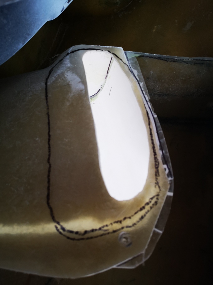

While going thru the process installing the inner ducts I discovered I didn’t like the way the forward part of the wheel-well finished and looked. So decided to modify it at the same time I installed the lower duct. After the all the mods I permanently attached the outer scoop in place.
Here is a shot of the old opening and the enlarged one for the new duct still needs to be cut out.
After a bit of body work on all the glue joints it’s ready for finishing.
Attaching and keeping the upper duct in place while the glue setup was a bit of a challenge bungee cord worked out pretty well.
Lots of sanding and body work and All the transitions came out great. I also opened up the openings on the top ducks.

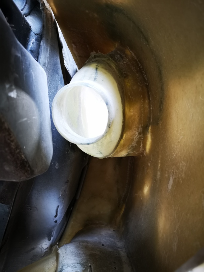

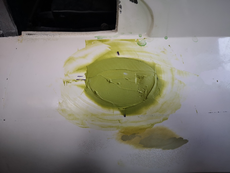

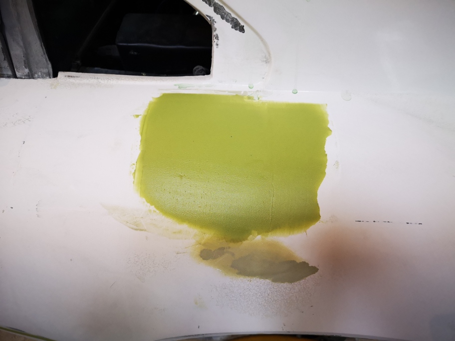

I’ve also started to install the gas caps , I started by creating a inner cap lip for the cap to sit on, I tapped the edges of the cap then took bondo and put a good bead of around the edge and seated it down on the lip to fill all the different contours.
The cap I’m starting with is correct but doesn’t have the fender curve that my car has so to solve this I attached it using hot glue . Then I
Put a coat of bondo over the the whole thing then sanded it to fit the curve.

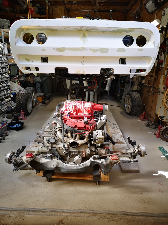

I dropped the engine and cradle the other day to do the final run of wiring and final cleanup for the engine bay. At the same time I removed the fuel tank. I’m replacing the expensive Holley High Performance external pump and going back to the stock location with a Walbro HP pump the only reason is that it was just too loud.

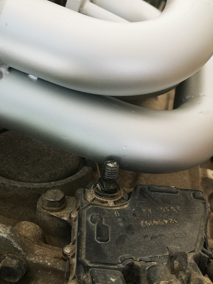

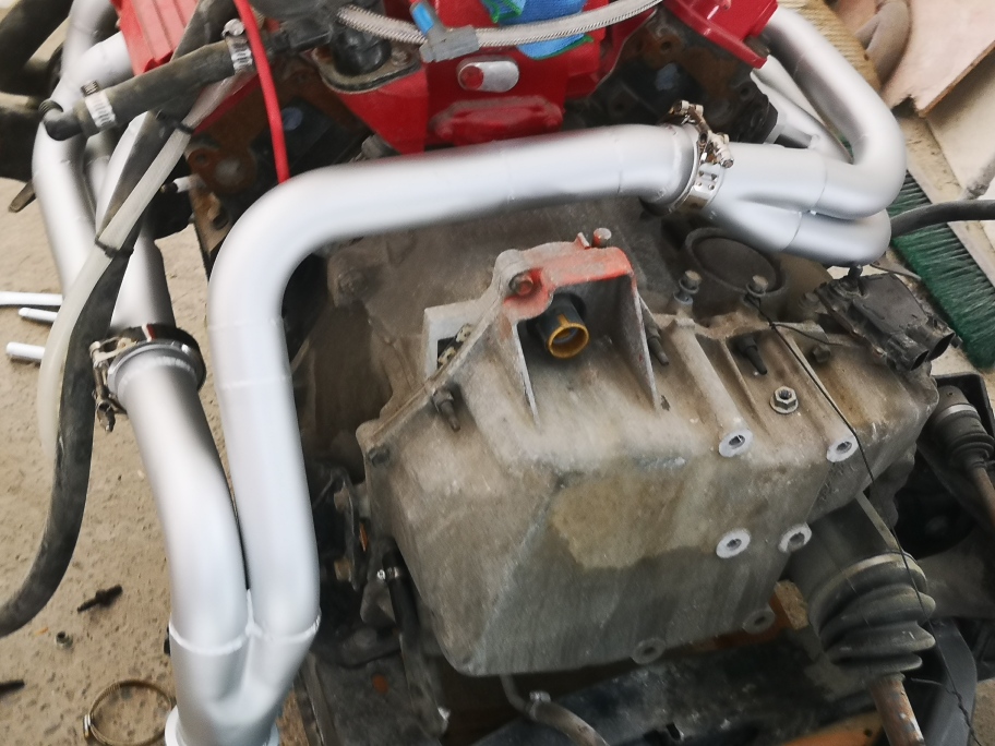

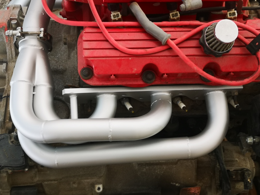

I also removed the stock 3800 exhaust that I Jet coated a few years back I was really happy with how much cooler it ran but the flow master muffler I was running which is the one used in most 3800 swaps was to loud for my wife to ever ride with me . Because the stock 3800 exhaust exits to the rear of the engine it limited muffler location.

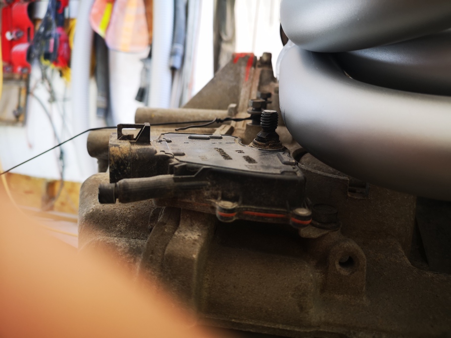

Don O gave me a set of SS headers he no longer needed I had them ceramic coated and luckily they dump in the Fiero OEM allocation and exhaust run. Everything mounted perfectly until I went to mount the transmission electronic shifter controller. It was just to close to the headers to safely leave . After speaking with Don I find out the headers we for a standard not auto , so I need to find a new location to make everything work safely.
The todo list just keeps getting longer not shorter, this is not the direction I want the project going but things need to be done right .

Yes I’m planning on relocating the Park neutral safety switch to the right and fabricating a new set of parallel shift levers that will shift the trans as well as positioning the switch sensor ring.
