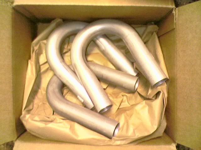

I ordered material for Cosworth intake #1. I've also been thinking about reviving my barrel throttle idea. It's been occupying most of my thoughts for the last month, I think I've had some good ideas concerning the fabrication and design of it; I also spoke to someone that fabricated their own barrel throttle for a Subie flat 4. I feel that I should develop a more traditional intake manifold first, to refine the tuning process. I'll post some details of my plans for intake 1 later.

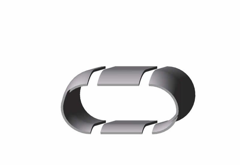

So here's the idea for the runners:
The radius of the ends of the ports is about 0.63". So I got some 1-3/8 tube to cut in half. Then I'll just weld two bent flats of aluminum between the two, and I'll have bent runners that are the right size without trying to form things the hard way, like smoosh round tube into ovals and try to bend that. Eventually I'd like to do carbon runners.

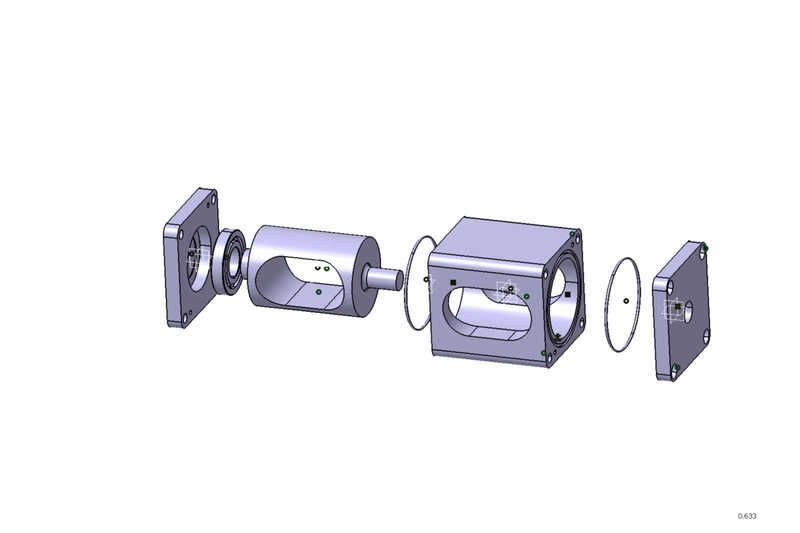

And, I started to put down a rough idea of what I'm wanting for the throttle, for each cylinder:
It has quite a few things left to work out, and some basic design still to be determined.

I've been refining the above barrel throttle, it's starting to look more like reality and less like a pipe dream. Only a minimal amount of work will have to be done on a CNC machine, which I don't always have access to. The rest can be done on a manual mill and lathe.

I recieved some of the parts (bearings, fasteners, o-rings) for my prototype throttle body, I'm getting pretty amped about that. No news yet about the timing cover and all that business.
