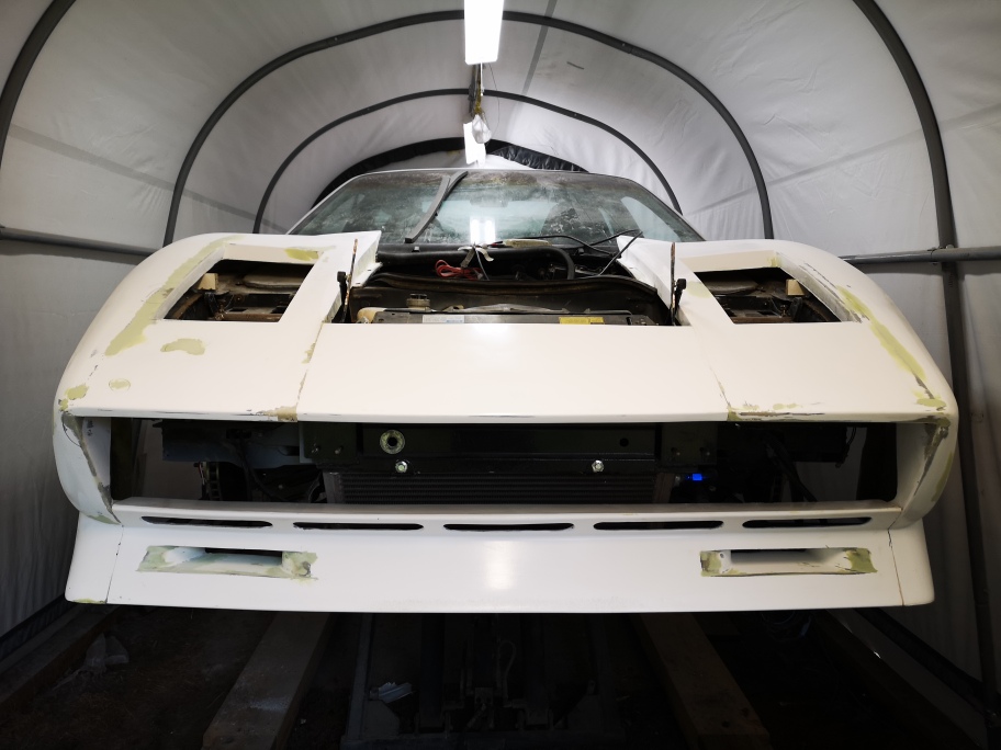

I got the front spoiler brake vents installed and sculpted the edges of the intake in the spoiler. Next I’ll shoot it with epoxy primer to seal it then spay a primer and do the final sanding before paint.

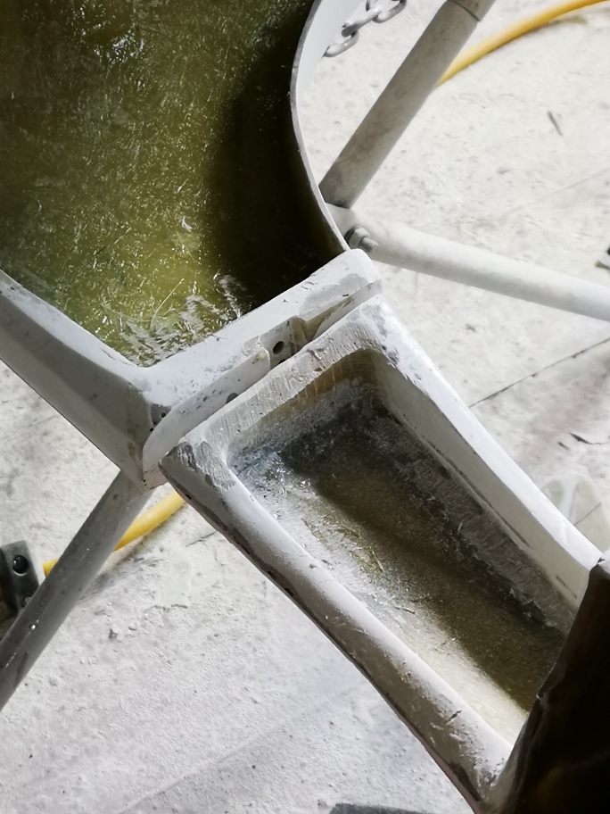

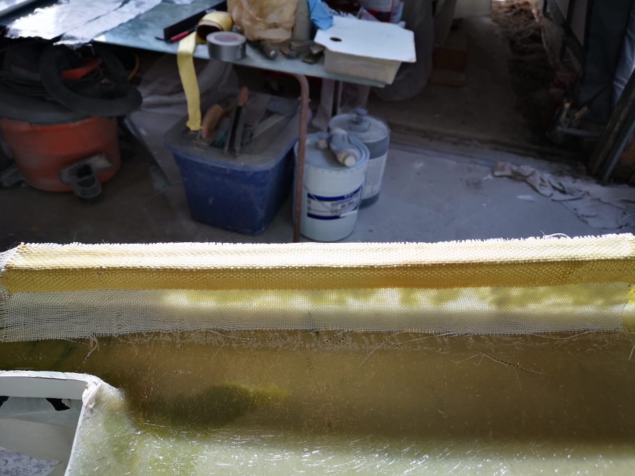

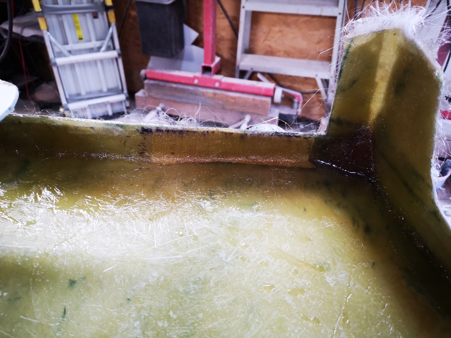

I’ve been busy prepping all the the molded parts I pulled from the molds the last couple weeks. Beefing up all the connections points.
Adding a strip of 1 1/2” wide by 7” kevlar sandwiched between two layers of 12 oz S-cloth topped with a layer of 2oz Matt.

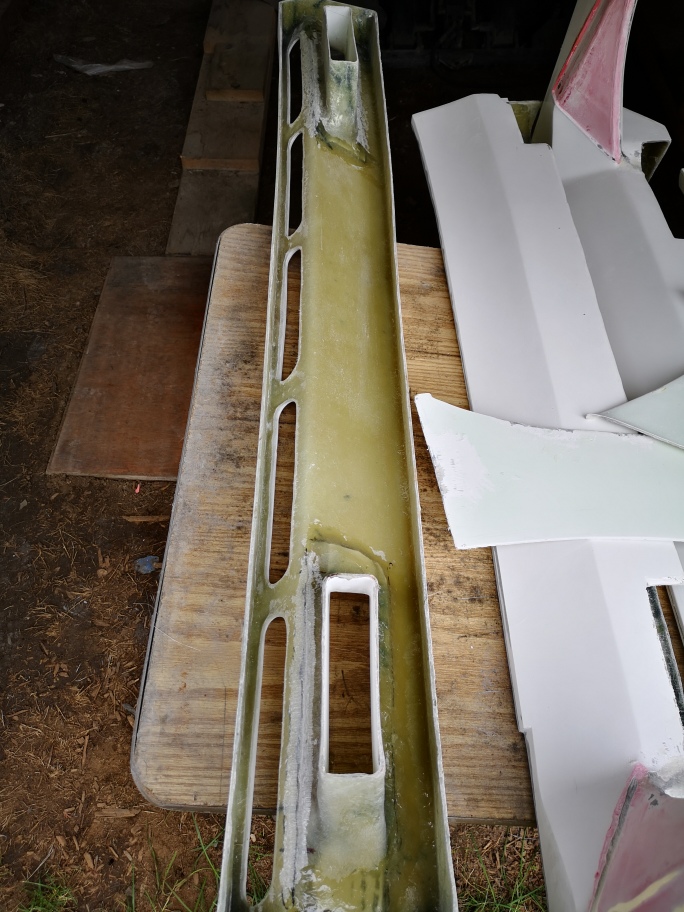

I also got the rockers completed using my slurry mixture filling the voids giving me a very strong part . I’ll cut out the area for the screen to be installed

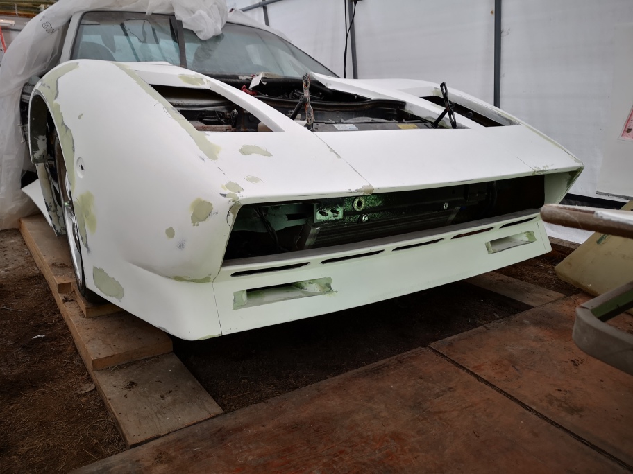

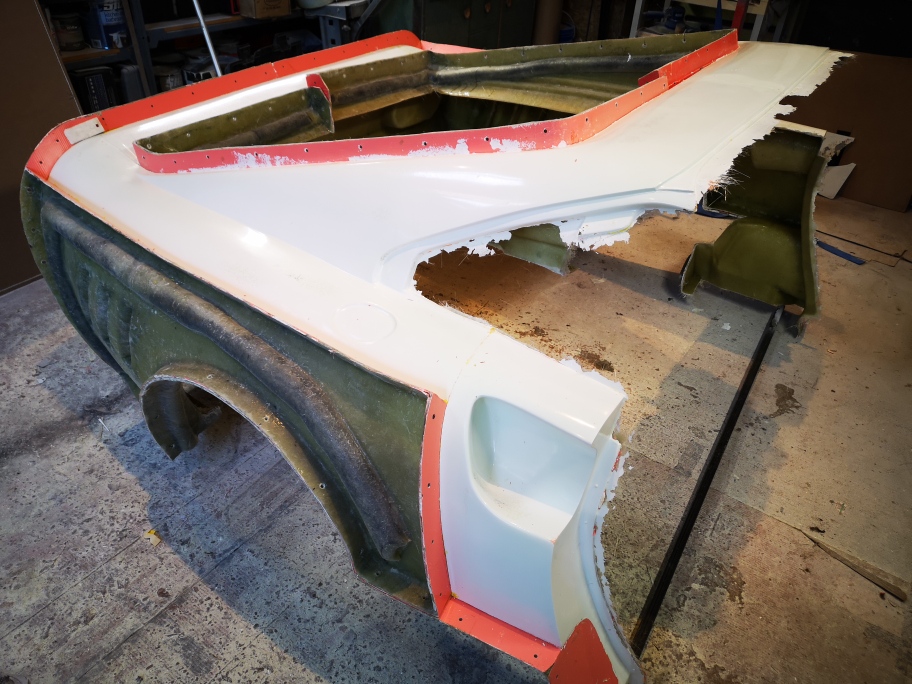

I’ve pulled all the parts from the molds and cleaned up all the slag, I’m found mounting everything while it’s off the frame is making processing and fitting the parts go very quickly.

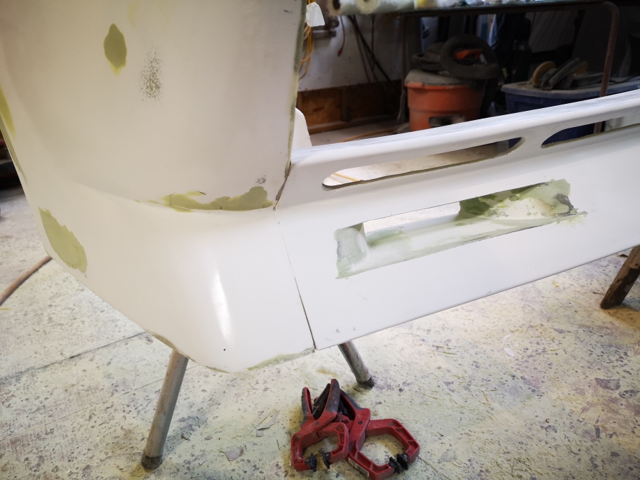

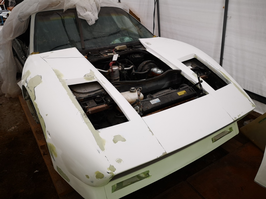

Mounting the front spoiler onto the fenders
trimming off the excess

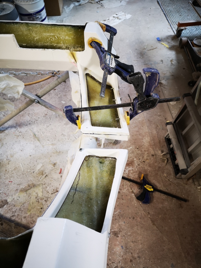

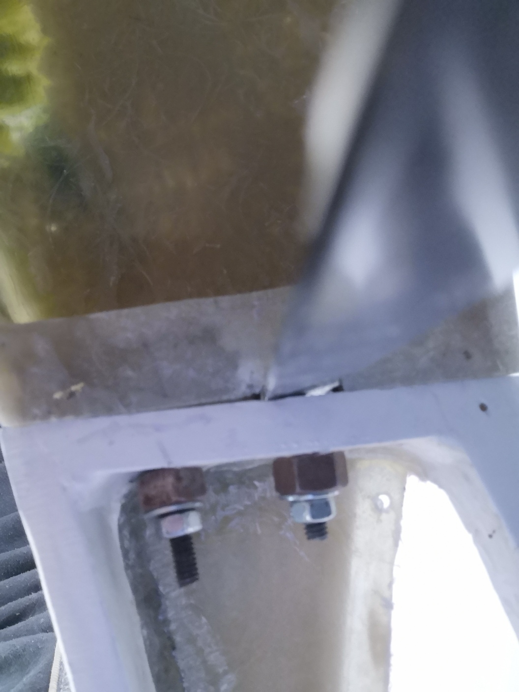

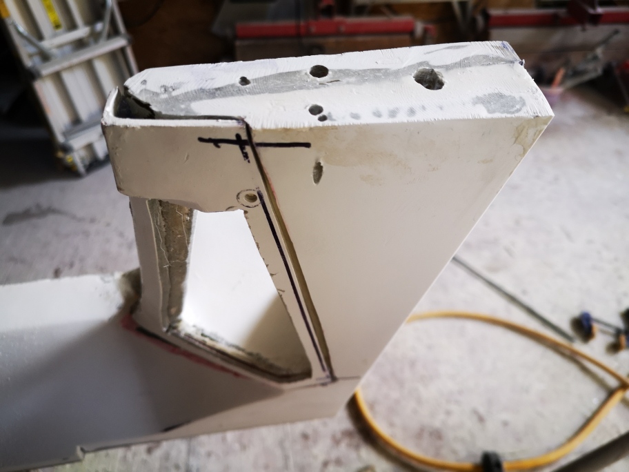

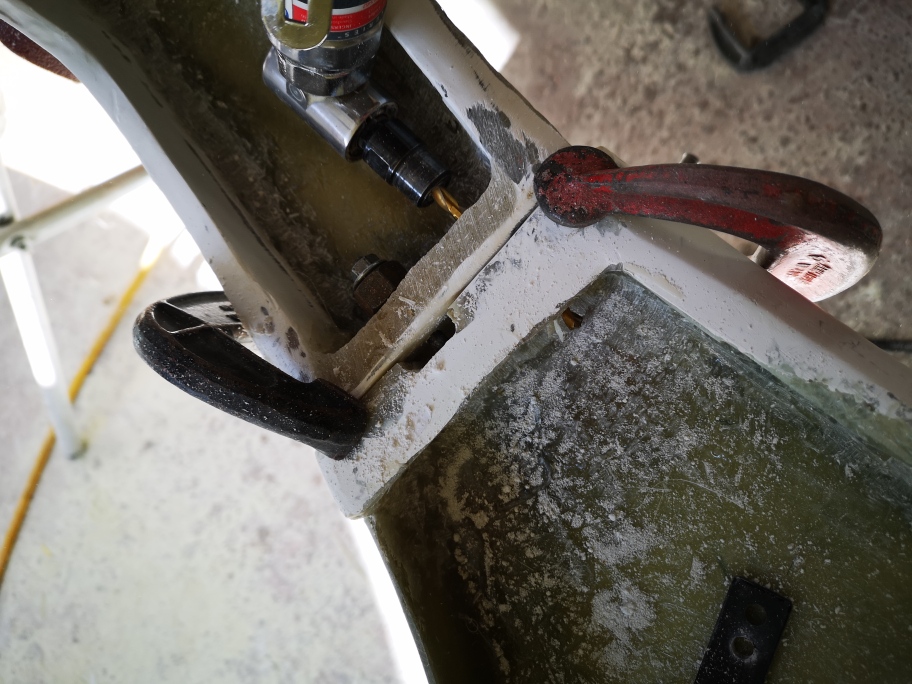

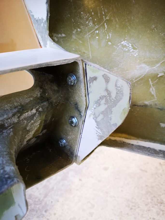

Then it was onto mounting the running board/fender onto the fender. The important reference is the back of both pieces are parallel.
Then drilling through the two , the bar is one of the standoff’s holding the two in place.

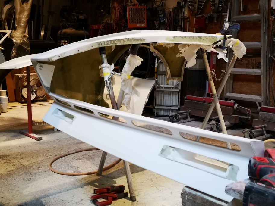

Next cutting out the vent area from wheel well , there is a wire screen to fill the hole.
Then mounting everything onto the front end

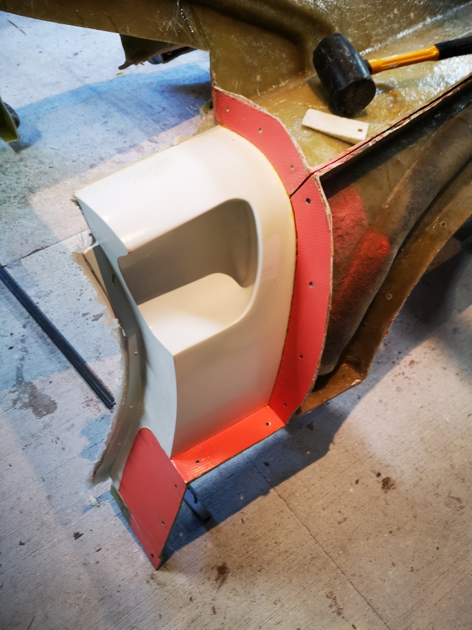

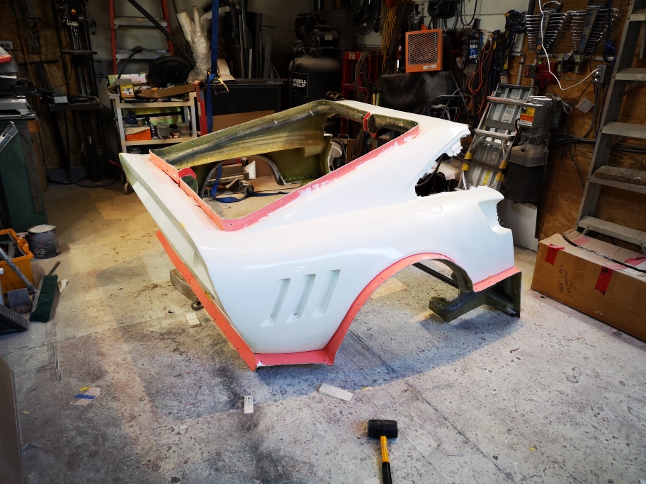

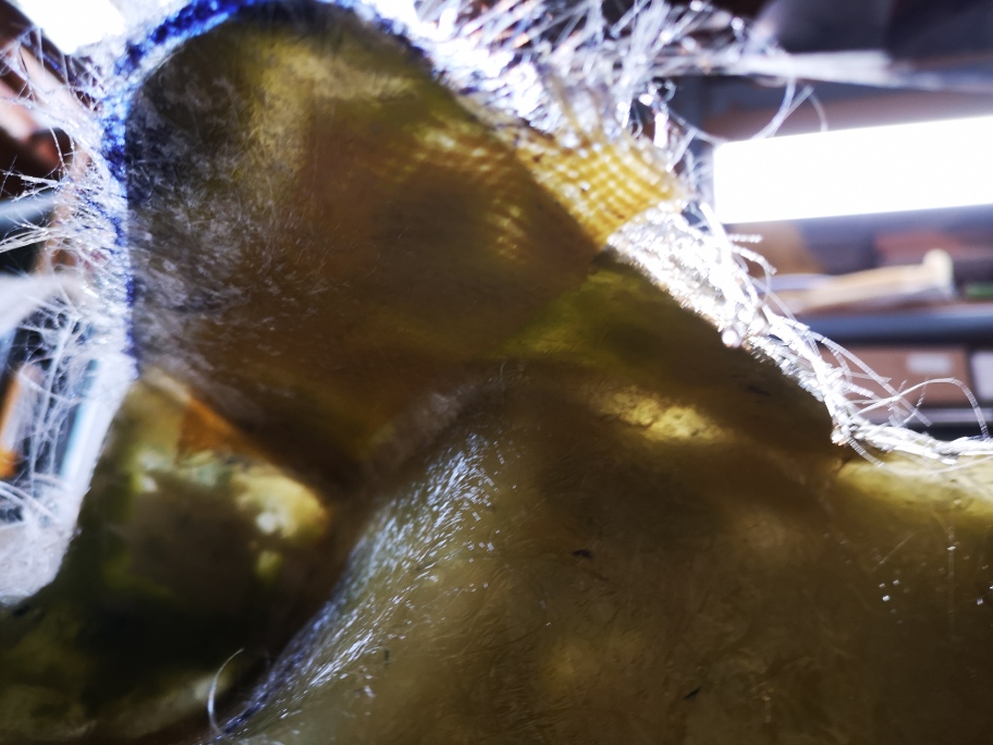

I pulled the the back half of the car out of the mold yesterday.
Cleaned it up today , I’m pretty happy
I hope to get the bodywork finished tomorrow and mounting it this weekend.

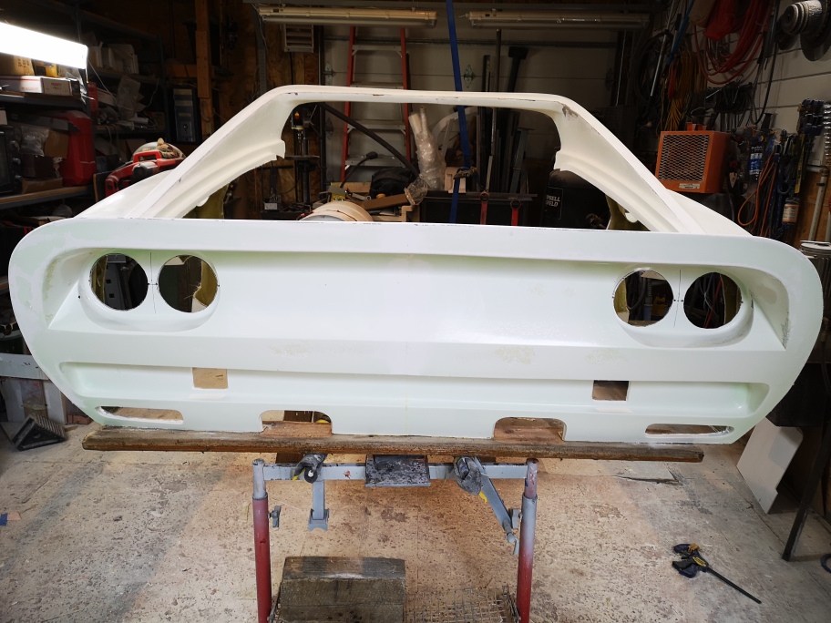

dobie1 MAR 27, 01:27 AM

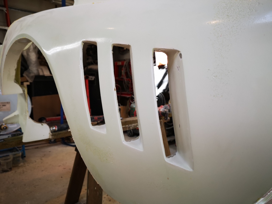

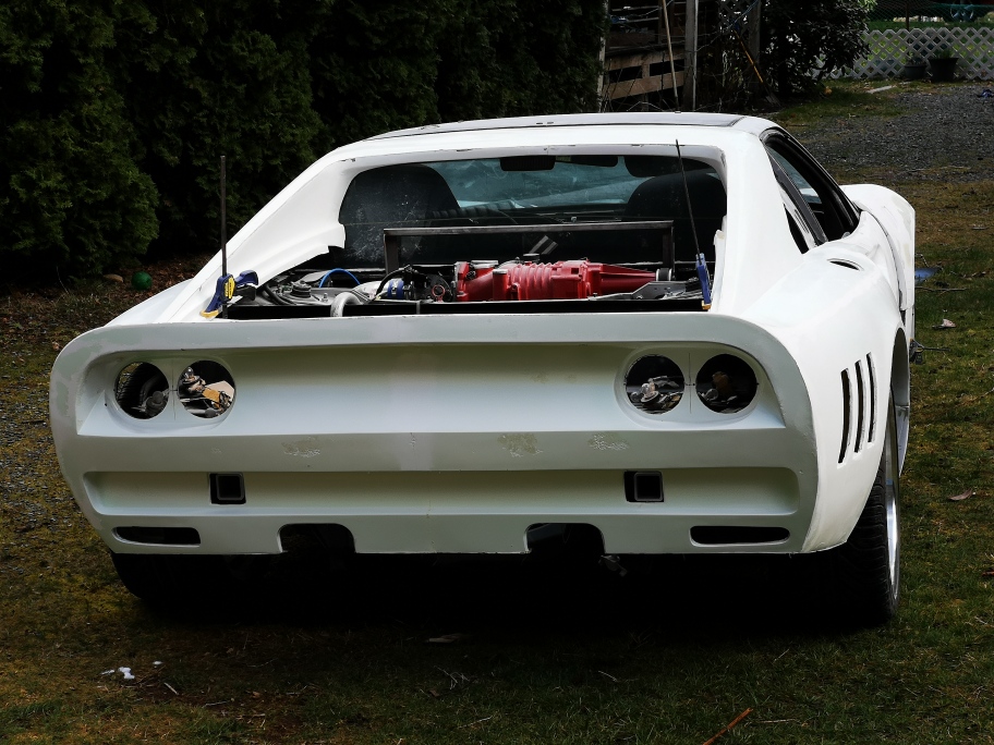

I finish preparing the rear clip for installation on the car, came out pretty well . I have calculated the new rear is only 1/3 the weight of the original.
That’s about 200 lbs savings 🎉

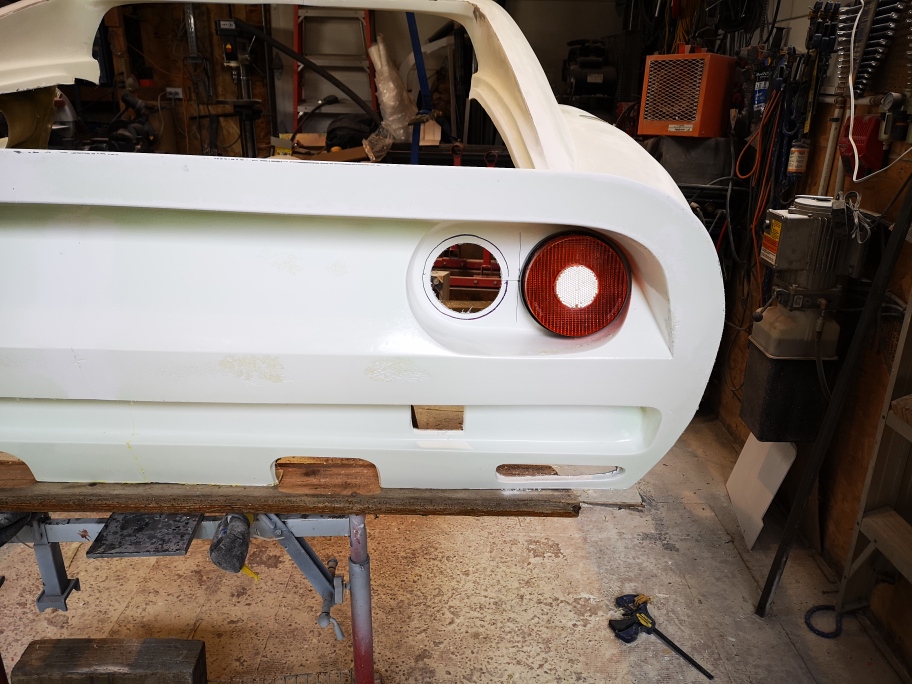

Test for one of the tail lights.

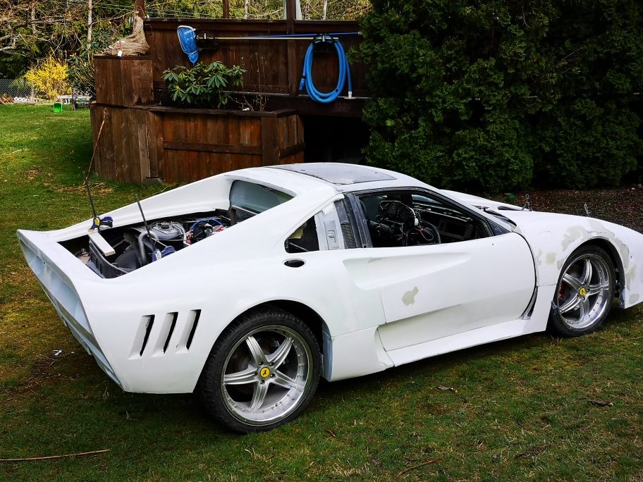

Don O. Came over today to give me a hand we got the rear clip installed today.!!
We pulled the car out of the portable garage and blew out a years worth of fiberglass dust from the shop. Moved the lift back into the main shop which now gives me the portable garage to do the spray painting of the panels it’s coming together really well.
I still need lots of finishing and alignment but it gives you the idea.
