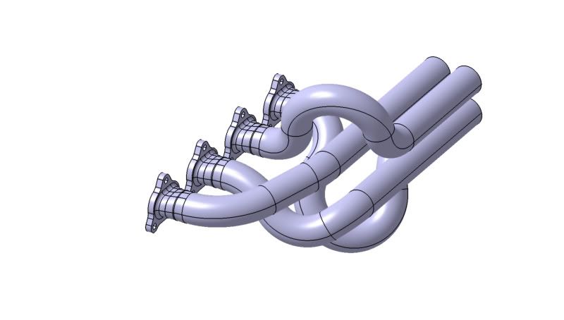

Thanks for the info Toddster, I will try to get ahold of him. I finished the second header design today, it's about 4 inches longer than the first but places the turbo in a more ideal location.
A wolf in sheep's clothing, no doubt:
That's a look under the skin of the last picture.

I'm pretty sure it's done...Length from head flange to collector is 19". Each runner is composed of 4 seperate bends, 3 welds required for each, plus the transition from oval to round.
I just realized something the other day when cleaning my garage out to make room for the Latemodel that has my new Super Duty in it. I have a set of IndyCar headers. And guess what? The flange and ports look amazingly like what your Cosworth head exhaust flanges look like. take a look and compare.
