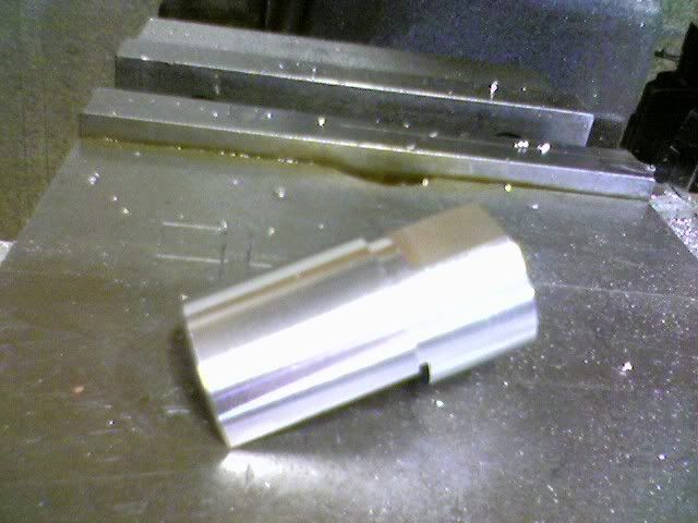

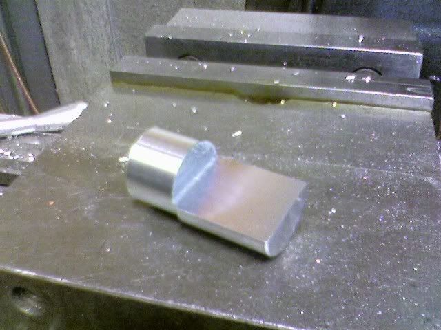

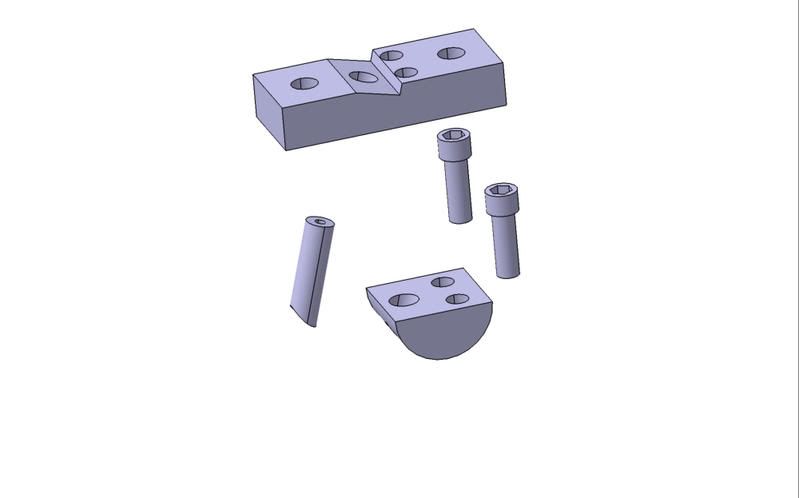

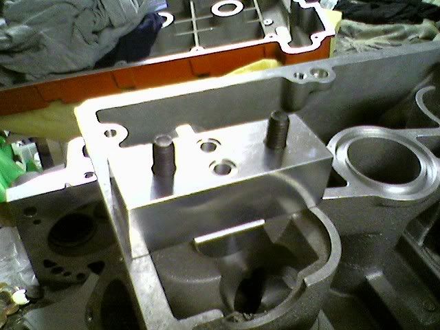

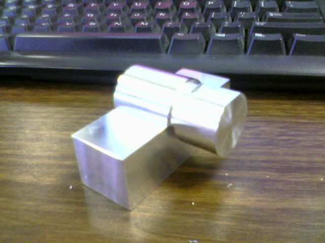

Here is a tool I've been making today for drilling the middle four cam bearing bosses. Apologies for the crappy cell pics.

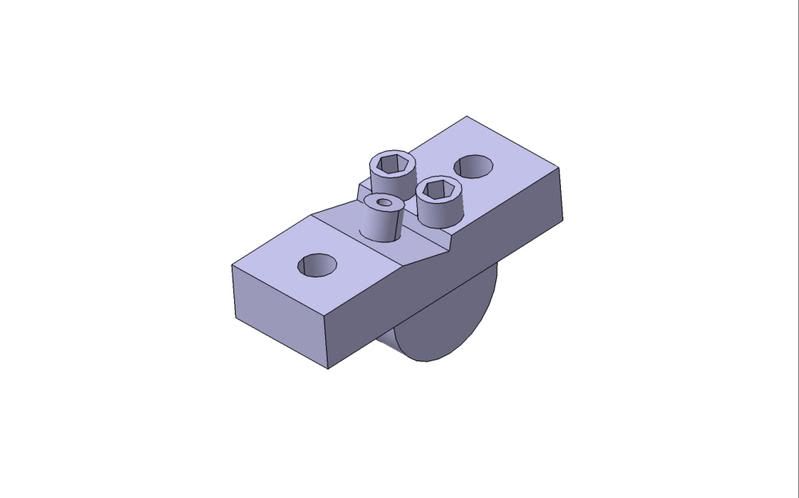

Here's what it's supposed to look like when finished:
Looks more complicated than it actually is, I've only spent about 20 minutes on it so far. First I turned down some aluminum stock to camshaft size, put it on the mill and cut an orientation flat, then milled down another flat to the centerline. I then squared another little bit of scrap. Tomorrow, it's going to have an angled flat milled into it, and drilled for .25" cap screws to hold it to the cam bushing. Once the cam bushing is drilled and tapped, they will be assembled, and the nub for handling the cam bush will be cut off and the assembly milled flat on both sides. The assembly will go back into the mill, and the angled hole will be drilled in, then lined with a steel bushing. The whole unit will then simply bolt in place of the camshaft bearing cap.
Elapsed time...Hopefully not more than 1hr.
Mr.PBody FEB 13, 08:07 PM
Why don't you just machine up your own motor your skills are intense man, nice work,

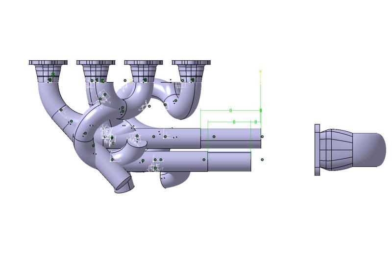

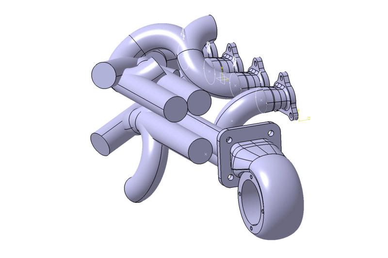

Started on header design number.......whatever
[This message has been edited by FastIndyFiero (edited 02-14-2008).]
Fastback 86 FEB 14, 03:46 PM
Ummm.......I think this project is starting to get to you Nate. That cluster**** you got there is gonna be a ***** to build, and I'd love to know where some of those pipes are going.

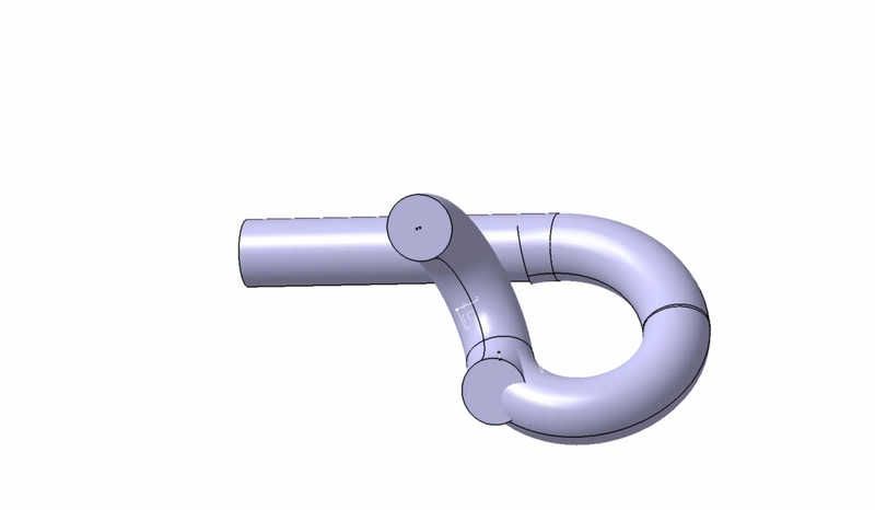

FastIndyFiero FEB 14, 04:14 PM

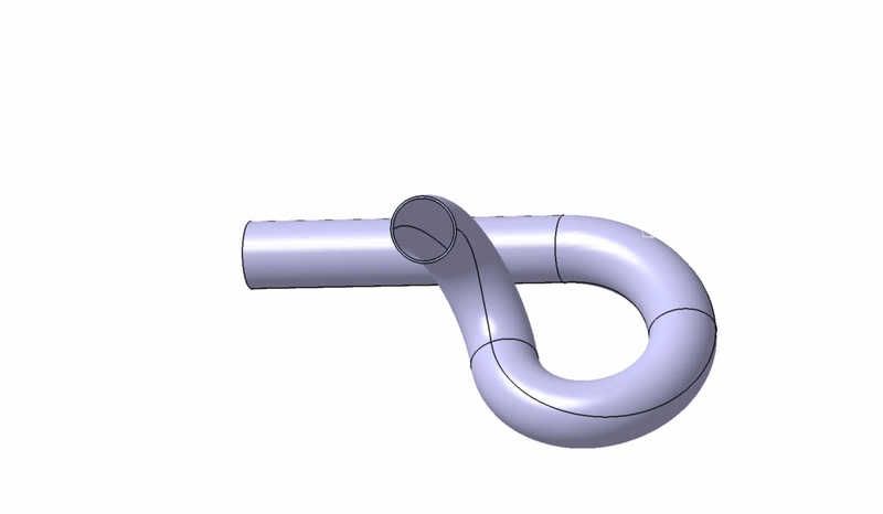

Tube 1:
And from the jumbled mess...
FastIndyFiero FEB 18, 12:39 AM
LOL...Scott, you were pretty much right. I would show you guys the rest of the "trimmed" header if it didn't look like crap, and if it wasn't wrong.

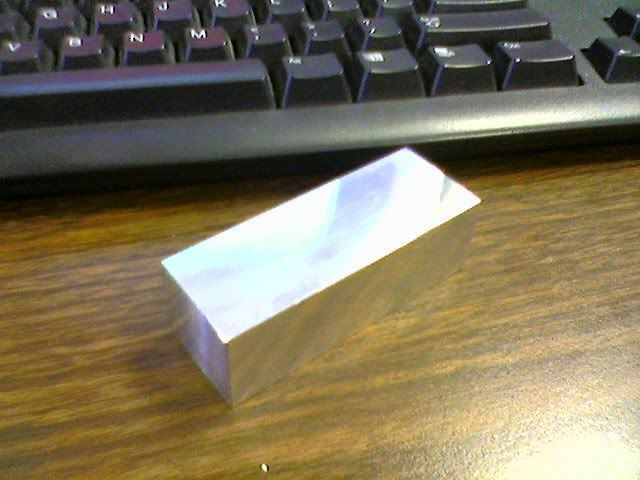

So here's something positive:
Almost done. Hopefully I'll be bored at work again tomorrow.
