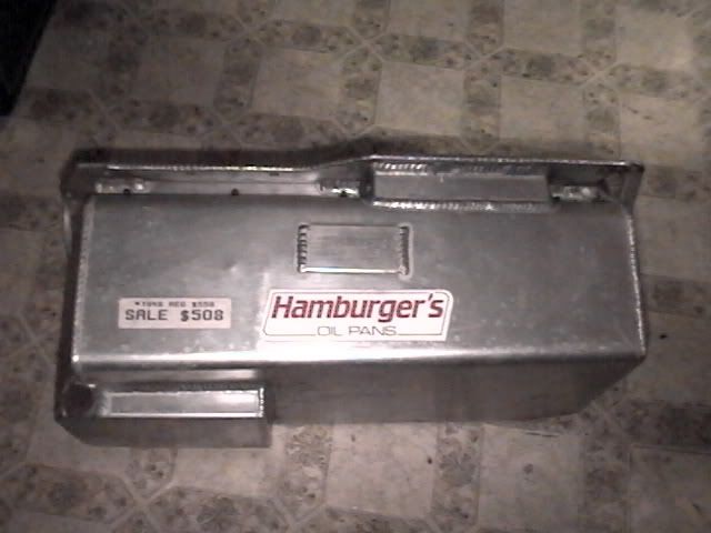

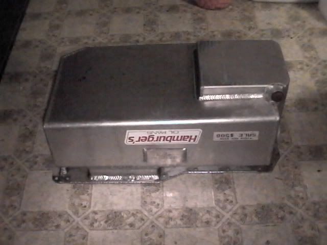

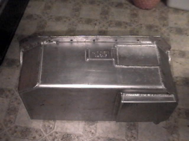

Ah!! you need an Oil pan. You should get one like this. I will need to have it modified to use the stock motor mount bracket but that shouldn't be hard. I wonder how many quarts it holds. I also have the one that came on my IMSA which looks like a stock oil pan with the sump modified and two tubes for the drain down from the intake. BTW I in no way paid anywhere near that $508 price tag you see on the pan.

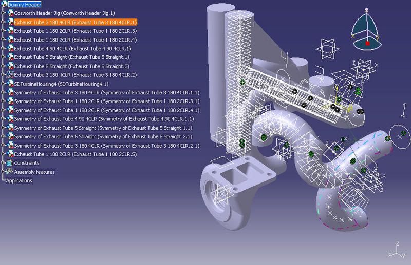

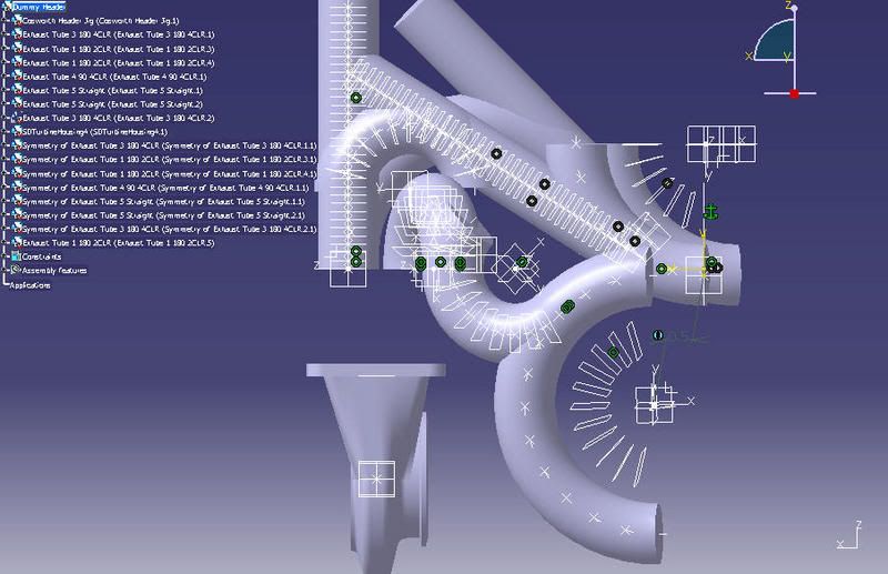

Right now it's REALLY messy, and isn't the configuration I want, but it's buildable.
RandomTask NOV 15, 08:31 AM

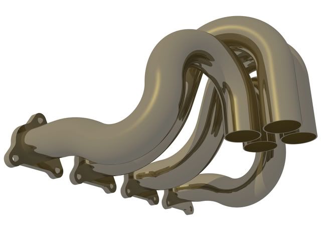

just some quick tips on your exhaust, route them into the collector in correspondence with the firing order. By this, I mean, have the first cylinder that fires, next to the 2nd. Have the 2nd next to the 3rd, the 3rd next to the 4th, and the 4th next to the first. With this, it keeps a velocity (less turbulence) in your exhaust, increasing the scavanger effect. May not seem like much, but i've seen 5hp gains in 105 hp 600cc engines by ONLY doing this.
FastIndyFiero DEC 02, 09:41 PM
My turbo uses a divided turbine housing, so cylinder pairs 1-4 and 2-3 will be seperated from each other. This also means that the turbo C/L will be running fore/aft, so I might need to "clearance" the front firewall a bit. Or I may still design one that puts the turbo C/L running transverse. Don't know yet. That involves physical mockup that I need to do...

I'm pretty sure it's done...Length from head flange to collector is 19". Each runner is composed of 4 seperate bends, 3 welds required for each, plus the transition from oval to round.
The_Stickman2 DEC 24, 09:40 PM
Why use 4 single flanges vs one large flange?
My sites
http://the-stickman.tripod.com
http://www.youtube.com/TheStickman
RandomTask DEC 28, 08:21 AM
You say tomato I say tomato. . . Just a different way, four flanges will actually give you a little more adjustability and less weight Also, when you build off one flange, you might hit some tolerance stack.
