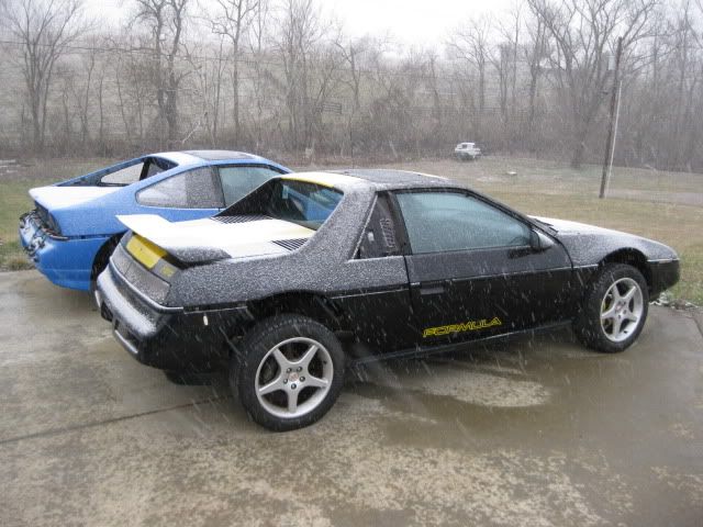

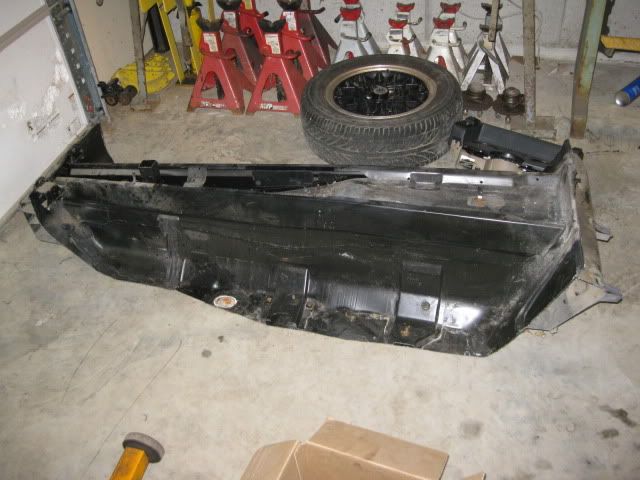

fieroguru JAN 13, 06:42 PM

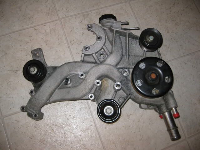

Yet another LS4 water pump showed up today (thanks ZombiePenguin!).

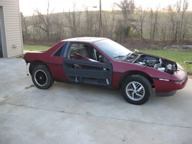

Been busy stripping down an 88 parts car to get back under my allowable # of personal fieros (2).
Started with this:
Ended with this:
Kept this for a fuel tank project:

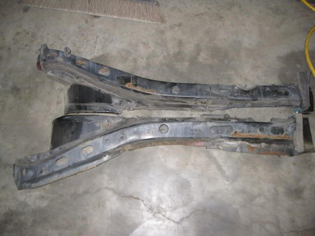

The rear frame rails were too good to scrap, so they were given to another PFFer:
I also gave away the 4.3/F40 engine/tranny/tubular cradle to get more shop space and 1 less distraction.

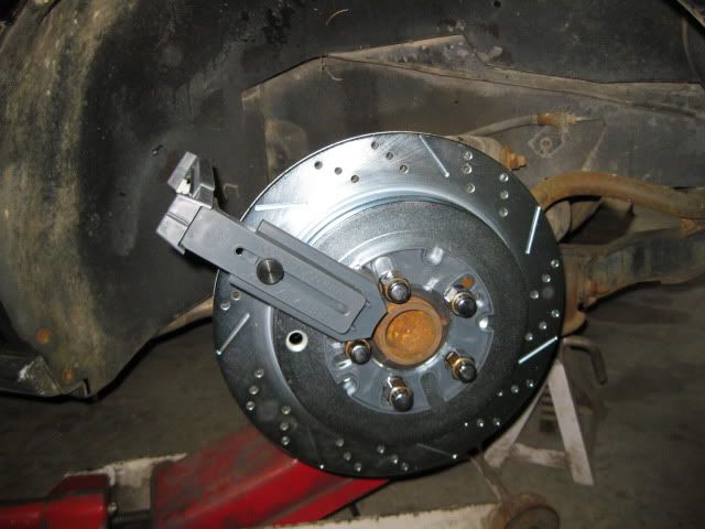

After this weekend, I should be done with all the fabrication getting the hardware for first 25 brake kits done, which has been a significant time drain for the past several weeks.

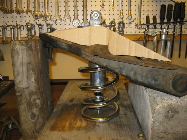

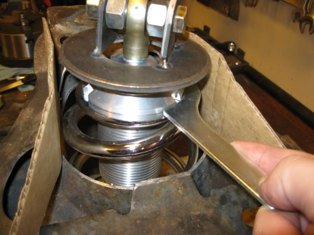

Got started on the adjustable front coilover project:
http://www.fiero.nl/forum/Forum2/HTML/120718.html

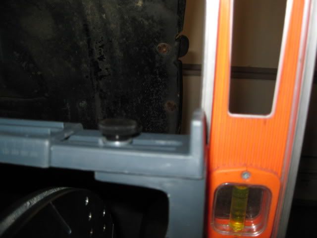

Wheel fitment verification for some 17 x 8.5's on front and 18 x 10.5's on rear:
http://www.fiero.nl/forum/Forum2/HTML/120740.html

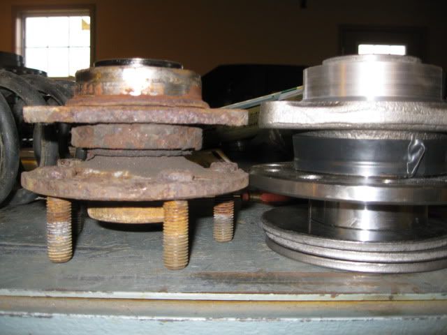

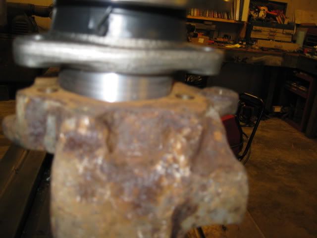

4 3/4" wheel bearing/bolt pattern upgrade:
http://www.fiero.nl/forum/Forum2/HTML/120747.html
