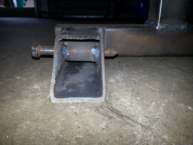

I would recommend capping the end tubes on your cradle to prevent dirt, bugs, road debris, water ect. from getting in there, and possibly causing a corrosion issue from the inside out.

| quote | Originally posted by ericjon262:
I would recommend capping the end tubes on your cradle to prevent dirt, bugs, road debris, water ect. from getting in there, and possibly causing a corrosion issue from the inside out. |
Indeed I will. The next time I fire up the welder I'll cap the ends as well as add the mounting point for the trailing arms. Then it's off for powdercoat.[This message has been edited by Lunatic (edited 07-21-2014).]

Just make sure you install sleeves where the cradle bolts pass through. That is the only way they will stay tight and not collapse the tube.

| quote | Originally posted by fieroguru:
Looking good!
Just make sure you install sleeves where the cradle bolts pass through. That is the only way they will stay tight and not collapse the tube. |
Nothing gets past you, does it Paul? Lol. I agree with this statement and I'm one step ahead of you. I've already done this. For those following this reply, here's what fieroguru is talking about.
